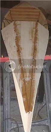

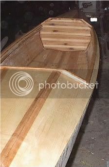

Got the front decks glued and sanded,stiched it up and tacked it.
Did some sanding and fitting to the deck.
wet it down for one more sanding
Later

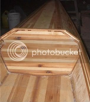

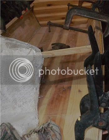

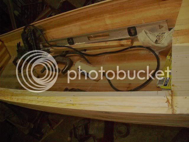

Started working on parts for the combing cut and glued them.
Started glassing the bottom of the decks.
This afternoon Darrel came by and gave his approval,

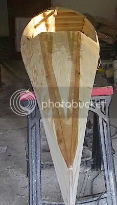

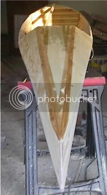

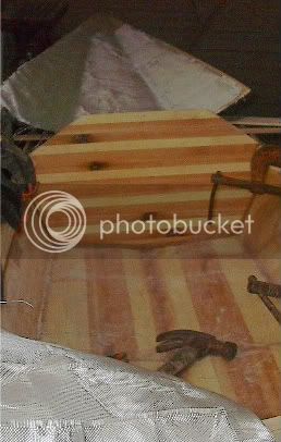

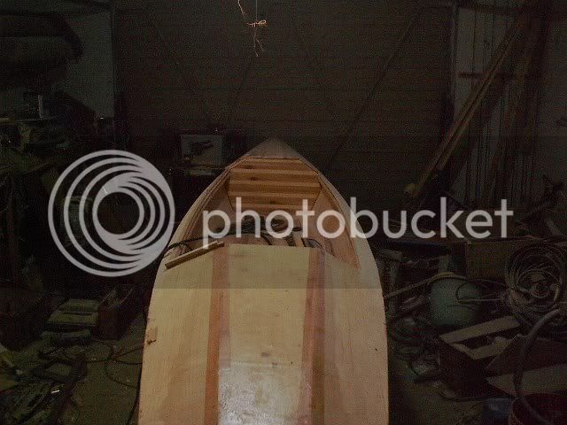

Made a little progress today, got the decks put on and filets run around them

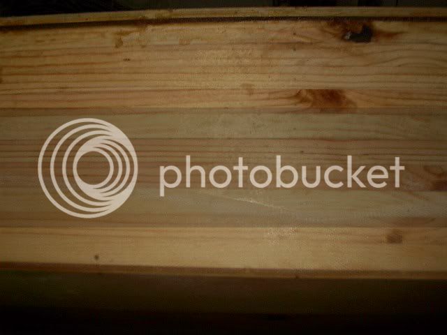

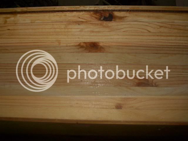

Then I stripped the area each side of the cockpit.
Sanded that down and then started building my coaming
It sure did change the looks when I finished stripping the decks.
I am really getting to like those flat topped decks , front and rear. Quit teasing us, Ron. Give us a pic of the WHOLE boat, or is that going to be a surprise? :)
By the way, how do you like working with the epoxy?
I am really not teasing ya,ll with the bad weather and rain here I am having to build in the garage so side shots are hard to take. I will get her outside in a few days.

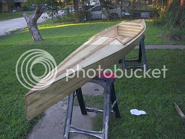

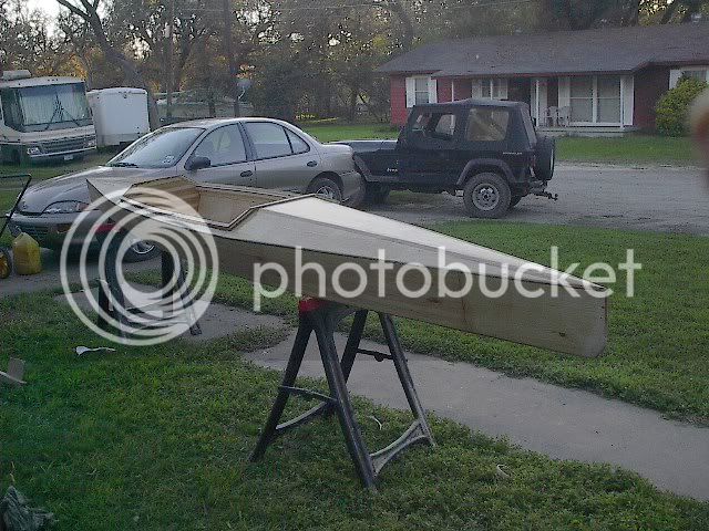

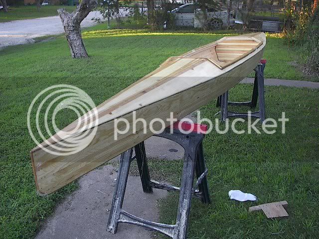

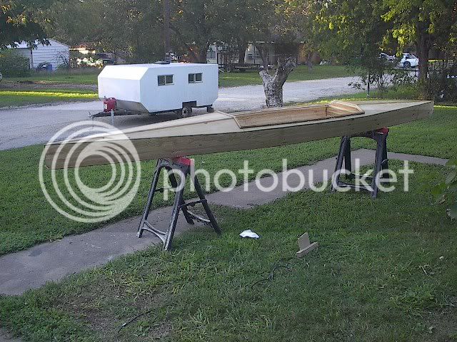

Well I got the duck out outside today so I could shot a couple pic . Now it is time to start putting a good finish on her.
from the front
from the rear
side view
I havent weighed her yet but from the feel of it I would say in the fourtys. about 44 we will see hom my scale arm works :D
Sonya did a god job mowing the grass , it looks really good. She is quite the Texas Gal , Bless her for taking care of things around the place while you get my boat ready. :D
Now stop fiddling around and get my boat done so I can come out there , drop it on my camper and get it back to Florida. The two of them are in this picture if anyone is wondering.
( Like that will ever happen , Great Job on your boat Ron , Ya have a winner )
See how well they fit together , then Ron can make his Ugly Duckling for his use. :lol: :lol: :lol:
PS. The rear sawhorse under my boat needs straightening , I would hate to see it fall .... NO .. The Boat not the sawhorse. :roll:
