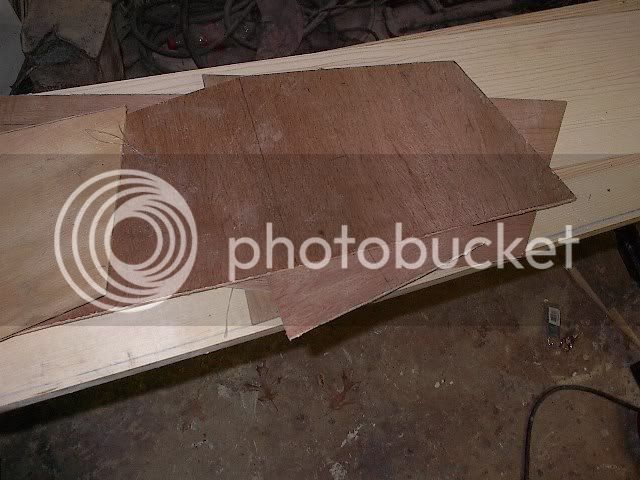

Had a pretty good day.cut all my stations
Got all the panels spliced

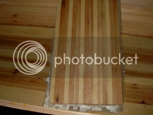

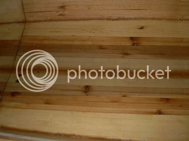

It sure is nice not to have to worry about sanding thru veneers on the ply. I put one coat of glass on a spot just to see what it was going to look like
I think it is going to wind up just about the colors I wanted,I like it so far.

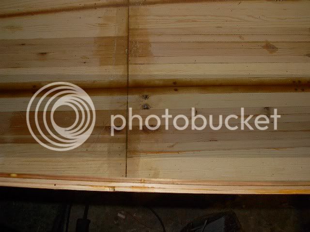

Since you are gluing up strips, why not make your panel full-length to start with instead of splicing the panels? I'd think the staggered joint would be stronger and it would certainly look nicer. Not criticizing, just curious........
I am way ahead of you :D The next boat I build will be full length strips no staples
Got it worked out in my head.
I wanted to build this boat from standard plans just to see if it would work since good ply is getting harder to find and the marine ply is so expensive
As far as looks go I sort of like the way the splice looks and tthat is why I leave a lot of knots that most folks discard. I want folks to see what I have done :D If you dont like the splice use the graphite on the sides and bottom and they will be covered.

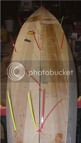

Shes looking like a boat now.
This boat is narrow and long hope I am good enough to handle her.

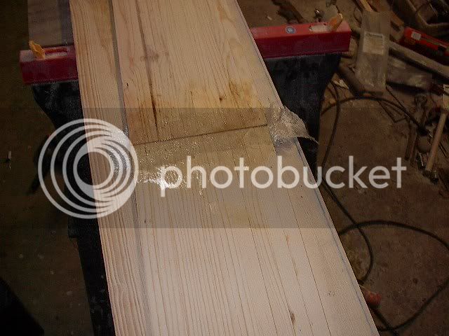

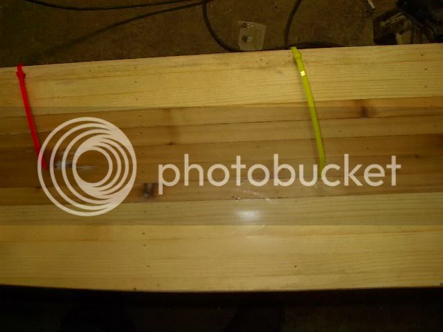

The only problem I had was one panel was laying in the sun and started to bow ,but a little red neck engineering worked that out
So far I am realy pleased with the panels,makes good straight edges,stiffer than ply so was easier to handle stitching,no worries with sanding thru the verniers. The panels took the bowing and twisting with no problems and I haven't put any glass on them.
I like one more stitch in the nose and then I will start tacking her out.
I bought tite bond 111 when I started this boat in Waco. well I ran out so I tried some pro bond ,and some tite bond 11 the tite bond 111 is much better glue. and the holding strength is better.

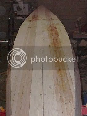

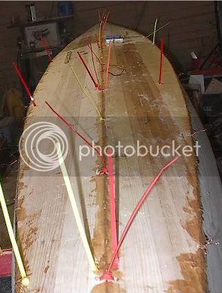

Got some more done to the duck today ,bottom tacked out
then pulled the stiches and finished the bottom filets and flip her over
Looks fast and long and lean ,we will see.

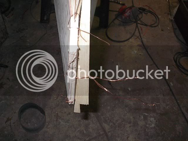

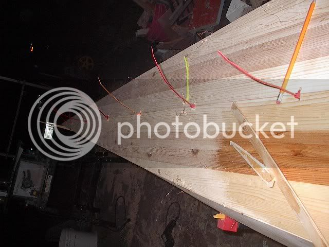

Well folks,I think this is going to be a winner,building the panels with the curve in them gives you a machined edge to mate up to ,I have never had a boat stitch up so easily.
As you can see in the pic the boat had more twist than I though,I dont think thats a problem with the twist. also I dropped one of the sides off the horse when I was stitching it together ,a ply panel would have broken ,this never missed a lick.
So far I havent found a thing I dont like about building one this way.

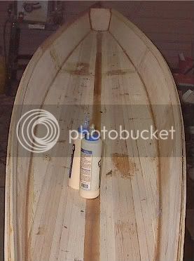

Had a pretty good day .
All the filets done.
Got the shear strips on the edges
Started laying out strip for bulkheads.
Thats it for today.

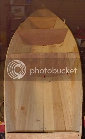

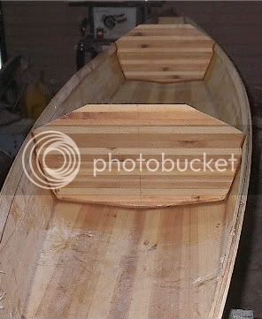

Got some more done on her today.
Bottom sanded and wet down then resanded.
Flipped it back over and installed the bulk heads.
I think it is going to be a good contrast
