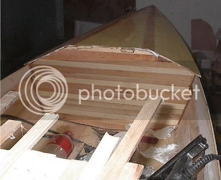

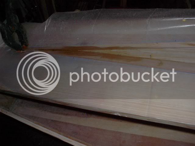

Got the back deck striped out and glued now I am ready to pull it off and do the back side.
Laid out the front deck and started stripping panels for it.
I ran out of strips will have to cut more tomorrow.
Belly so far I am happy with the process,it is a little more work in some ways but easier in others. I cant wait to get her finished and weigh the hull.

Ron, I think it's an interesting boat. Those slats will be more susceptible to being crushed in by rocks than plywood. You'll likely glass it the same inside and out as on plywood, but these will not have the cross-grain to help. Might well be lighter, though.
I think folks just want to see if it will float or is going to get a viking funeral :D
Jack I had the same fealings about the crushing but after working with it,I believe it will be stronger,it is much stiffer than the same thickness ply,and the glue lines work as a nondirectional brace. I will give it a work out and find out before long.
