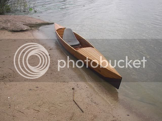

Maybe I need to go back and add this note, after building 15 boats ,Matts Northwind does it all for me ,camping , touring , fishing . It is the best boat for my all around needs.
The Ugly Duck is the fastest boat I own ,20 inches wide at the bottom and still plenty stable.
The good ole T_V over a thousand miles on her and the best boat I owned until I built the NW.

Folks on here know I am a speed freak or at least a ease of paddling one (effecincy).
After building 6 different perows with different angles. I can make this statement from experience, the boats you mentioned want paddle anywhere close to the same , in speed,ease of paddling . Now I am not talking numbers I am talking getting in the boat and paddling it with a gps..
The wetted area being pretty close comes from the flare just being very pronounce in the center area of the boat, sort of like a pregnant women :lol: but you have increased your beam in that location plus the smoother the water can slide around the hull the better it will paddle humps dont help that.
Seed the picture you posted tells it all ,they didnt put those tumble holmes on there for looks they were put on there because a wide flare boat doesnt paddle easily.
The paddling effeminacy goes way up the closer to the boat you paddle and parrellel with the boat. Having to reach out does several thing that are all wrong ,one it is a sweep which turns your boat on every stroke , the second it makes you arm paddle which tires you faster and has a much better chance at injuring yourself.
Go look at the racing perows they have down there they have very little flare
This boat is 15 ft + 20 inches wide and at the time I weighed 220 and had over 200 lbs of gear in her, paddled down 7 miles and back up seven miles against a 3000 cu ft a sec flow. There were nine boats and she was leading the pack most of the time.
So dont think a boat with very little flare want pack weight ,.
