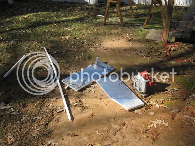

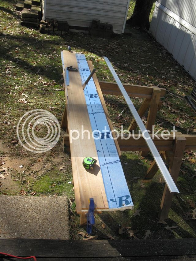

Cutting Styrofoam:
Don't = circler saw unsupported.
Works = pull saw with straight edge board for a guide.
Electric saw could work, but needs more rigging than the simple hand saw.

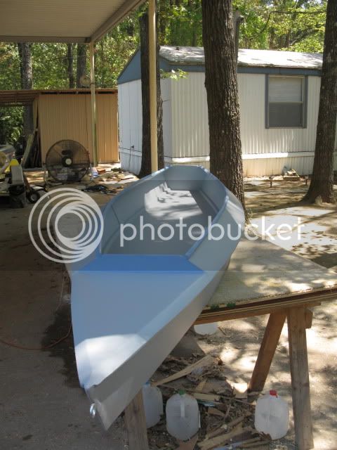

Looking forward to build another boat in 2012. Not sure where to start, but will take a look back at my goals, and how they may have changed. Also looking at things I have learned, and "what works/what don't" from my past builds. None were disapointing but, none completly met all the goals I had in mind, or they could have been built better. That is a not a bad thing, because I get to keep trying.
A boat build does not have to meet any goals. It can be built just because you like it and want too. That boat for me will be a lapstrake one day. I like the way they look.
My last boat is a great fishing boat.
After using it, if I were to do it over I would address the turbulance issue caused by it having a square transom. I would give up it's perfect fit in my truck and add two feet to the floor and give it a pointed stern.
What would you like to build in 2012 and why?
What would you change, or improve about your boat?
The goal that I have set is extremely critical, IT HAS TO FLOAT!

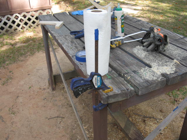

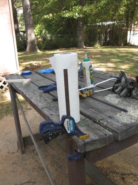

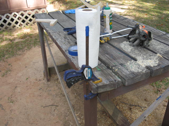

I use a lot of Irwin Quick Grip clamps. They have sharp corners on the ends and will cut or bruise if you walk into them.
A couple of wraps of tape over the ends eliminates the cuts and may reduce any bruising.
