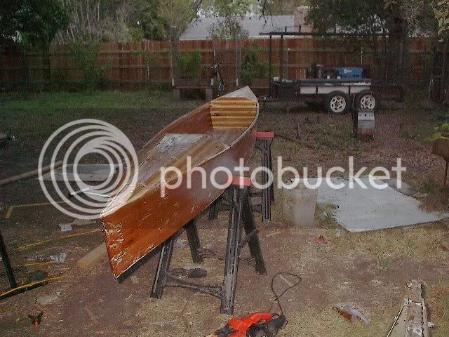

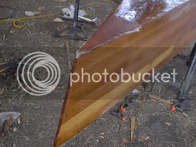

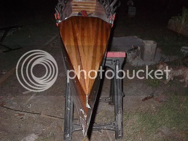

Got the decks rough cut to shape pulled off sanded and the back side glassed
Put a second coat on the bottom she will be ready for the sanding tomorrow and put extra wear strips on the bow and stern.
Should get an ideal how she will look tomorrow :D :D

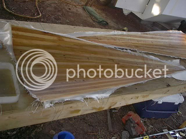

Re: Skinny perow coming

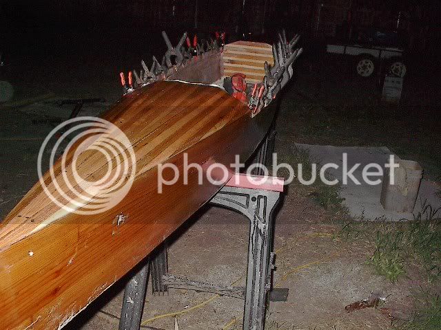

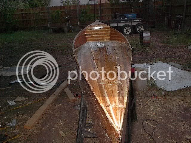

Got the decks glued down and all my filet ran . sanded them to shape
Tomorrow finish sanding and putting cloth on the decks.

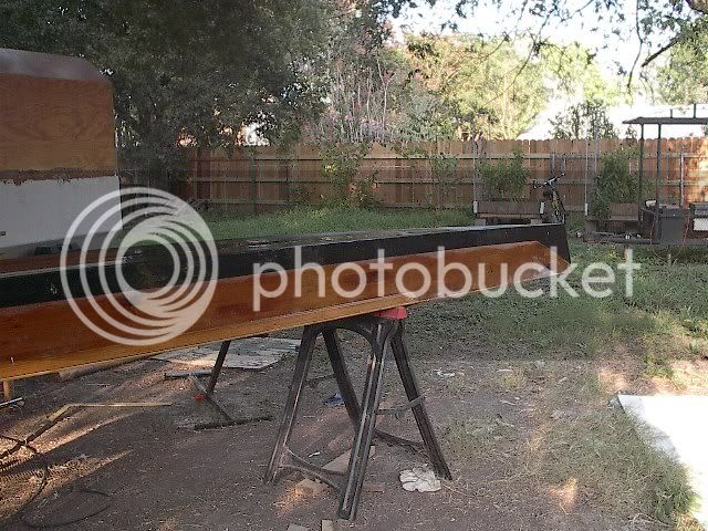

Between the rain and putting new wood floors in a house I let this slide for a few day,back on track now.
Got the decks sanded and glass put on them
Also glued on the outside rail
Got the cockpit sort of figured out now. I think I am going to wait on the seat arrangement until I have paddled her

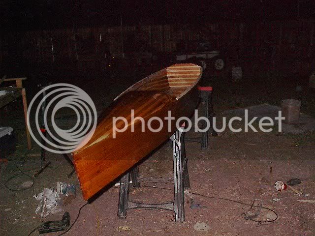

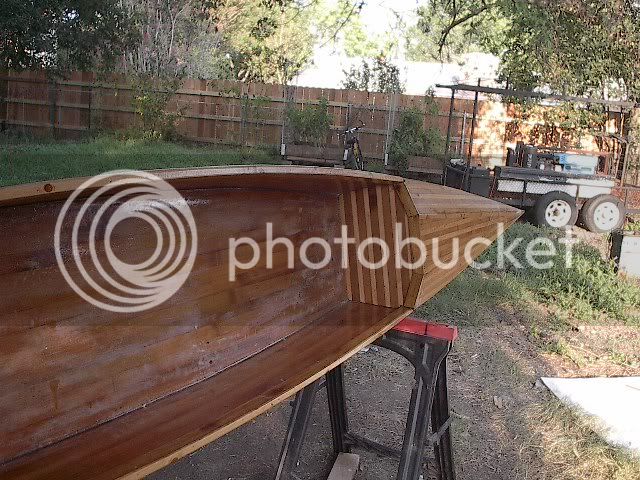

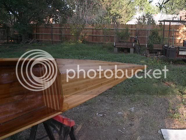

Got the last fill coat of epoxy on today.
I know the sides needed stifing so there are two strips inside the hul and one 1 1/2 ceders strip outside, the I took a piece of pine turned the gran at a right angle to the other strips for strength and also to carry the line of the light top.
It will darken a little when it get the epoxy on it.

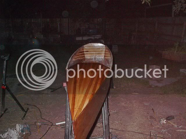

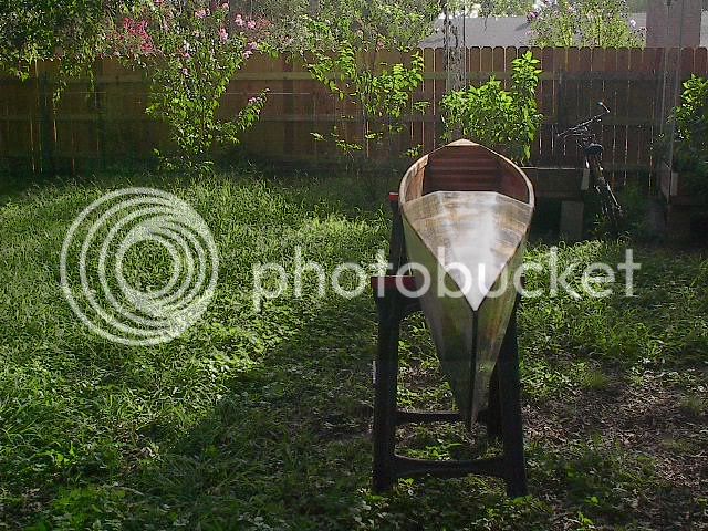

She will start to slick up after tomorrow.

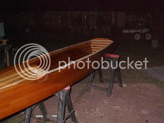

I got the side strips sanded and a coat of epoxy on them today, touched up some spots in the epoxy ,sanding starts tomorrow.

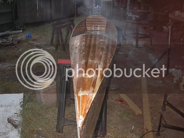

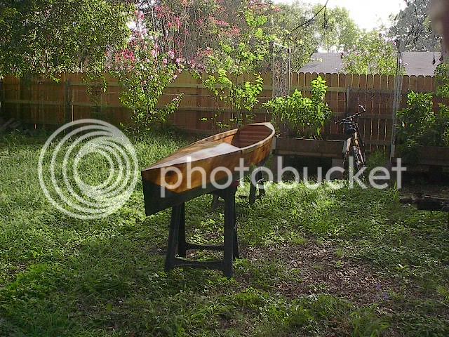

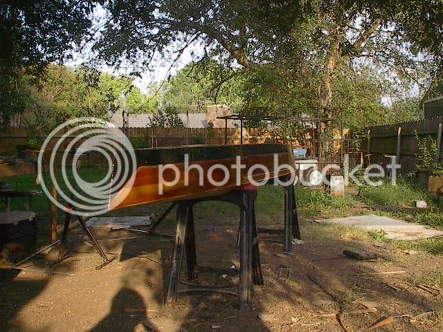

Got a lot of first done today, first coat of epoxy and graphite on the bottom
Installed the last wood on her ,the end caps at the back of the decks
got the first coat of spar varnish on the decks
She is slowly coming along.

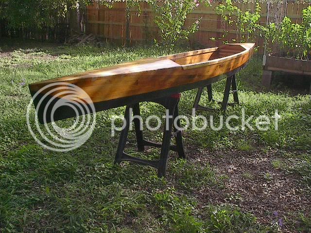

This is the slow part, sanding and getting the finish right.
She is getting there .
Trying to make up my mind if I want to go paddle her now are wait till I get finished with the hatches
