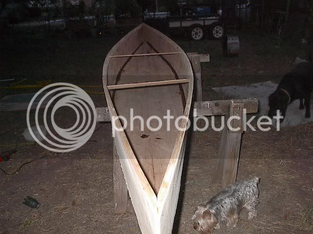

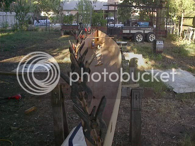

Got the front and rear bulkheads glued up

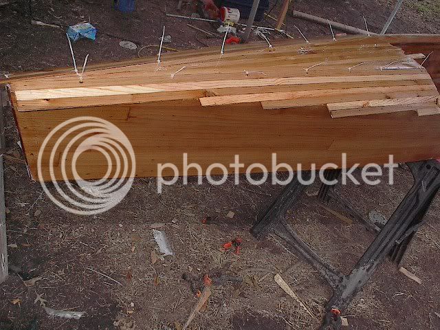

Started gluing the shear strips on.
I am going to be waiting on epoxy and cloth if it doesnt hurry up and come in.

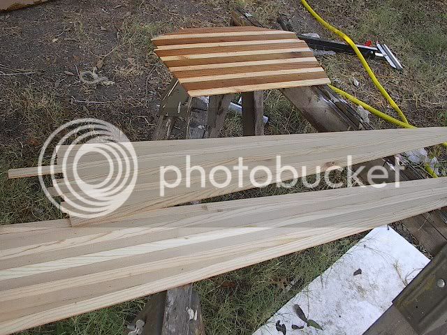

ookBack to the saw mill

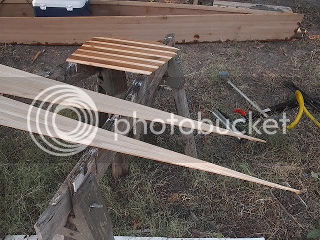

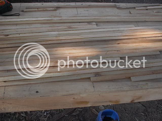

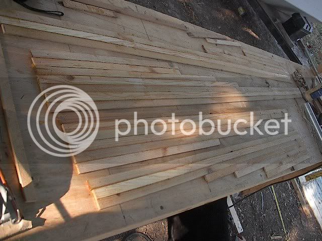

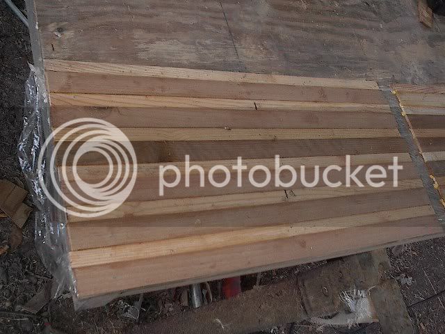

Top decks will be1/4+ 3/4 white pine and wrc
Strips laid out and glued
Top of decks sanded

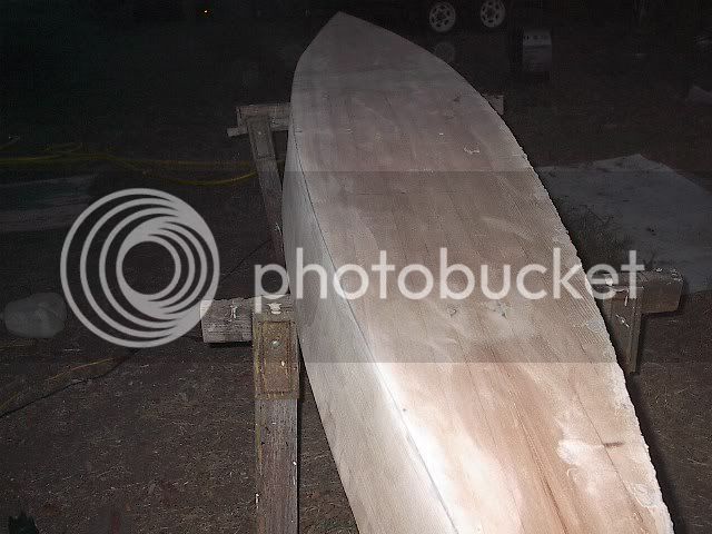

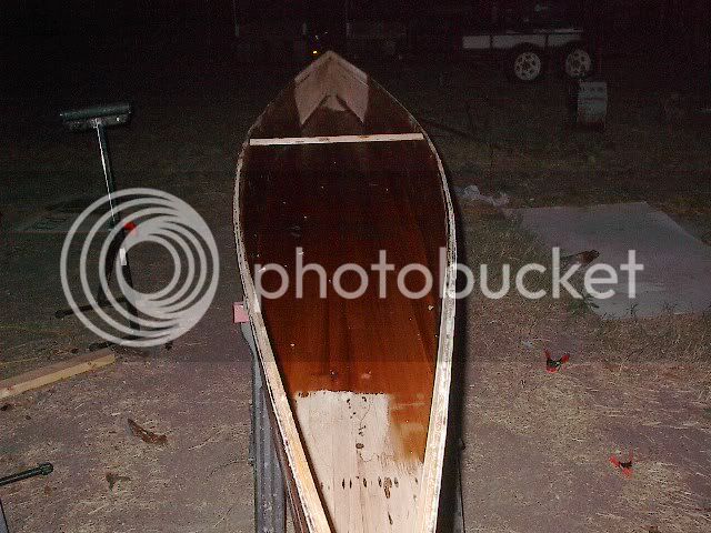

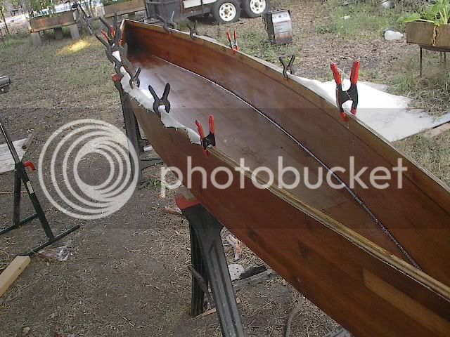

Got the inside filets done

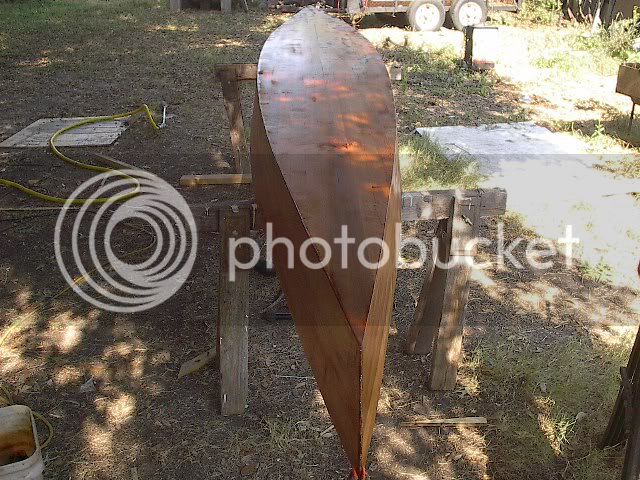

Then flipped her over and started sanding and shaping the edges,
Sicking up pretty good with a little luck saturation coat tomorrow.

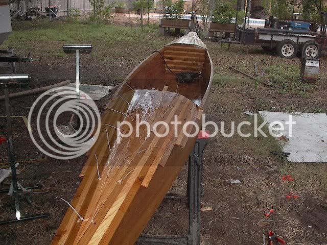

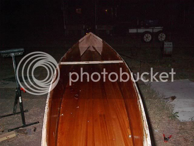

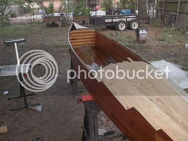

Had a pretty good day
all the cloth is laid, second coat of glass on the inside, bulkheads installed

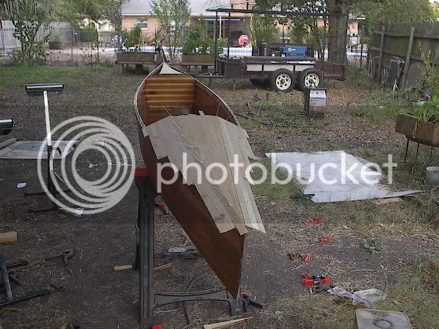

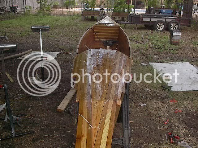

Started stitching up the decks
Going to look like a boat before long :D

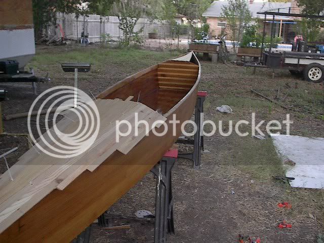

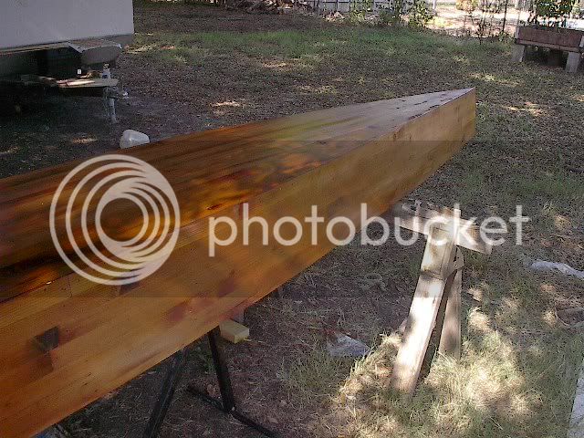

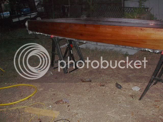

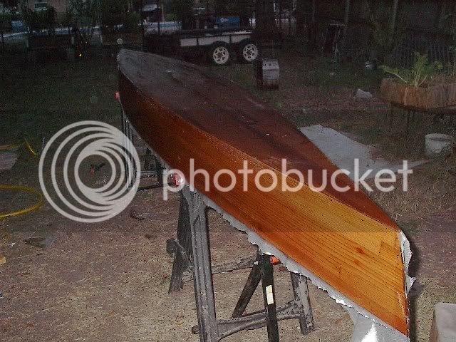

Been busy the last couple days and it has been raining so not much work done.

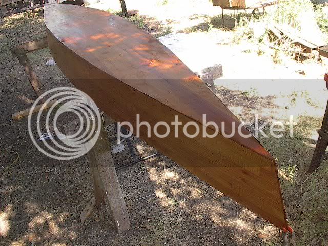

Did get the decks locked down and put a saturation coat on them.
The color turned out good on the decks I am liking the looks of this one,maybe Gerald want be to rough on me for not doing a good job on his design. :lol: :lol:
She is getting long and lean now.
