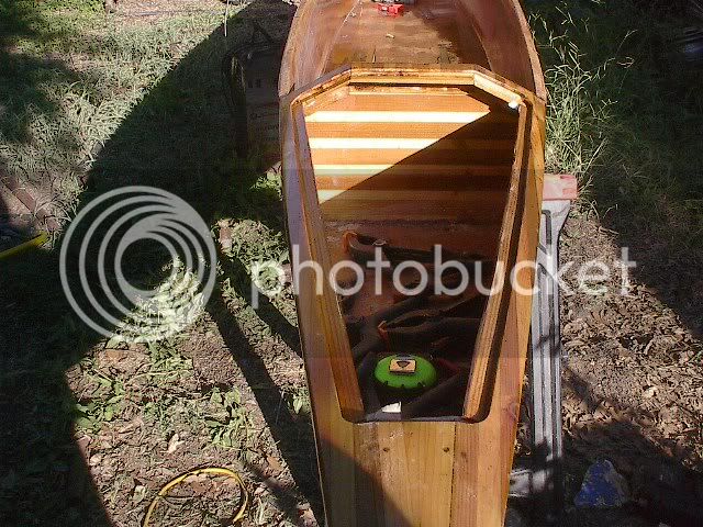

Ron, looking good. It doesn't look like you left yourself a lot of room for hatch bungee hardware. Looks like it's gonna be a close fit. I thought about a extra large front hatch cover like that so, in a pinch, I could take it off and step into the front compartment to get out over the bow.
Those compartments are going to be cinch to load. Might be a little harder to seal water out.
JD

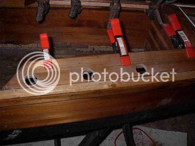

I am putting the lips in the hatch openings like most of my boats and it will have a rubber weather seal around it ,so it should be pretty water tight, I am thinking of mounting my loops for the bunjis on the side instead of the top.

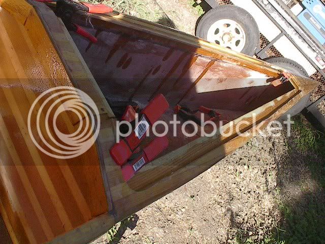

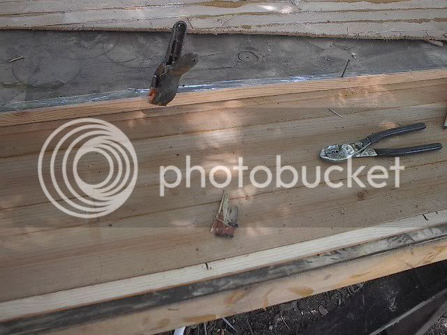

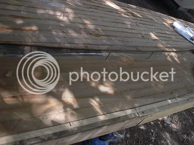

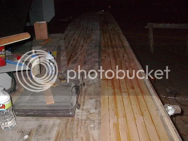

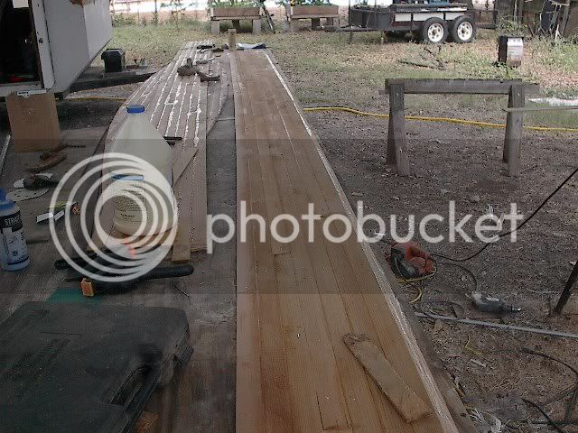

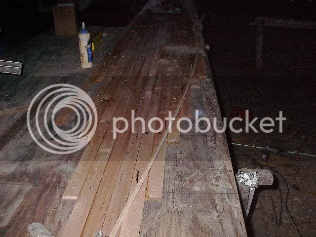

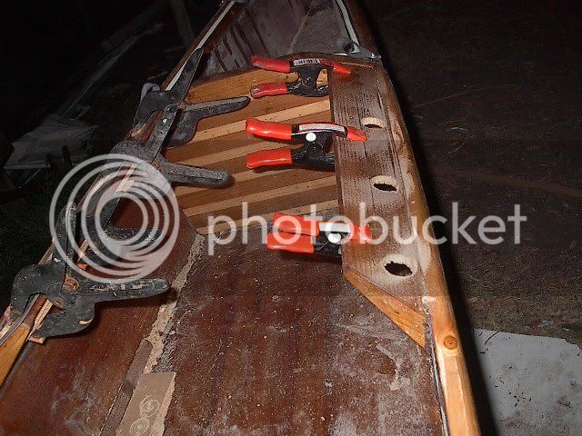

Been tied up for a few days, but got back to work on the hatches today ,all strips installed
trimmed and glassed.
Start putting hardware on tomorrow

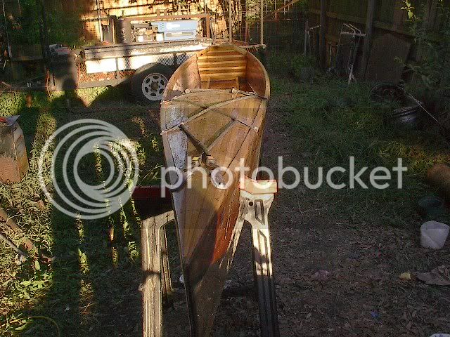

Got the hardware on the decks today. I sure do like the cords with the hooks on them ,they are easy to handle and you can change the length and configuration as needed for hauling gear.
I still need to install the gaskets but I think I am going fishing in her first.

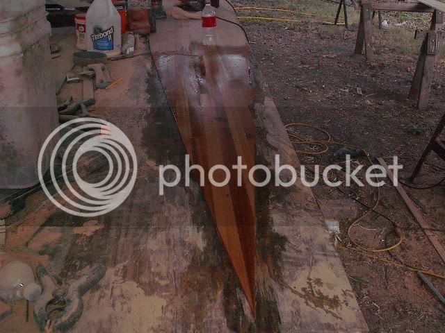

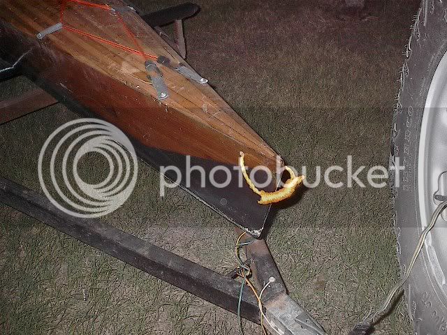

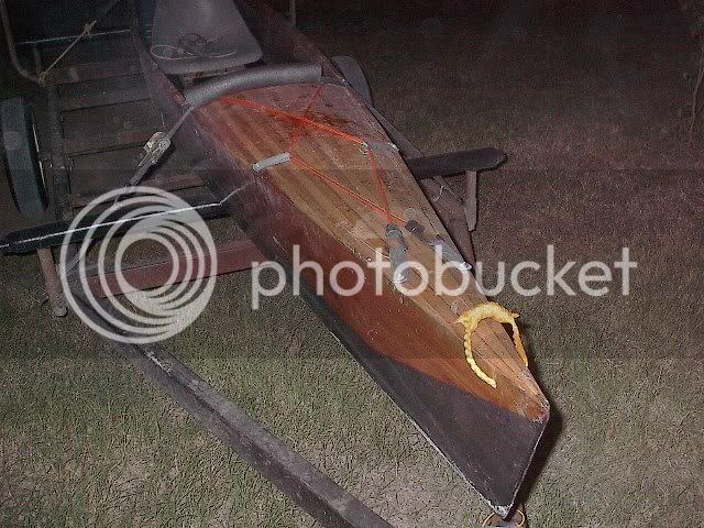

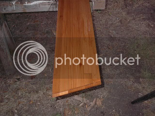

On the bow ( in the last picture ) you have a good shine on her since it looks like part of the top of the saw horse is a part of the boat. Anyway I sure hope it is nothing more the a reflection. :wink: :lol: If it isn't then you may have a little difficulty paddling her in shallow water.
The handles on the ends of the yak are very handy but I have problems with them hanging down in the water at times.
Today I put the handles on the criuser, instead of drilling a hole placing them right on the point I backed the holes up 4 inches . It leaves plent of hand clearance for carring.
But you have to push it down past the nose and it doesnt extend low enough to get in the water
I think it may solve that problem.

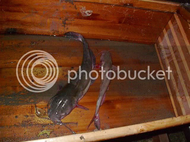

Took her out for the first fishing trip today,I just went for a couple hours but slimed the Cruiser .
I paddled her about 5 miles today on a lake ,she will just sit up there and cruise , I need to put her on the river now
I think she is going to be a dream to fish out of on the Brazos ,fast handle easy , and float shallow.
I am a happy camper
PS I will keep working on her till I get her completed ,but she is going to see some miles while I am doing it.
Fried catfish ----MMMMMmmmmm.

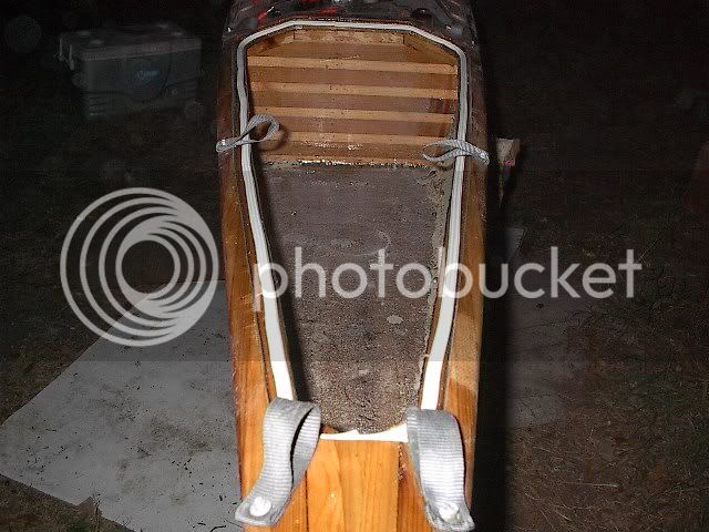

Got the rubber seals installed on the hatches

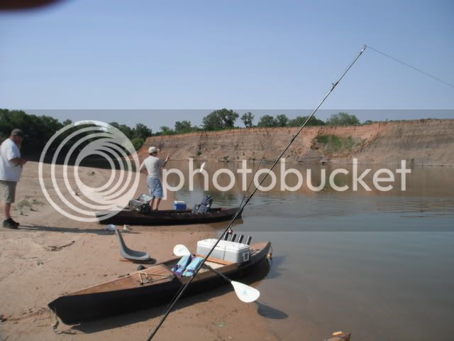

Been a while since I was out on the river ,well today Glen and his son and I went for a short fishing trip. It was Taylors first time in a yak and he had a ball ,we even caught a few fish.
I was in the Cruiser and she did just what she was designed for a great day boat ,fast sweet paddling and a pleasure to spend a afternoon in.
Taylor with his first fish of the day air borne
father and son ready to launch
