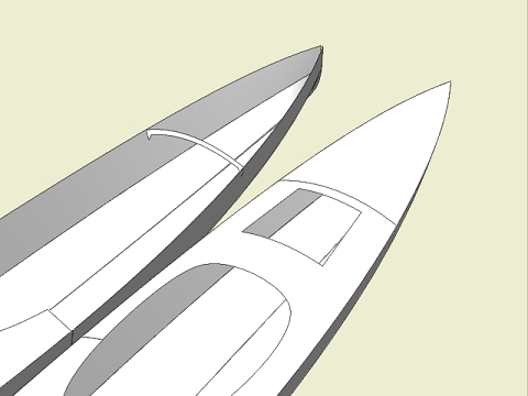

OK got a question about a hatch frame.
The hatches are going to need a little support, especially the aft hatch because it's big.
I was going to specify 2 layers laminated together that match the curve of the deck. Height 1".
My question: Does anyone thing having that frame will hinder the function of the hatch or make it harden to pull things in and out since that frame will hang down like a lip/edge?
The image below is of the kayak aft. One shown with the deck removed and one with the deck on. I'm hoping this gives a good visual.
My thinking is it could get in the way it that back end was really stuffed full. But then I think that it's only an inch and the back would have to be pretty freaking full for that to get in the way.
Matt, I agree.......an inch isn't a big deal. Besides, homebuilders modify things. In this case if an inch will be a proble, someone will make it one-half inch and twice as wide....
I'll probably not cut hatches in at all, but just make the seat flip down so i can find my sandwich.....
Lookin' good.
Piper
Hi Matt,
I don't think it will be a problem. However, wouldn't the hatch way opening lip consist of several layers of laminated ply epoxied to the deck? If this is the case, wouldn't those laminations sufficiently re-inforce the deck on their own.
A curved deck will be much stronger than a flat one anyway and say 3 extra laminations of 4mm ply, 20mm wide, around the outside of the hatch opening make it at least as strong as a similar set up on a fibre glass kayak. The deck is not meant to carry much (if any) weight, just keep the water out.IMHO
Matt.......how about a strip of glass tape or two in the way of the brace position. Perhaps a strip of carbon-fiber would stiffen it up with virtually no increase in weight or thichness. Having now carbon-fiber in stock here, I'd probably use a strip or two of 4" wide tape, epoxied to the inside.

That might work too. I think I have another trick that will do the same as well.
