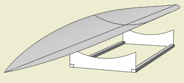

The deck assembly is a little tricky. I have a friend who built a few CLC boats and a few Pygmy boats and one of mine. The challenge with the rounded deck using the CLC method is that you have to install it while the deck is wet with epoxy on the underside (no fiberglass...just an epoxy-cabosil mixture). That just doesn't sit well with me. I like to set up my designs so someone can work in small steps if they need to. I know that's how I need to work.
So what I doing is drawing up a simple cradle jig where you glass the deck underside. I think it'll work out pretty cool. I'll try and post some sketches and let you guys tell me what you think.

For coating the deck underside with fiberglass, I figured a simple to make jig will do the trick.
Just stitch the hull top (up-side-down) to the jig and glass the underside. Just glass right over the top of the stitch and then sand it out after cure. Fill the small hole in the fiberglass you sanded in with a little epoxy.
Then it'll hold the arced shape somewhat better, be easier to install, and will completely encapsulate the deck plywood.

alternate bending jig
Matt, how about if you strung wires across the beam, deck inverted, pulled them up tight as if there were several archery-type longbows ACROSS the boat......place one wire at 1/4 of length, two near the middle, and another at 1/4 in from the other end......just a few holes near the edge, nothing across the boat, then you could simply epoxy the inside, no glass, and pull the wires AFTER the deck was on the boat. Saves building another form, too. Worth a try?
carbon
Matt, instead of or used with the glass/epoxy, how about some carbon fiber ribbon accross the boats deck inside. It will take tension very well and will help hold the deck's shape better than glass alone. Also, very light weight. Easy to get at any model airplane shop or from the busier boat supply outfits.
Certainly an option.
In the plans I'll specify 3mm plywood for the deck with 6 ounce glass on each side. I'll do this to keep materials common as 6 ounce glass will be used for the entire boat.
But if a builder wants to try carbon fiber, more power to them.
