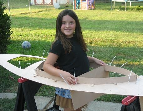

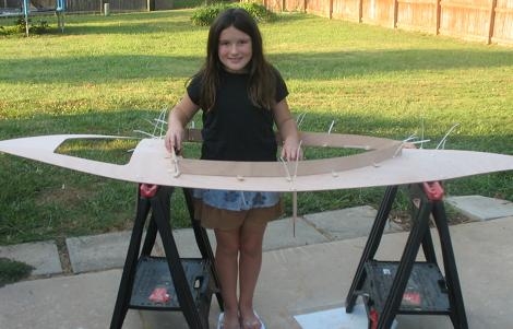

Here's a couple shots of my 8-year-old daughter with her deck.
Handsome little girl; good thing she looks like her Mommy.
Boat looks good too. If it gets a might tippy, try narrowing the bottom a bit so's the sides slope outwards not so steep. That'll help her displace more water as it leans over.
Oh, and you'd oughta put a bottom on that boat, Matt. Looks a little leaky as it is, ehh?
Nice job, Daddy. And GOOD on ya, Mate!

Her's won't be much more than a decked pirogue when you get down to it. I wanted some simple and stable. Looks like a little tugboat.
Poppa is proud as a peacock. I figured my 11 year-old son, who is a freakin Legos master builder, would be the one bitten by the boat building bug first. But it's my girl who pushed first. My son said "I want to see how hers handles then we can make mine". Talk about being the engineer....wants a prototype before committing to anything. :lol:
She is pushing. When we did some tack welding last night, she asks when it would be dry so we could do more. When I told her it wouldn't be until the next day she gave me that "that's unacceptable" look that her mother does so well. :roll:
