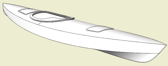

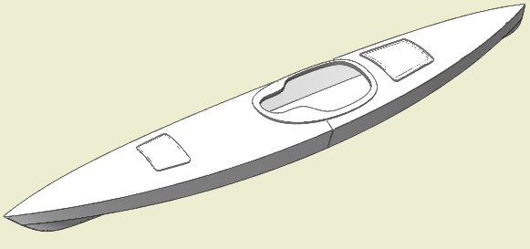

I saw this thread from the start and really like the boat,with all that has been said the slow guy that I am I have become confused.The last drawings shown show the keyhole cockpit.I was wondering if you are going to offer a more wide open deisgn of the cockpit. I guess what I am looking for is a Large opening for a Very Large guy to get into.If I missed it in the threads I offer my apologies.In the begining of the thread you showed a drawing of the cockpit I am looking for,and now it seems like the keyhole cockpit is what is being talked about.
Thanks
tioga
Here's where I'm at:
I've finished getting the panels laid out and set up the full-size patterns for the frames and cockpit coamings. The coaming will show 2 options: Keyhole, and the simpler oval-ish opening.
I will also do an open deck version like I first drew.
Everything will be in one drawing package so the builder can look at things and then decide which way they want to go.
There will be precut kit. I might offer a "frames, bulkheads, and cockpit" kit in addition to the full kit. I do this because the frames, bulkheads, and coaming should be made from 6mm for, what I feel, is the best results. Builder will have to be more specific about what they want with the kit.
I should have all the drawings complete this weekend. I'll have the BOM and assembly instruction to do after that. Those will take some time to do right.
But, I know several builders are anxious to get this one going so I might do a "presale" where builders can purchase the panel drawings and then I'll follow up with the assembly instructions when they are ready. I'd knock like $10 off the price or something. I haven't decided if I'll do that or not. Much will depend on how things shake out this weekend with the small version I'm building for my daughter.
I almost screwed things up royally on this drawing. I have the hatch lids orientated in the wrong direction. Not sure if everyone is aware of this or not but plywood tends to bend easier in one direction and not the other. I had to go back and rearrange a lot of stuff because I've maxed out the available plywood space.
So anyway, it's coming along. Just need to keep chugging.

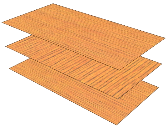

Matt, could you shed a little more light on the "plywood tends to bend easier in one direction and not the other"? I am not exactly sure what you mean, or maybe the cheap plywood that I have used so far doesn't behave like this.
Thanks
Sure. I should have not made such a general statement.
A lot depends on the plywood make up. Typical Okoume 4mm has 3 plies to it. The grain of the outer plies orientated so it goes along with the longer measurement of the 4x8. The inner ply is orientated toward the short dimension of the plywood, or 90 degrees from the outer plies.
This makes it easier to bend the plywood around the longer dimension so you're only fighting the grain on the inner ply.
In other words, imagine if you cut some plywood so you have a square piece and that your were tring to bend the plywood into a cylinder. It's easier to try and bend the plywood so the former longer sides touch together than it would be to bend it so the former shorter sides touch.
So when you bend around the grain direction of the outer plies, you're only bending against the one inner ply's grain.
When you try and bend around the grain direction of the inner ply, then you're fighting the grain of 2 plies.
I can't recall if the Home Depot/Lowes plywood has 3 "true" plies or just press board in between 2 outer vaneers. But it would still be easier to bend around the grain direction of the outer plies.
Now if you have some plywood with equal number of plies in alternating direction, then it won't matter which direction you try and bend in.
