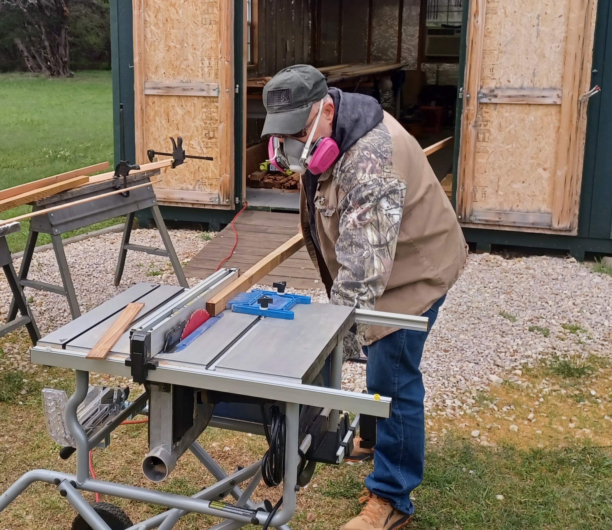

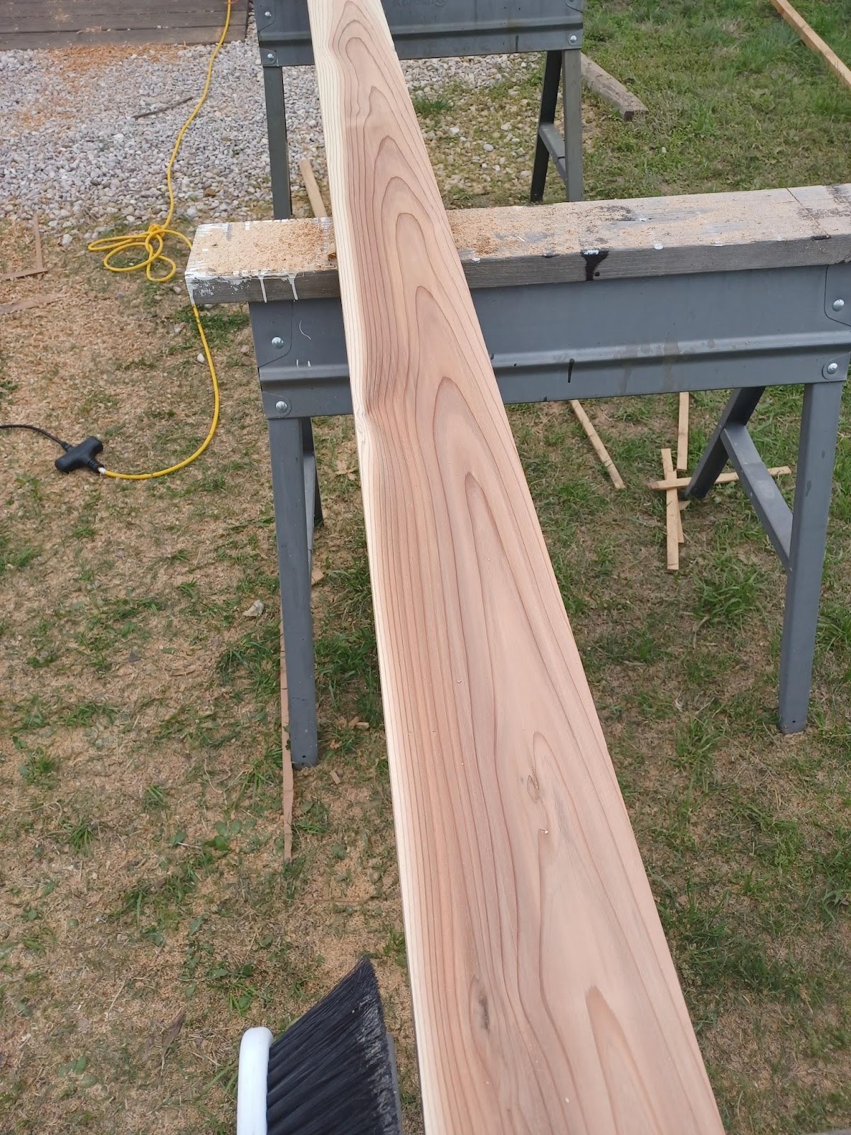

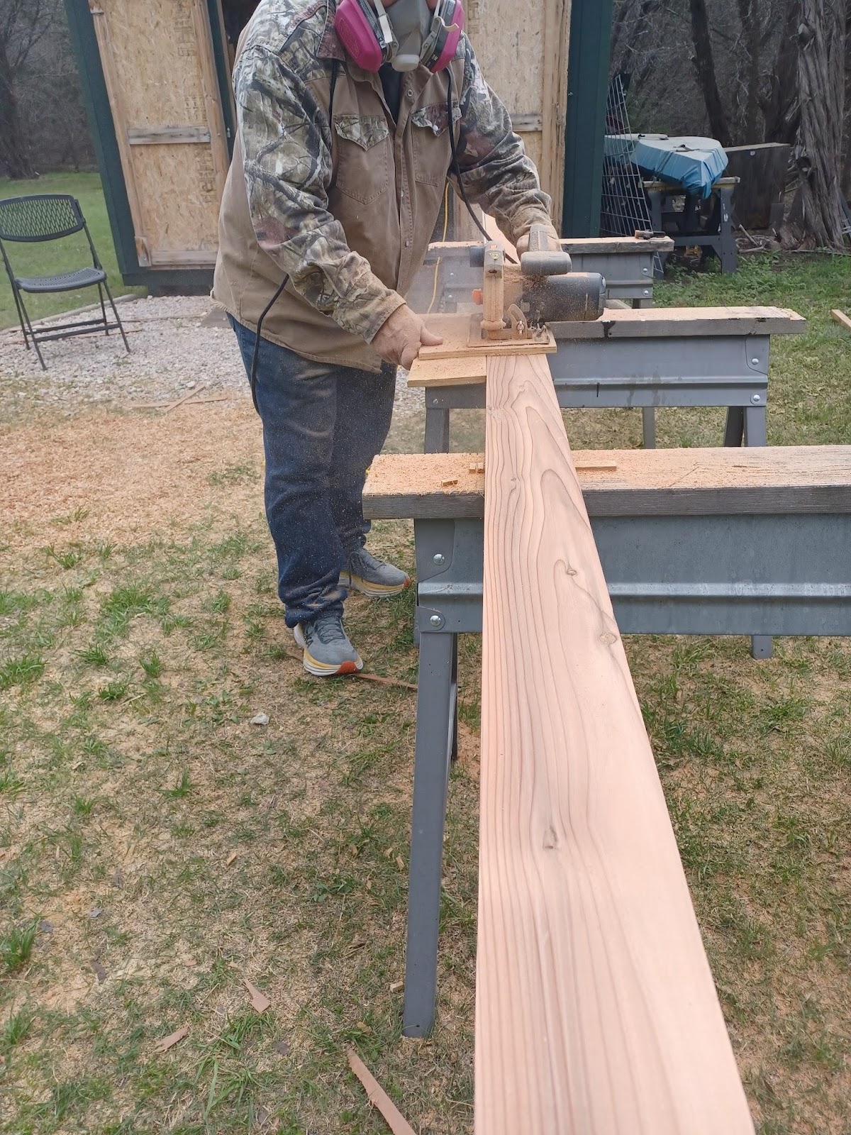

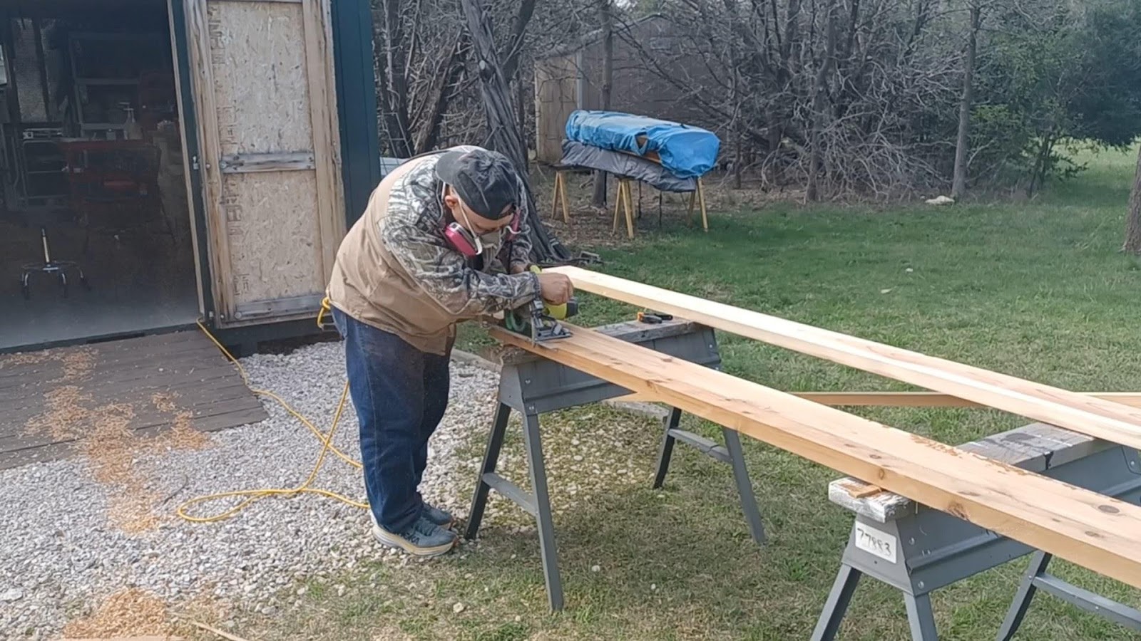

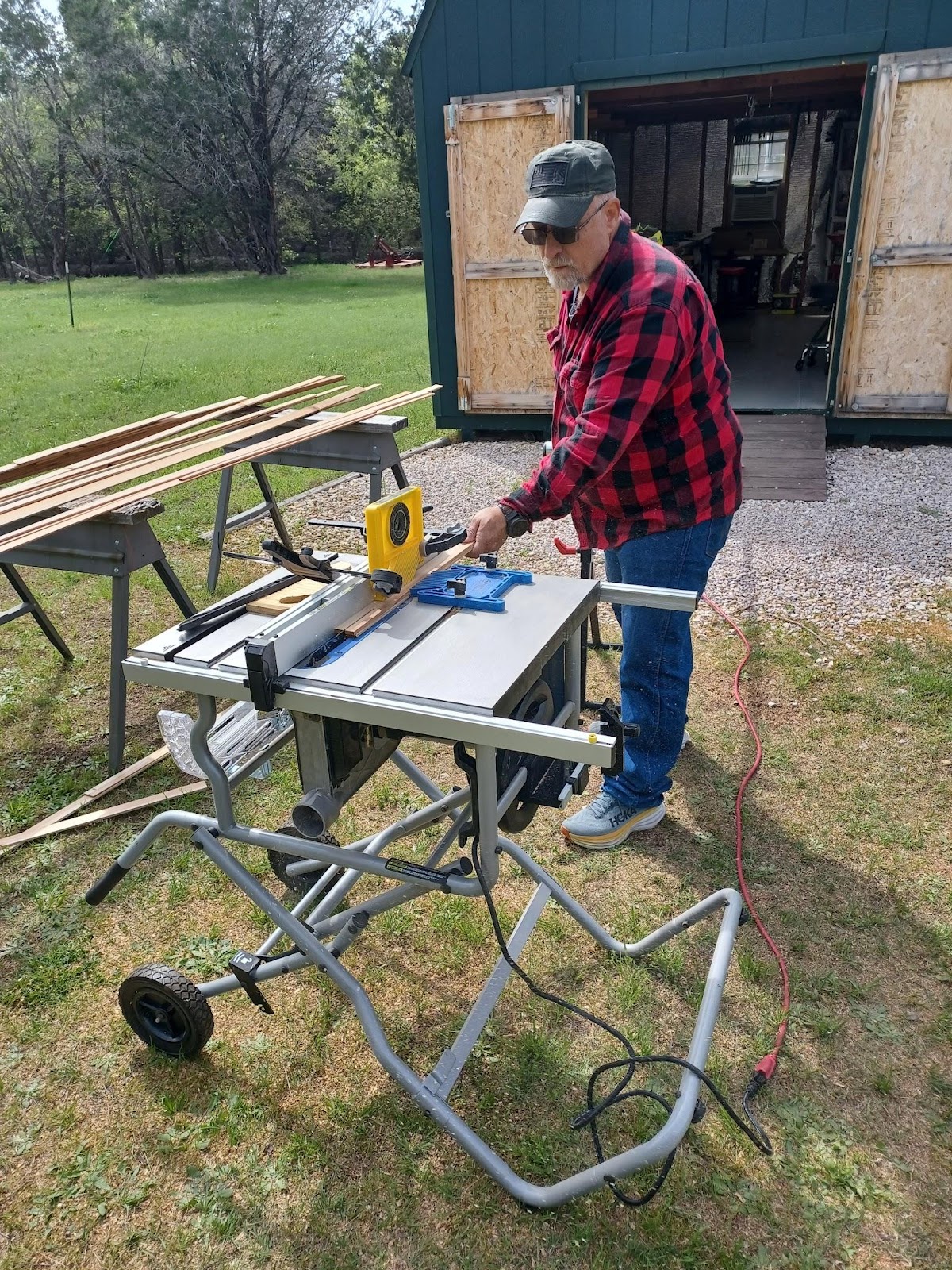

We got about 18 cedar strips from each board, ¼ “ thick, 1 ½ “ wide, 14’ long. I prefer to rip them with a “skill saw”. My wood jig for the saw is kinda heavy,so we tried it with a piece of angle aluminum for a saw fence. John using the aluminum fence.
zkMaT6Y_RPXQ8yr93HMAm1QyzqB9o6DhKw_oVEWsFxVQA7fUcKsEuYnVp43mZqbuH-XjiNgyj1wI97BrbyIzCIlf0MlAvZa-2X85badoGEkWPL5c-46LnBfF7Fv8_GHYugC1AhEhhbJA3RhsZFA7lA
That didn’t work as well as the wood jig, so we changed back to the wood jig. I find this much easier and more accurate that using the table saw, long boards are hard to handle, especially for one person.

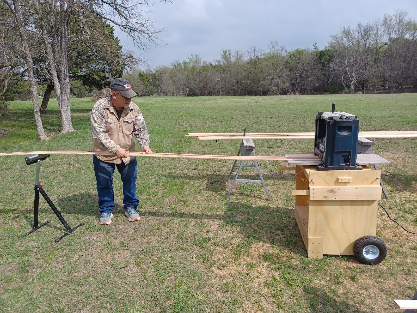

These strips then went through the planner. This step may not be necessary as all the boards will go through the planner after they are glued into panels. Planing them now makes them easier to glue into uniform panels.

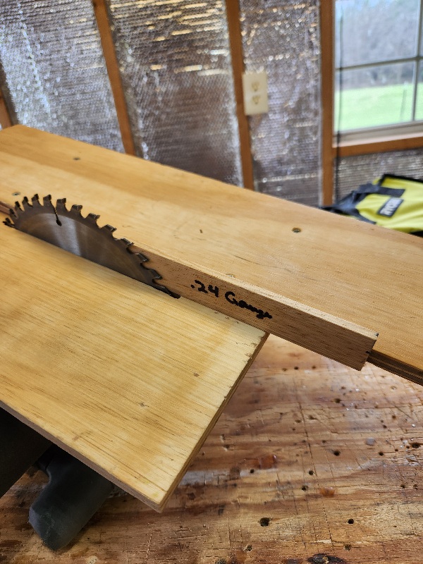

Then, on the table saw we ripped several of the inch and a half wide strips into ¾” wide strips. These narrower strips will be used for the side panels that have too much curvature to bend the inch and a half wide boards.

Is the wooden saw guide adjustable or would you need another one for different size strips?

Thanks beekeeper. I have a great teacher. The saw guide is not adjustable. I will post some pictures of the saw guide when I figure it out

I like the idea of the jig and not needing help cutting the strips on the table saw.
I don't mean to distract from the boat but how you do cut the last strips when there is little board left to support the saw?

JD I'll try to expand on that a little bit if you have another Inch and a 1/2 board like another 2 by 6 to lay beside the one you're Cutting you can strip it right down to 1 cut left I also like to secure the board to the saw horse somehow double sided tape or or something like that makes it easier. This picture shows what we took to the tablesaw.

I thought that might be how you could do it. Ripping strips on the table saw works best with two people, at least for me. I can make it work using my adjustable rollers on stands but even that goes much smoother with help.
