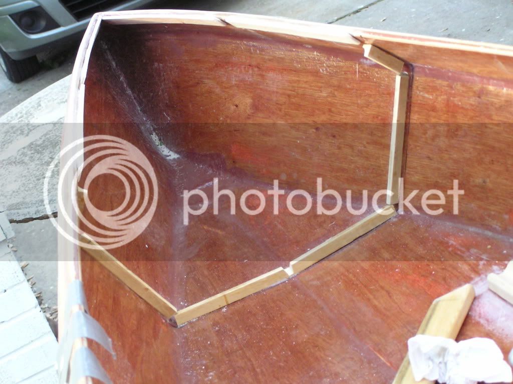

Putting on rear deck soon and mounting rudder. Here is the frame for the rear deck

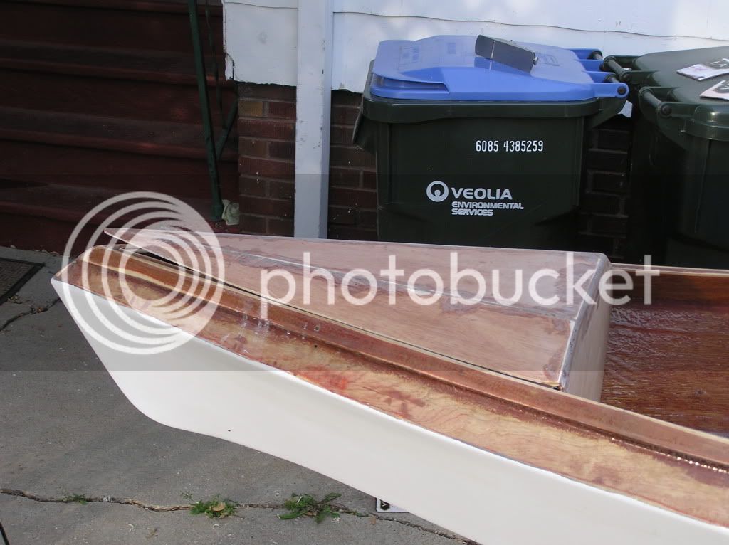

Here is the rear deck dry fit just going to take a little fiber tape and a screw or two to hold it in place while the epoxy dries

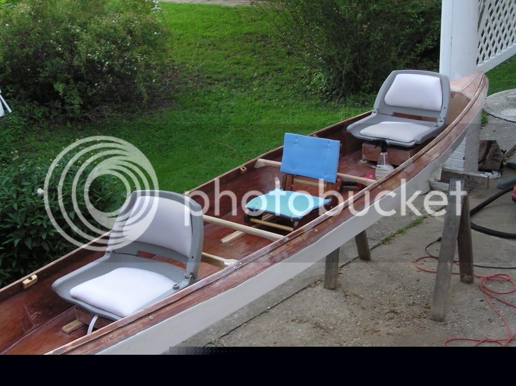

I have put seat tracks down for three positions. Don't know how the boat would handle three adults, but that is not what the middle position is for. I plan on training solo some so I wanted the option to be open. Tracks may help with some minor oil caning in the middle I have seen on the water. I have had to move thwarts around to make things work. I now have two positions for the rear thwart and I remove the front thwart unless I want to solo paddle, otherwise the front thwart gives more support for car topping. I have to remove the middle thwart if I want to solo. My front two seats are the same height, the rear one is a bit taller. I figure the taller seat position will give me a better angle paddling especially for the single blade paddle. I will probably switch out to the lower seat when I know I will be facing headwinds for an extended time.
I know I am probably over thinking this but my goal is maximum comfort to be able to stay on the water as long as possible.

Oil canning is not much of a problem with it. Nothing compared to the water bed like bottom of those plastic boats. I am trying to add as little more to it as possible. I started out under 50 pounds and I did not think I was adding much of any weight to it but it is sure getting harder to lift up to the roof rack. Just about done.....getting down to just adding pretty. I made a block that has two pins that will let me drop the navigation front light into a couple small holes in the bow.....very secure, portable and light weight......ingenious simplicity......if I do say so myself. Will post more photos of progress soon.
Got the rear deck installed and the rudder installed and tested. The rudder works great with control peddles from Duckworks. I got used to them real quick paddled 5 miles on a lake in 25 MPH winds yesterday. Just keep paddling and turn the rudder to keep your course......beautiful. Spent two days on the local lake had the bass boat and the pirogue out. Got the pirogue up to about 20 MPH towing it behind the bass boat she gets up on plane pretty good. :)
