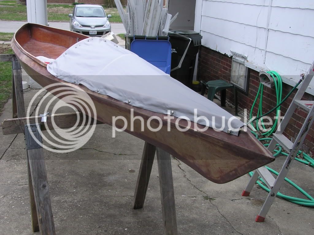

Update on splash cover.
Wow met up with my partner for a training session yesterday. Big Corps Lake, 30 mph winds, partner drove 2 hours to get there, we gave it a go.
We survived. We speared 2 ft waves over and over the splash cover preformed very well, without it we would have been swimming.
Now I just need to formulate the splash cover for the middle and back. Waves hitting this boat from sides we pretty much bobbed over. We got a taste of what sea kayaking is like. We held pretty close to shore so don't worry bout my sanity. Not too good a work out but great test for the splash cover we only held up for about an hour and decided it wasn't worth the trouble we might experience.

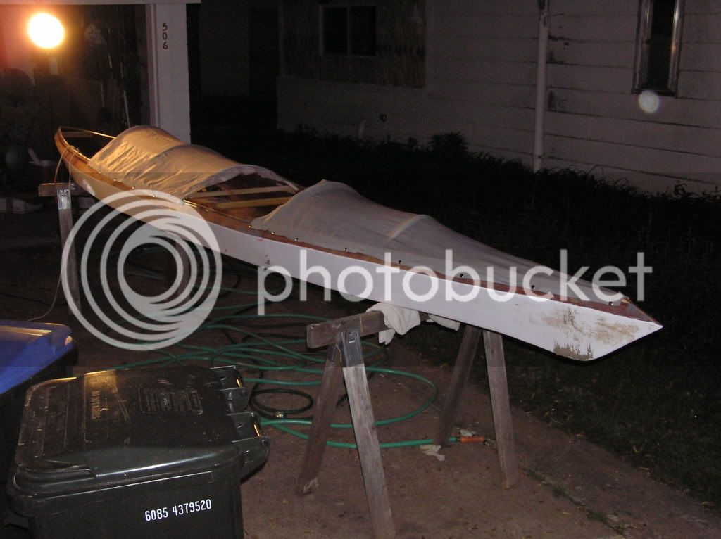

Nope, the design I am formulating is not too restrictive. I thought about making an actual custom spray skirt but it would actually be dangerous. The way I am designing it we will pop right out if we capsize. There is no way we could ever possibly accomplish a double ekimo roll even if this boat would do it, so no, we won't be locked to the boat.
I am waiting for epoxy to dry on my latest set of blocks with holes that will be glued to the sides to hold the cover stays. I think I have the positions along the gunnels where they will go planned out.
I have a hard top rear deck 90% built but I am starting to think about scratching that idea and just going with a soft top on the rear. Even thought how I could integrate a semi dry storage bag into the the rear cover. This would certainly push the limits of my sewing ability......can anyone say zippers? OH MY :shock:

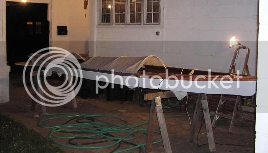

Got the middle section done.
I have not taken photos of how I attach the stays. They are just simple PVC water pipe. I made little blocks and drilled a hole in them to hold the pipe. I used 5 minute epoxy to stick them to the inside of the gunnel. I shot this photo before I put a cap on the front of the center cover. These covers will provide us with several benefits. The primary benefit is reduce wind resistance so the front of the cover goes to the floor to keep wind from getting under it from the front. The other benefits are sun protection and wave, paddle splash and rain protection.

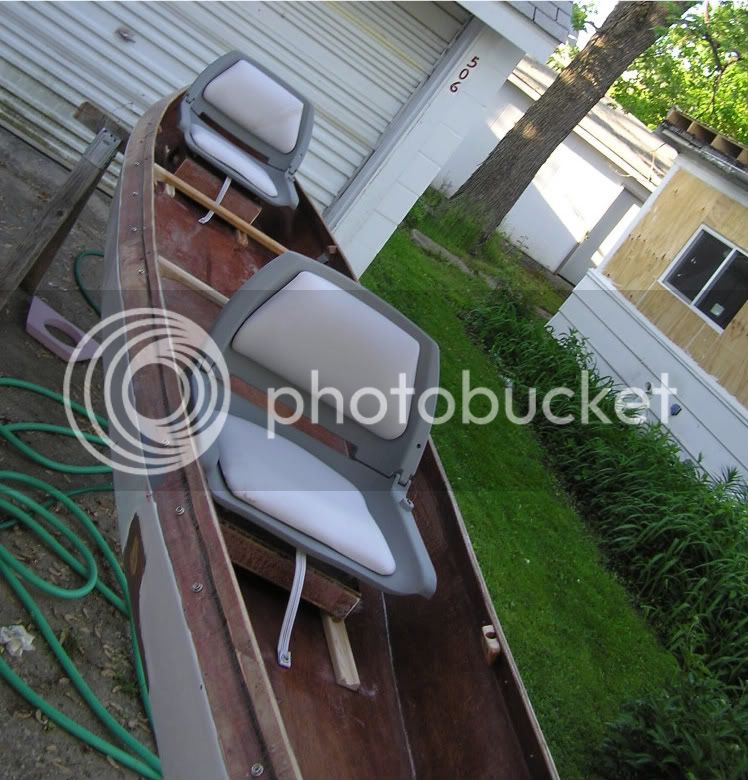

It will have two seats. I will be in the rear mostly. I should have pictured it with seats.
I just got the seat tracks that will be attached to the bottom for the seats to ride on. I am making new seat bases. These custom additions feel like they are taking longer to do than it did to build the boat.

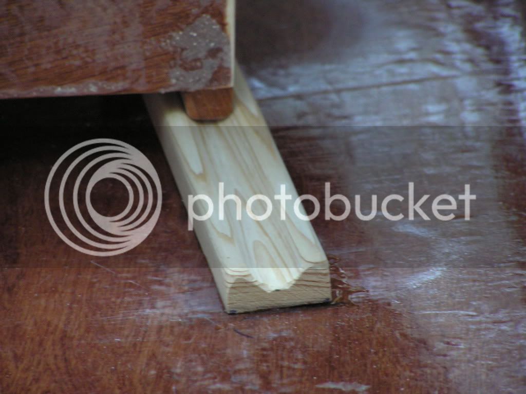

Got the new seat bases and sliding tracks put in place.
The tracks and seat base sides are made of cypress I will probably put a thin layer of 1.5 oz cloth over the bottom of the seat feet and on the inside of the track.
Just a suggestion leave the cloth off and just put a coat of epoxy on the part. Second make sure you have a tie down system for the seats , you dump it and loose your seats you will be in a world of hurt.

I could probably get by with just epoxy on this cypress. That is as far as I have made it on the seat feet. This 1.4 oz cloth I have fills easy though and will not add much weight and I think I have sanded the two surfaces enough that there is enough slop in the fit to allow for the glass.
Believe me I know about tying them in. Already dumped in the middle of the Missouri with her. We had a bit of fun holding on to seats and all the other crap we had. Lost half a kayak paddle, prescription glasses, and a cell phone got ruined. I am thinking just a check cord so they don't get separated from the boat in case of capsize. Whatever I do as far as tie down, I'm probably going to have to glue something else to the boat to tie to. I originally was just going to drill a hole sideways through the track, then I decided to cut a quarter inch off the bottom of the track to make them lighter and have a lower profile, then there was no room for a hole big enough to put a rope through.
Gave it a shakedown cruise last night. Worked good, seat position stayed solid while siting and was not too difficult to slide and reposition when I wanted to.

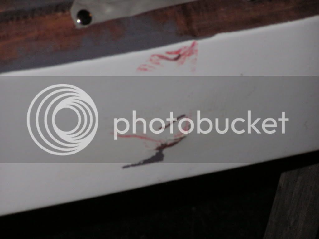

You do not have to believe I turned over a TV cause we really didn't. It never went all the way over, just swamped and rolled us out.
Long story short, a ten foot tall ton of steal river buoy disappeared right in front of us and reappeared just as we passed over it. Hit us in the side right at my hip, just the crane hook on the top of it hit the boat. It punched a little crack in the side of the boat.
The boat did stay upright, my partner was able to pull himself in over the stern and was ready to start bailing so he could paddle us to shore, when a fisherman with a motorboat came along to rescue us. he grabbed our bow line and just about had us to shore when he got hit with a glancing blow by a big head carp that proceed over his boat and back to the river, that is when he dropped our bow line and set us adrift once again down the big muddy. Got her pulled up on shore and dumped the water out before we saw the hole, we could have slapped a little duct tape on it and went on but we were so close to where we were taking out, the fisherman towed the boat across the river and headed out to try to recover some of our gear floating down toward Nawlins.
We got real lucky, if that buoy had popped any harder and a little farther toward midships it might have ripped her in half. Kinda made me wish I hadn't spent the money on fancy expensive paint, she took on a few deep scratches as well.
We survived and got one heck of a story to tell. The repairs weren't too tough.
