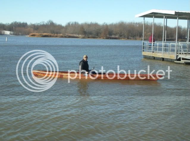

I built this one for running the MR 340 this summer, lots of work yet to do but so far so good. Very stable, under 50 lbs, she is a long way from perfect but she's mine. Christened "The Amanda Lee" Feb 13th. Photo is solo but plan is for tandem. Carries two big adults pretty well.
I will be posting more of build and customization as time allows.
Tom
PS sorry having trouble with the bow not being cut off in the photo bucket photo
Tom,
Your bowis fine. There is water between the bow and the edge of the picture. It drove me nuts because when I would post a picture part of the right side of the picture would be missing. Finally figured out that everyone else was seeing the whole picture. So I figured that it was my computer. :?:
Wow, that is a long pirogue. :wink: I would need hinges in the middle to turn around where we paddle. The bayou is not that wide. Tell me about "running the MR 340". Is that a race? What kind of water?

Yes, The MR 340 is a canoe / kayak race across the state of Missouri. This summer will be the sixth running of the race and there will be over 350 boats in it. It is the longest non stop human powered river race in the world. The Yukon Challenge is longer but there are mandatory stops in that one. The course is 340 miles from Kansas City to St. Charles/St Louis on the Missouri.
When the race started a few years back with only 15 boats the field included probably 50% good old aluminum canoes, in the years following the boats running the race have gone over the top as far as what people are using to do it. Very light skinny hulls with very little free board. The boat does not need to turn much on the big wide Missouri. I am very happy so far with great comfort and stability of this boat. There are basically two kinds of participants in the race, racers and adventurers. Racers are trying to place and get there as fast as possible, adventurers are just trying to finish. I am in the latter category.
The length will help with speed and increases the carrying capacity to comfortably hold two men. It has a low profile that will help in inevitable headwinds. So far tests have proved it does do well in a head wind. Cross winds are another story, I have a second hand rudder I will be installing to help with that. I am also making domed spray covers for the front and center to help with wind and possible rain.
Google the race, you will see many interesting things about paddle powered boats. In the history of the race I have not heard of anyone that has called their boat a pirogue, don't know if i could really classify this one as a pirogue but I am. I like being different.
