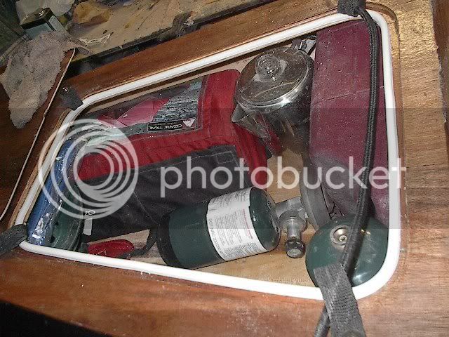

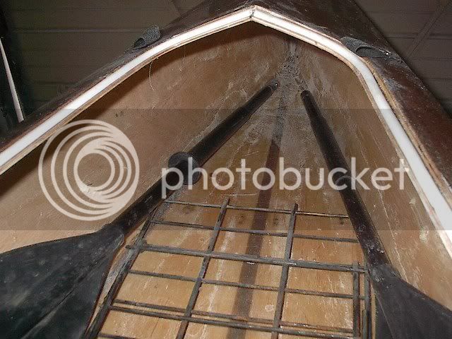

Here are some pics the back hatch loaded
inside that hatch right now is coffe pot tent cot latern stove machete
hatchet 2 tarps skillet and pot flashlights extra propane shovel and I still have room for a couple gallons of water

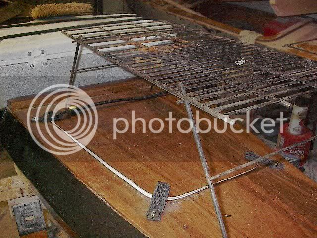

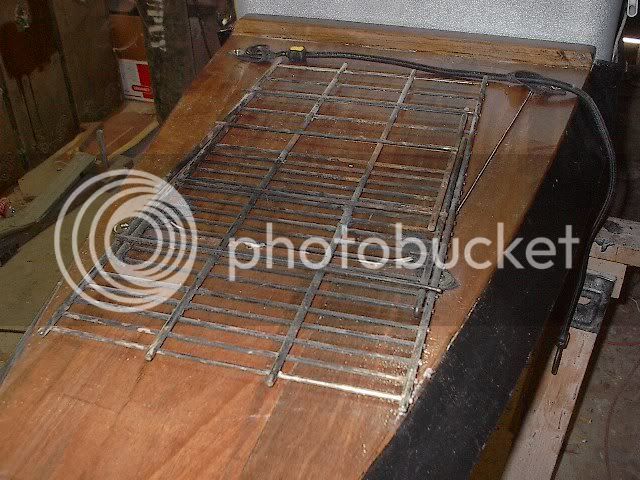

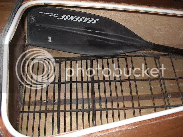

Here is the grill I use it folds flat buy just flipping the legs over. Right now it is 24 inches long ,most of this trip I will be solo , so I am fixing to cut it down to 13 inches.
really compact and sturdy.
I have used the tripod grills and they are great but on this trip I am trying to stay small and light as I can

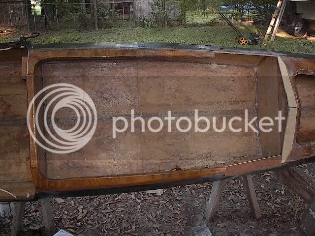

Took a saw to the Brazos Queen tonight.
She use to look like this

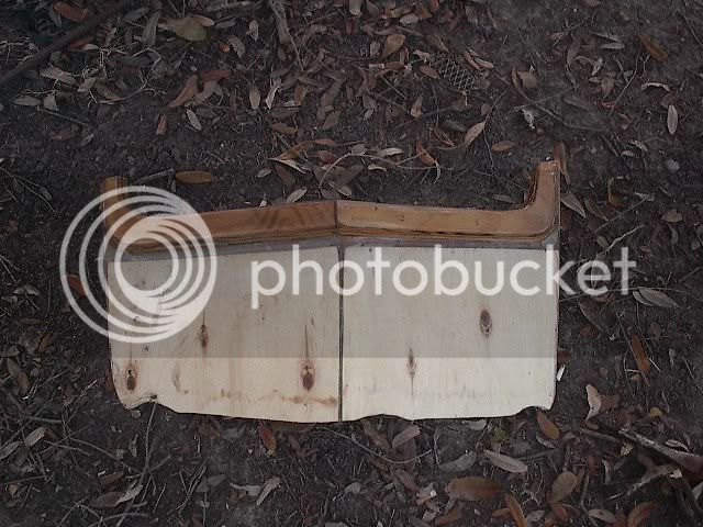

I cut this out of her today
now she looks like this
This boat was built from a wood that is junk and just an 1/8 inch . I learned some lessons there
4mm laun is my wood never use 1/8 again.

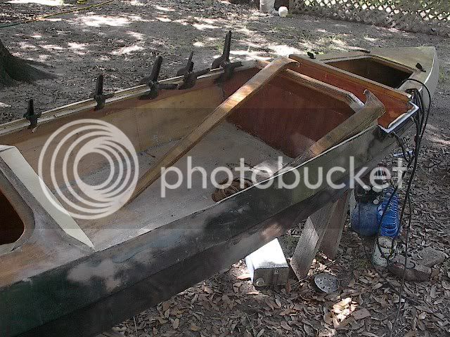

This poor boat has caught it ,I fell hard on the combing and cracked it, it was blown down a sandbar a hundred feet ,broke off two rod holders ,been paddled a couple hundred miles on the Brazos. She is just to good a boat to scrap so she is fixing to get a face lift.

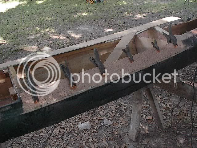

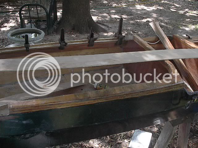

One of the things I wanted to do was change the cockpit configuration up..
I am going to widen it 4 1/2 inches ,I cut the top deck out so my feet will be completely clear of the deck. I am an old , set in my way kind of guy ,so just naturaly I wear boots most of the time even paddling,and they sure help on the rocks on the Brazos. I needed more room.
cut out the sides and coming
started rebuilding the cockpit.
Thats it for now

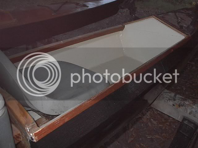

Little update on the queen
As I said earlier in this post the cockpit is opened up 4 1/2 inches and wide open from bulkhead to bulkhead. Inside of the cockpit sprayed an almond color

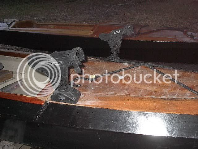

rod holders were reinforced under the deck with some pads and then remountad

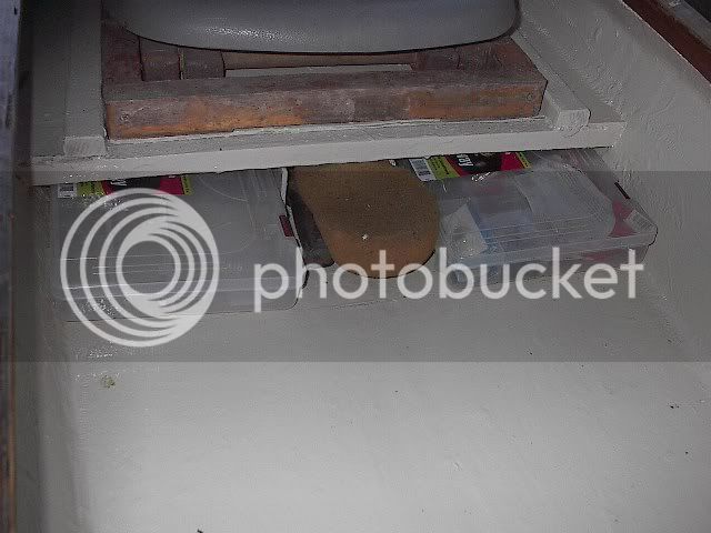

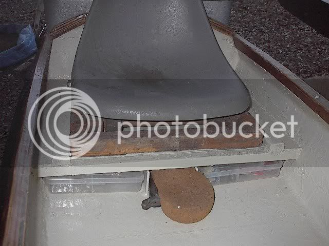

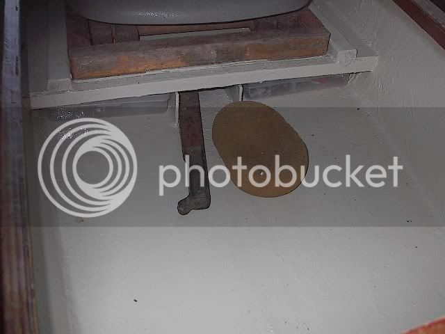

I raised the seat to 9 1/2 inches from the floor,put in rails that center my seat and hold it in position but still let me take it out of the boat
under the seat I built two compartments that hold to plastic tackle boxes
there is a third compartment for my machete and sponge

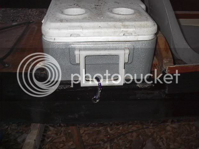

change my tie down for the cooler so it was held in by 2 cabiners but you could still open the lid while it was secure.

Does the cooler lid have a latch, or does it just kinda snap in place?
My point is, if you got the boat upside down, would the contents of the cooler dump out?
George
