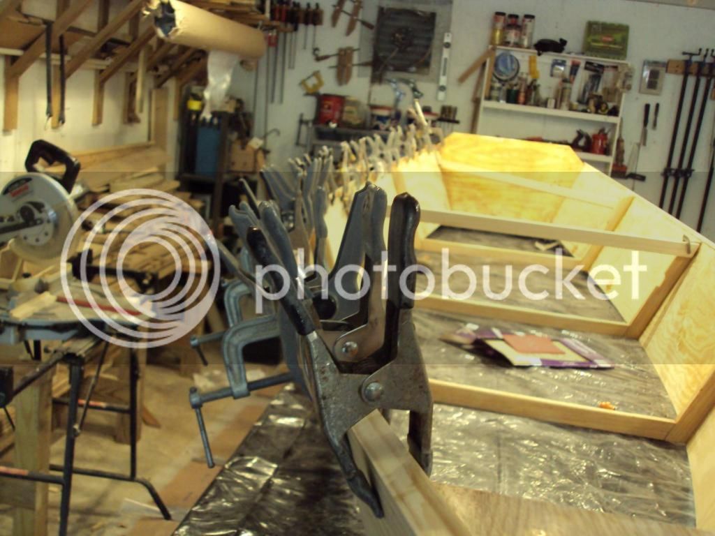

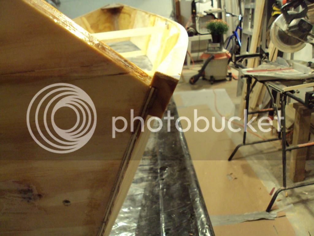

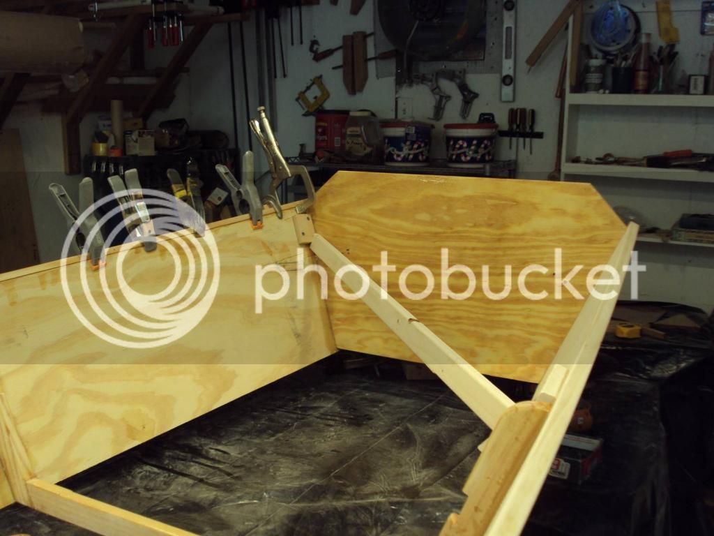

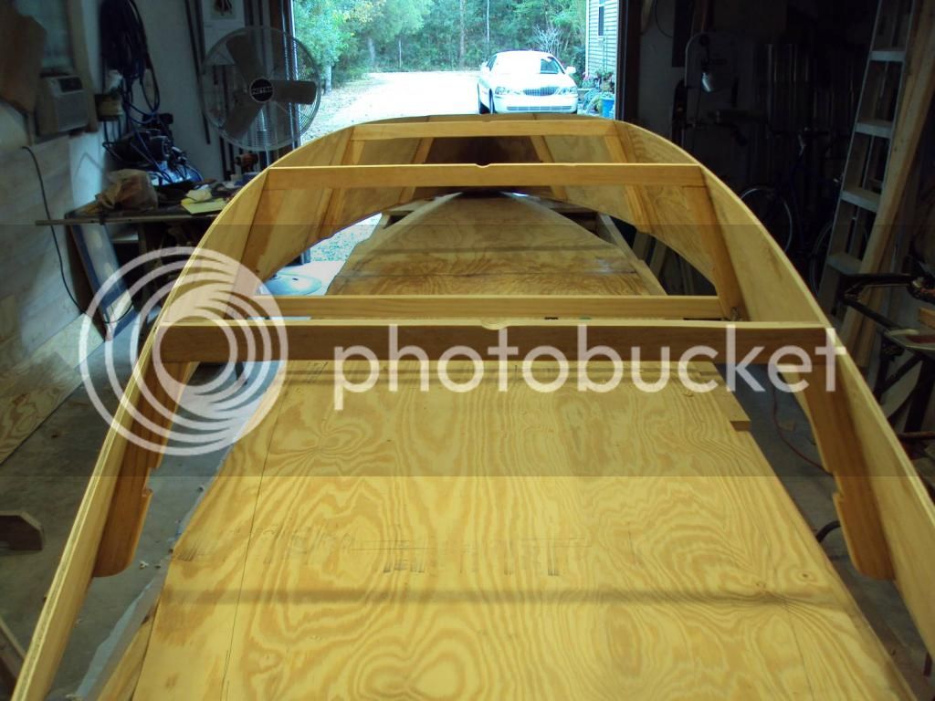

Here are the pics I promised. I tried to resize them so they wouldn't be as large as the last ones I posted. let me know if this size is better. I now have the ribs epoxied to the sides and the rub rails on.
Fun, isn't it, watching a pile of slats and plywood become a useful object? We are builders, and have opposed thumbs. Human characteristics.
But, Twin nailed us even better, when he observed that, "Man - is the only animal that blushes. . . . . . Or needs to."
BINGO!
