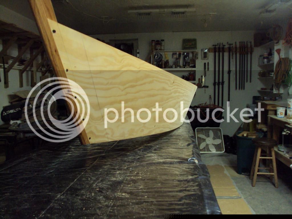

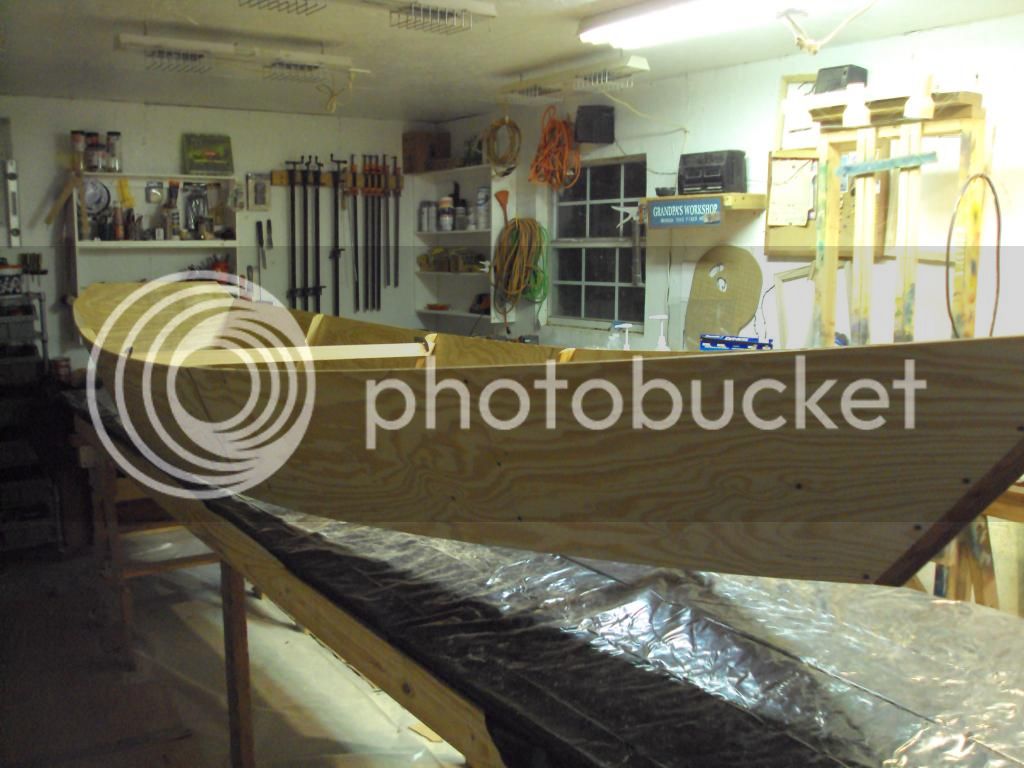

Thank you Mike. I'm just about ready to break her down and epoxy saturate the parts. Been doing some reading about how to do that, or if its needed at all. The more I read, the more confused I become. Would love to get some thoughts on that. Is epoxy saturation needed? Should the epoxied be thinned? And if so, what's the best way to do that? By the way, I'm using non-blushing epoxy from Raka. Thanks again for all the help.
First, what do you mean by "breaking her down"? Once saturated, panels are difficult to bend. You will be a happier camper if you saturate an asembled boat that has already been glued into shape, sanded, and ready to be glassed. Plus, curing gives you only 3 days for the next coat of epoxy - the one holding on the glass - to bond chemically, not just mechanically.
Chuck will advise to saturate, let cure no more than a day, and sand off wood whiskers raised by the saturation coat. Good idea.
Thinning helps penetration. Acetonecan be used. Cautions: 1. Acetoneis highly flammable, and will burst into open flame if near an ignition source such as a gas furnace, water heater, or maybe even an electrcal heater. ("Mommy! Mommy! See the funny man run and wave his arms!"). Best done out doors. 2. Acetonecan enter the body through your skin. Don't get it on your skin. Don't drink it either. 3. Mix epoxy in small batches, 2-3 ounces total. Darned stuff creates its own heat and boils over. Boiling hot and very sticky - similar to napalm.
All that being said when you proceed with common sense and no jackassed behavior, its safe and produces lots of nice, strong, light-weight boats.

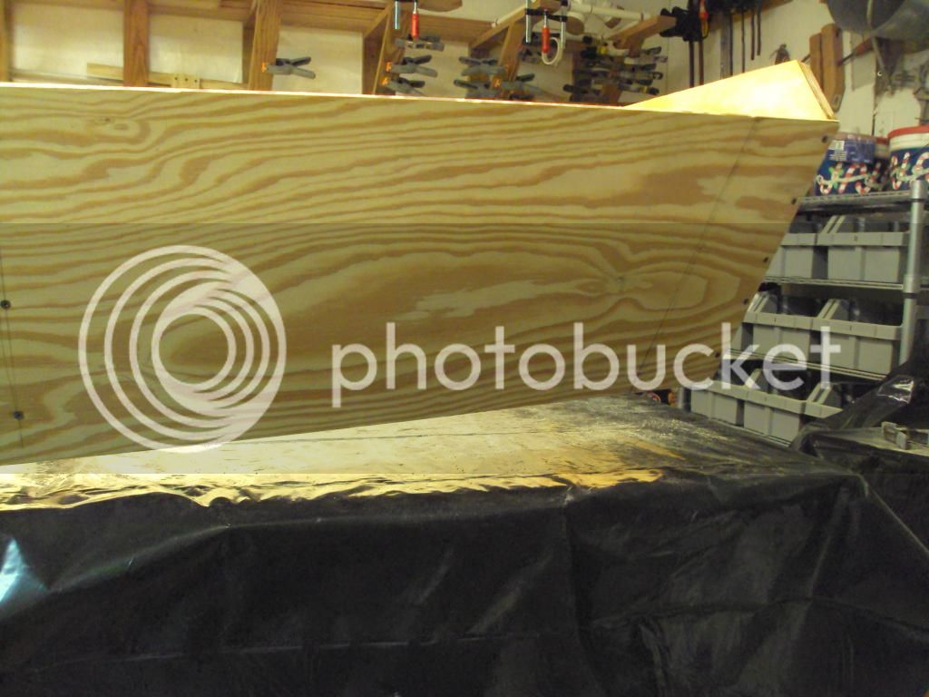

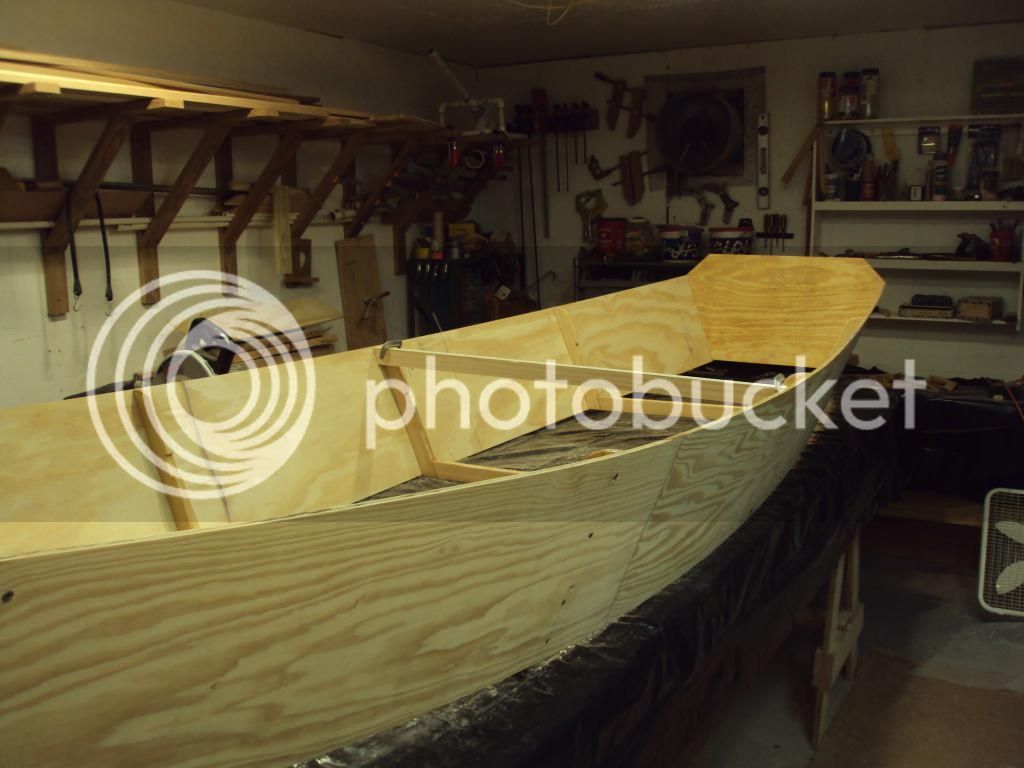

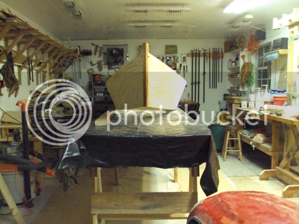

I havn't sanded the sides, the epoxy on the ribs, or the bow stem which is already epoxied. Thought I would take her apart to do that since she is only screwed, but not glued, together. Should I saturate the areas of the sides where they connect to the transom and bow stem before screwing her together or since she is already together, do you think it would best easier to back the screws out some and glue her up?
Without standing there, looking at the boat, it's difficult to know exactly what you are taliking about.
General guidelines I use are: 1. All wood is sealed off from water by epoxy. Its called "encapsulating". 2. All seams are either taped or fileted prior to glassing, thus sealing off water at joints. A rounded filet lets the glass bend easily, and adhere to both inside and outside radii. 3. Epoxy companies failed to send along any runs, drips, or sags - so I always seem to install a few of my own.
What Jack said in the above post. :D
To glue the boat you could back the screws out a bit and run some epoxy in the joint and then screw it back down.
As far as the saturation...............
Plus after saturating the wood some of the wood fibers will soak up the epoxy and become enlarged by standing out from the surface of the wood. They are what I like to call the wood whiskers and need to be removed before glassing the boat.
If you lay the glass down on them and move the glass they will pull on the glass and cause runs in it.
So a light sanding will remove them and let you move the glass around without damaging it. You do not need a 4 handed , 15 hoarse powered sander to remove them , just a piece of sand paper formed around a artificial sponge ( one of the rectangular ones ) will do it with a light swipe or two.
Run your hand over the wood ( Very , Very, Very lightly ) to see what I mean by the whiskers after you saturate the wood , then after one swipe with the sandpaper.

About "saturation." I think in general that the term is used rather lightly. The original version of "epoxy saturation" was using very thin sheets of a porous, dry wood and very thin epoxy to make your own "plywood." Most any shaped hull could easily be made into a truly single piece of plywood, no seams at all.
The type of building you are doing doesn't really go that far. Even thinned with acetone, you are unlikely to get full penetration of the outermost veneer. And if it should go as far as the first glue line, it will go no further. So what you are doing is more properly described as "epoxy encapsulation," as was mentioned earlier.
And it works great! :D
