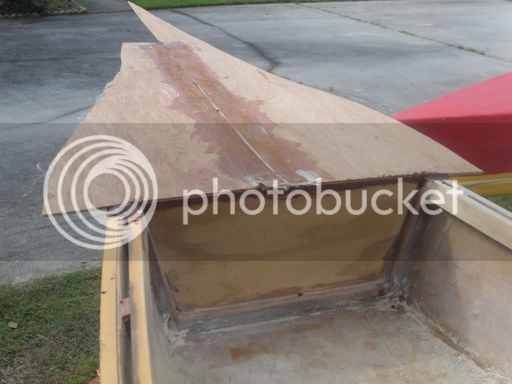

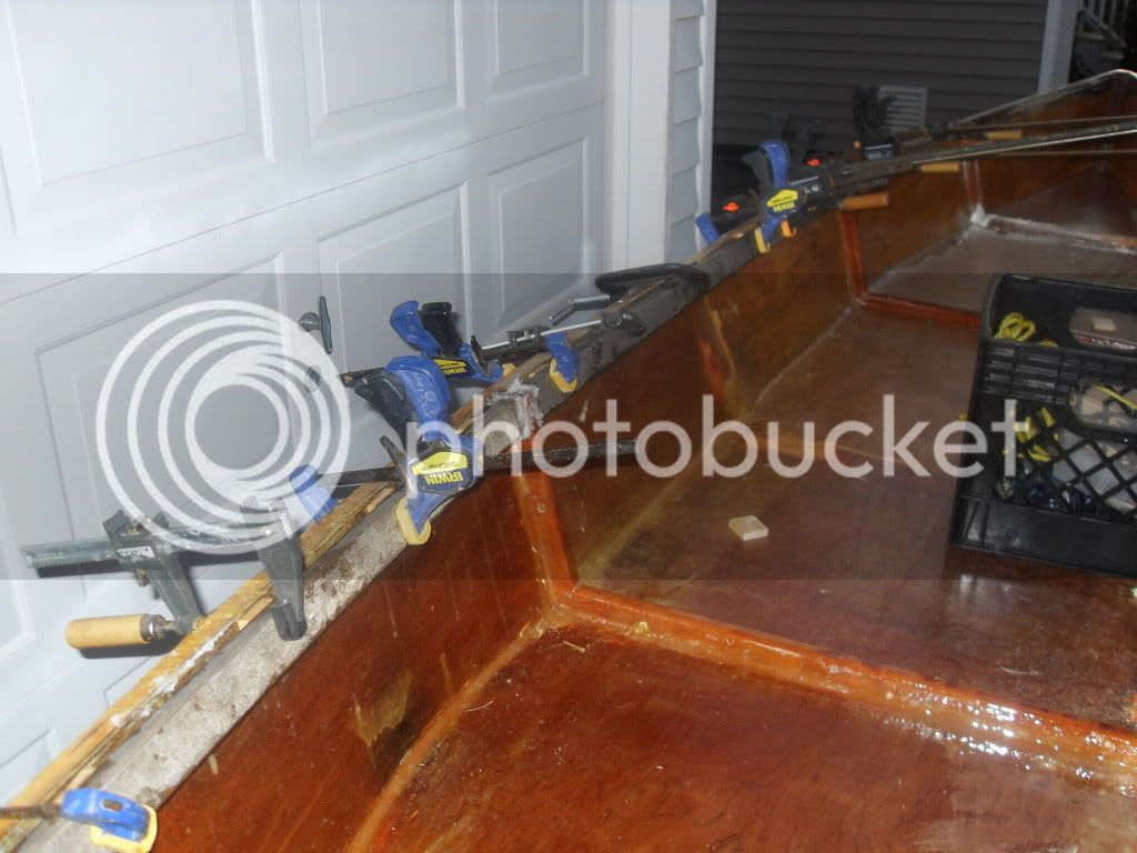

Here are the pics of the updates on boat #2. Pic #1 is the inner rails being glued and clamped in. Used resin and wood dust.

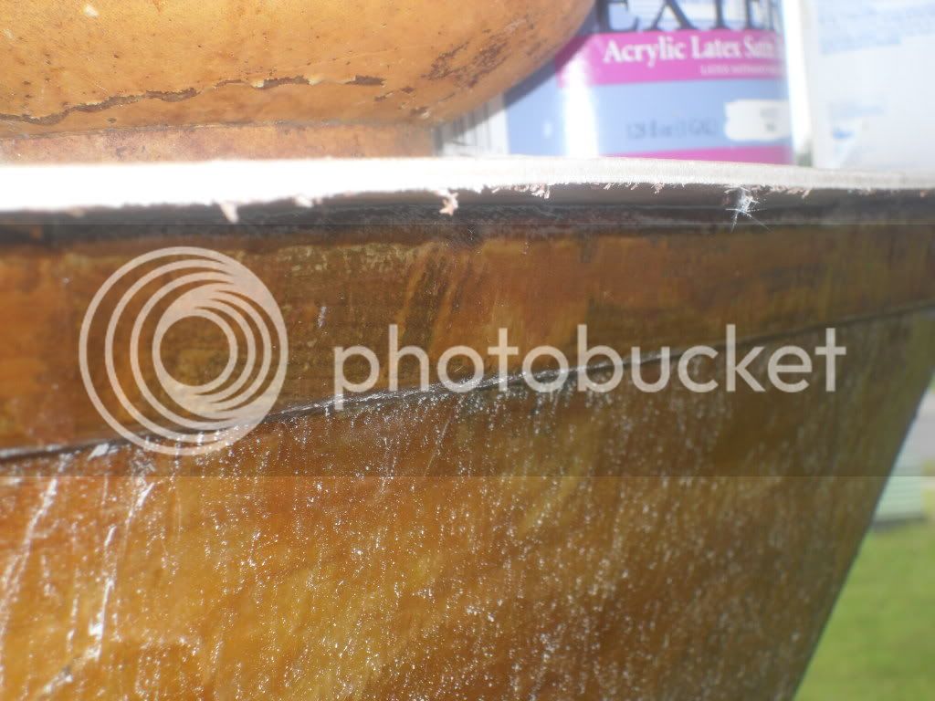

Pic #2 is of the bracing I used to support the decks and the bulkhead pasted in place.
Pic #3 is of deck #2 glued in place. I trimmed the edges and will sand the edges smooth to the rail. The top will then be sanded and covered with another layer of fiberglass completely encasing it to the rails.

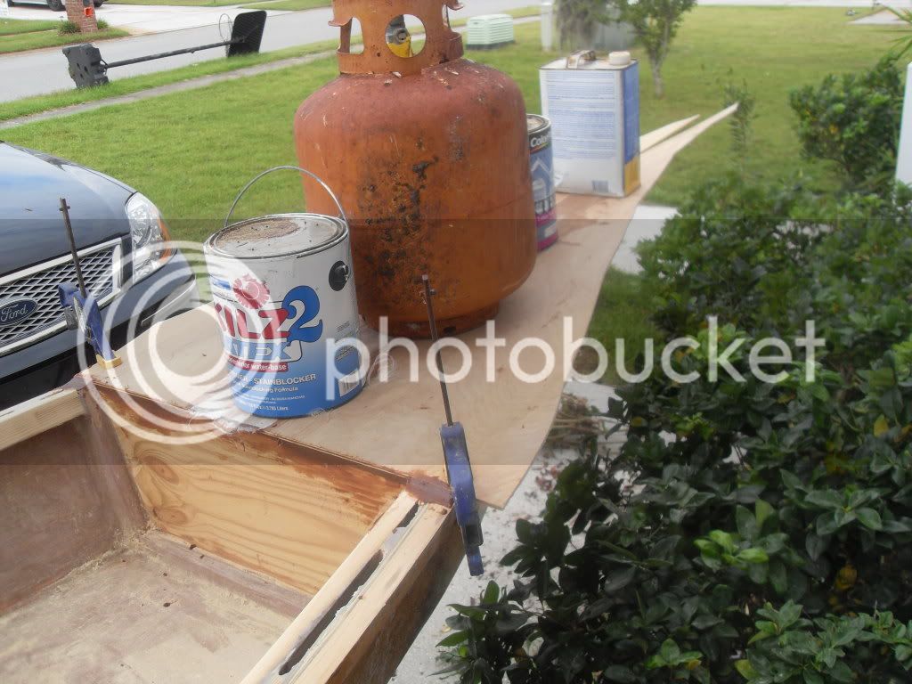

Pic #4 is showing the 2nd deck being glued in place with the weights I used to hold it in place while the resin kicks off.

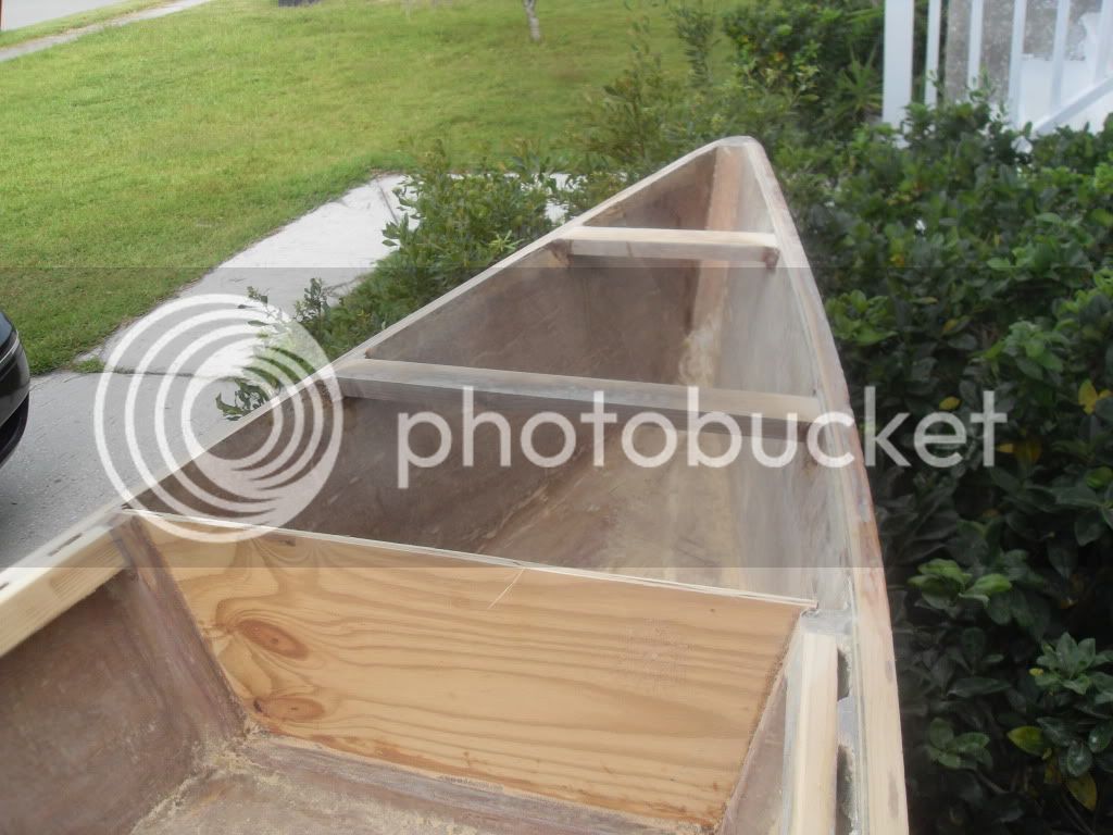

Pic #5 shows the gap filled between the 1/8th inch luan deck and the edge of the rail.
Once I trim the excess deck from the edge I will use my belt sander to contour the edge from the luan to the filler to the rail. Then it will be ready to fiberglass and finally paint.

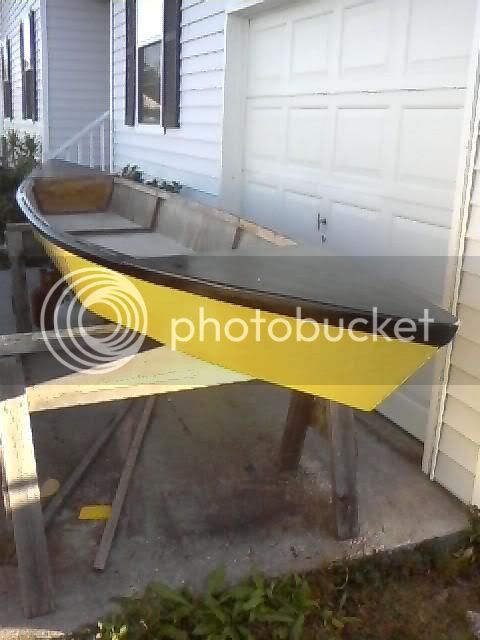

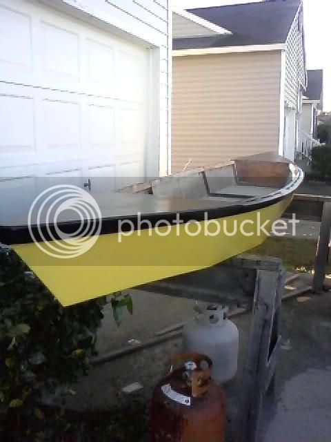

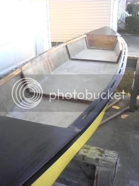

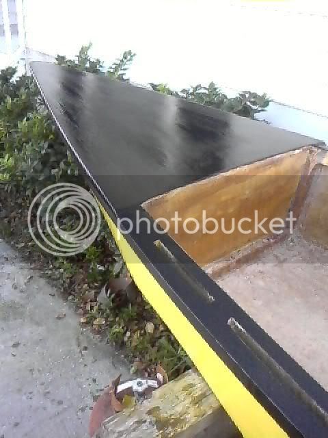

Finally finished up my son's boat. With him being a Pittsburg Steelers fan, he chose the black and yellow as his colors for his boat. Last weekend had to rub it into him since the Kansas City Chiefs beat his steelers.
Now to finish up his paddle and get a seat for him and he is ready to go on his maiden voyage.

"O" Some dirty pool on the Steelers for him but one nice boat for his enjoyment , Thanks to you. :D
