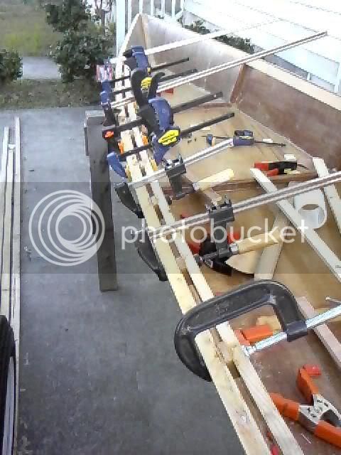

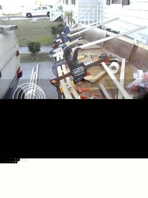

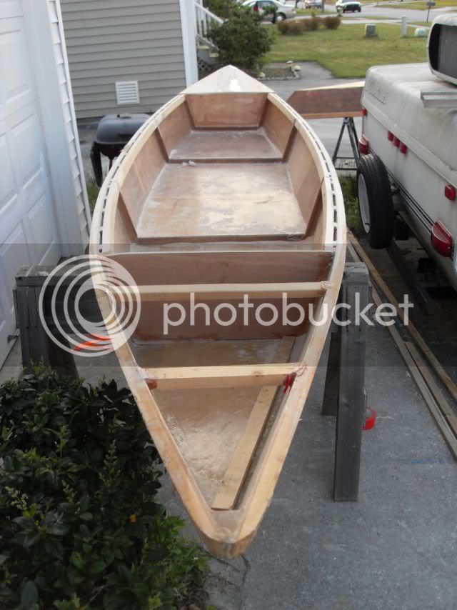

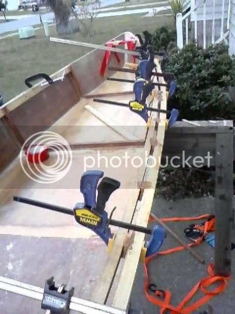

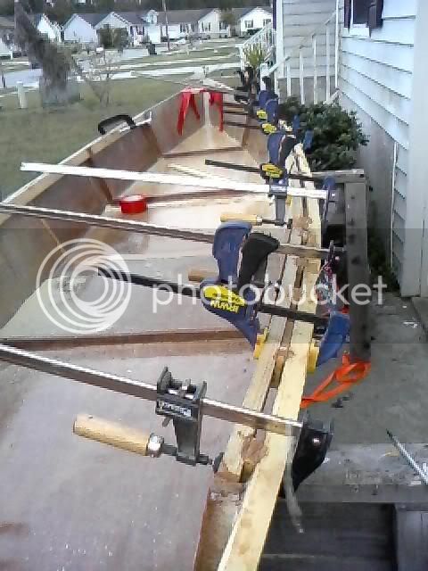

Here are a couple of pics from glueing the first set of gunnels to boat #1. As we all know, there are never enough clamps around and I didnt have any drywall screws long enough to screw each spacer down. Looks like I will have to work on them throughout the week.
While I was waiting for these spacers to set, I began glassing the inside of boat #2.

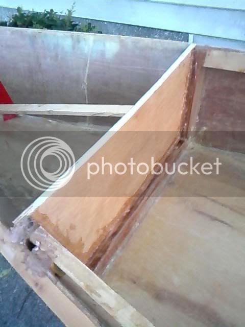

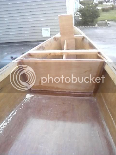

Installed the bulkheads on boat 1 today after work. Instead of using wood dust for my filler, I had chopped up a bunch of fiberglass scraps from work and stirred them into the resin. It sure thickened the resin alot faster than just the wood dust.
The bulkheads are made from 1/2" sandply leftovers from some previous projects.
How finely chopped was the fiberglass that you used for thickening? I picture it being hard to smooth with the fibers in it...?
Your boats look a lot like boats. Which is something I always find encouraging when I build one. :D I like the spacered inwales. I haven't ever done that on one of mine, but it is a sharp look when done well.

The chopped fiberglass was 1/8th " to 1/4" pieces. Yes it was alot harder to smooth out as well. It had started cooling off this evening when I was doing it so the resin really felt like trying to spread peanut butter. I am interested to see what it looks like when it sets off and hardens and then after i sand it smooth. I did like how the resin didnt run once I got it in place. I also got a nice complement from my wife when she looked at them tonight as well. :wink: I can't wait until I can finally get them painted and rigged out and put into the water.

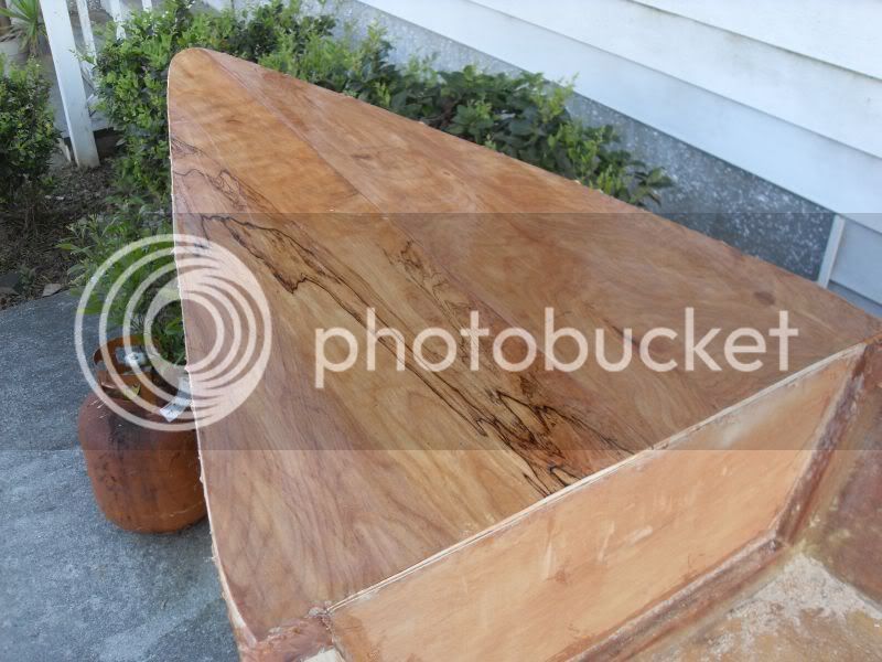

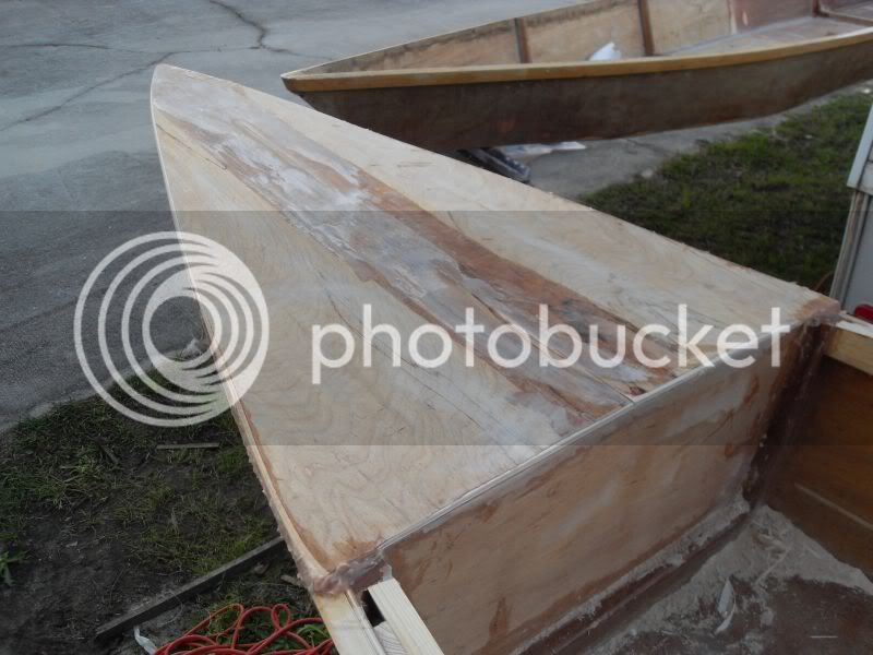

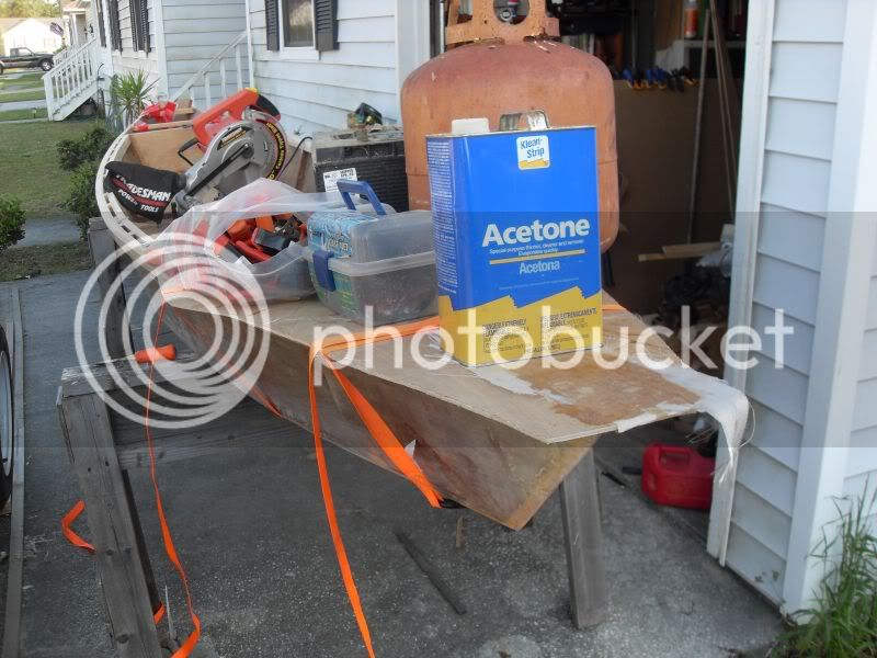

Today I was able to get the first deck glued on. Used more of the chopped glass in the resin. Still hard to smooth out but sure sands quickly. First couple of pictures show the deck glued in place with weights on top.
The next couple of pictures show the deck later in the day when I trimmed the excess away and rounded the edges and filled in the voids from the initial glue up.[
Todays final pic shows the boat minus the 2nd deck, glass and resin to completely encapsulate the rest of the bare wood.
That's a LOT of weight on there. I hope you didn't work to glue starve the joints. I recommend you see if the deck will peel off by mere hand pressure. If it will, lots better to find out in your driveway than on the water.

No problems with the weights on top of the deck. The deck didnt have a pefect, flat fit on top of the rails. I buttered the edge of the rails with thickened resin, weighted it down and clamped it with a couple of web straps. The left over resin I then pressed into the opening along the edge, buttering them just like a mason would when setting blocks or bricks for a wall or foundation. Once that was dried, sanded the edges round and touched up any needed areas. Today I have just covered the first deck with glass and am now waiting for it to dry along with the 2nd deck. A little later I will trim the excess off of it and get it ready for glassing as well.

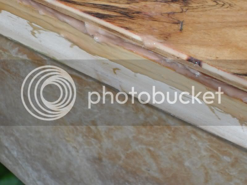

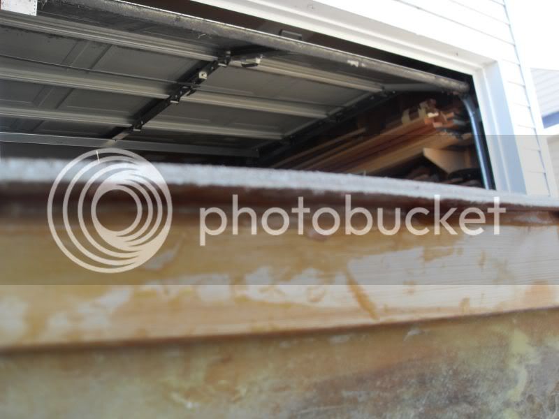

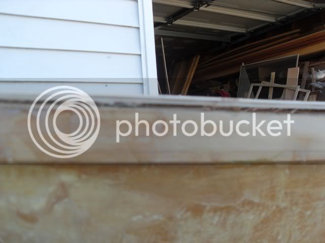

Here is a picture from today when I was ready to fill the gap between the outer rail and the deck.
Next are a couple of pictures after I had applied the thickened resin to the gaps.

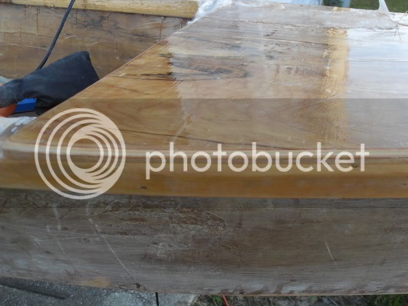

Once the gaps were filled, I applied a soaking coat of resin to the 2nd deck.

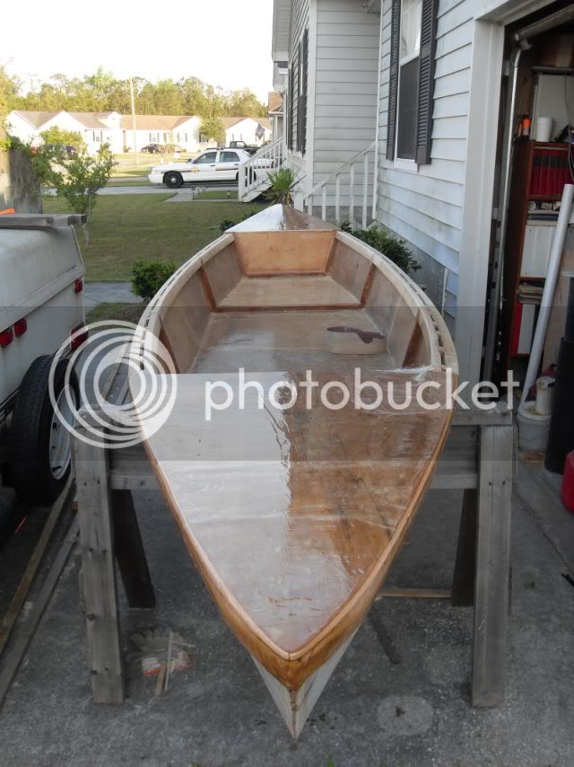

Later this week, I will sand those edges smooth and round the top edge in preparation for glassing. Here is a picture of the first deck, glassed and 2 coats of resin.
