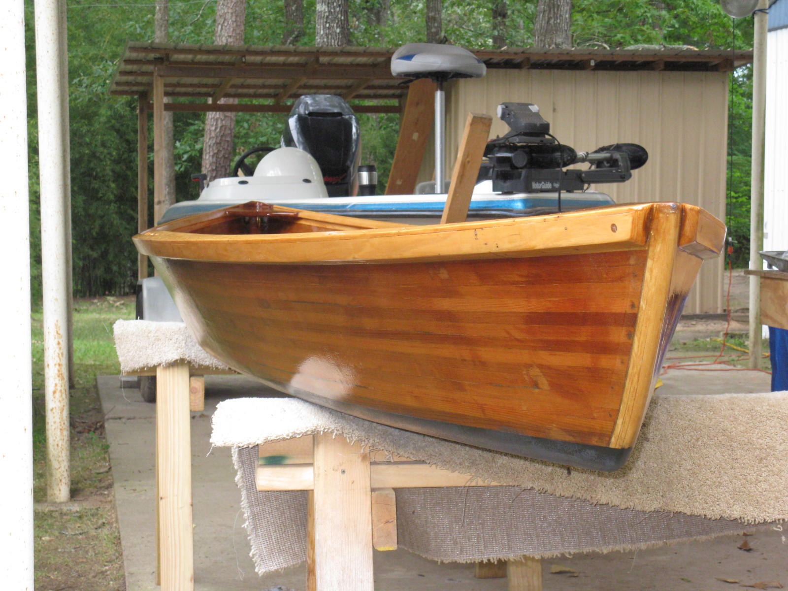

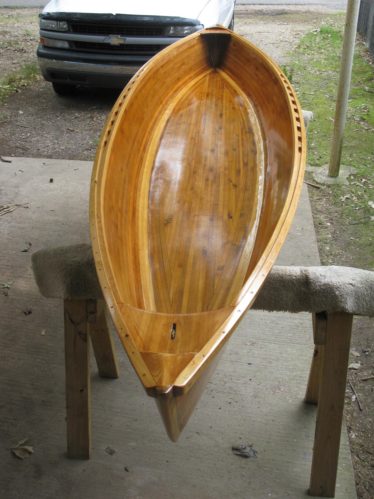

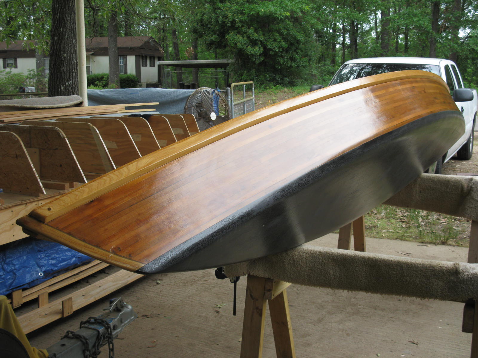

I understand your point about thwarts. I did not want to add them because they would probably be a trip hazard for me. I prefer an uncluttered interior. After adding the glass to the inside, the boat became stiff/strong enough for my usage (no white watering in Louisiana). The extra glass was added to the floor to stiffen it. There was no issue with side flex. I think the laddered gunnels were strong enough to eliminate the need for side ribs or thwarts.
Built in seats and/or divided compartments in a pirogue act as thwarts. I like tumblehome sides to stiffen the boat. So many factors to consider when picking design features. Maximum strength may give way to "strong enough" to gain a more useful feature.
Found some of the pictures.
