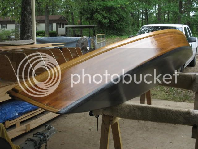

Finished at last. :D It was fun, but with all my mistakes :cry: , I thought I would never finish. What it is, is what it is.

Took the boat out for another appliction of slime. Sliming realy is the best part of boat building. Was only able to apply a light coat (two small bass). That is OK. I'll just have to go again. Paddled farther than usual just looking around the bend, and putting in some seat time. I do like the light weight of this boat, loading and unloading. The boat has a different feel than my others. Seems to glide farther, and my be easier to paddle. It rocks more as you cast, or any other movements. I can't decide if the soft chines were worth the effort. Guess I will keep going until I know.
Six coats of varnish does not make for a slip resistant floor. It will get you nice compliments at the store.

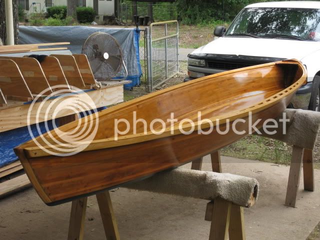

To the left of the boat is the strongback and stations with the forms used to build and shape the boat. It is strip built the same as a canoe or kayak. Hardest part was figuring the size and shape of the forms with out plans. I think when building "by hand and eye" the boat is shaped with movable jigs and then the ribs are added. Building with plans the size and shape of the ribs are known and are used to shape the boat. They act as jigs but only allow you to build to one known shape. Works ok with strip building or plywood. May not work with lumber because it may not conform to the ribs shape.

I like the ventilated gunnels. They are strong, light weight, and easy to dump out any water when you get back on shore.
Also handy for fish stringer or anchor tie off points. I chose to "ventilate" only the middle sections and was pleased with the look. Others may need them done the whole length of the boat, but I don.t venture very far from my seat.
Guillaume
The floor is strips. They were 3/8" but still needed two layers, one 6 oz. and one 10 oz., of glass on the inside to stiffen it enough to not need ribs.
