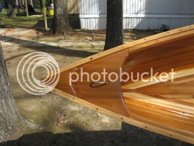

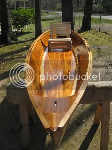

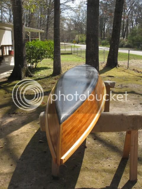

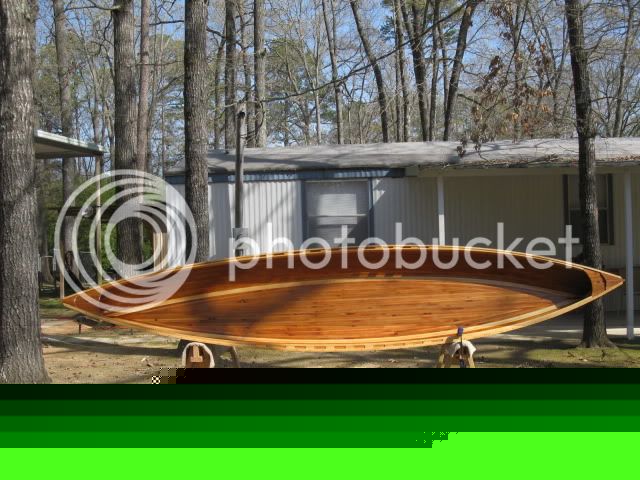

Man O' Man, that sure turned out pretty. How do you get away with no ribs or thwarts? To get the rounded chine, did you sand through the sides into that chine log inside or was that put in after. I wish you had some photos of the stations and strongback set-up. Really nice way you did that inwale tapering to nothing.
Thanks for all the compliments. :D
Lots of questions so bear with me.
captindoug
I don't know for sure if I have "gotten away without ribs or thwarts". There is some flex to the sides. The cap rail over the gunnel ,side, and edge of the inwale stiffened the sides a lot. A few trips will tell me if it is "strong enough" as is. I belive it is. If not there are several ways to strengthen the sides or floor if needed.
There is no chine log. I think what you see are the two cypress highlight strips in the floor. The forms are rounded over where the sides and bottom meet (chine) and the strips are clamped and rolled around them. The strips are then sanded over smooth with the belt sander on the outside. A disk sanding pad on a drill and lots of hand sanding shaped the inside radius.
Sorry I don't have a picture of the stations at this time.
Mick
1. 13 stations, one foot apart.
2. 2.5" at the bow, 1.5" at the stern
3. I used a 4" diameter circle templet. That would be a 2" radius, correct? It tapered to zero at each end.

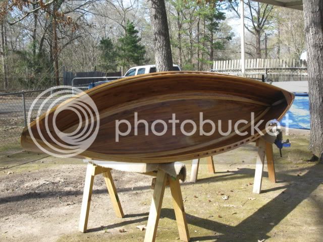

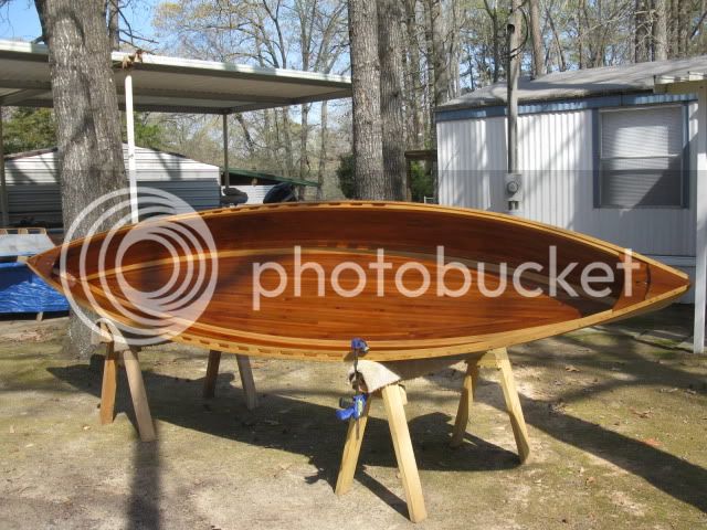

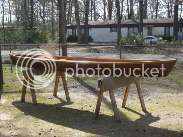

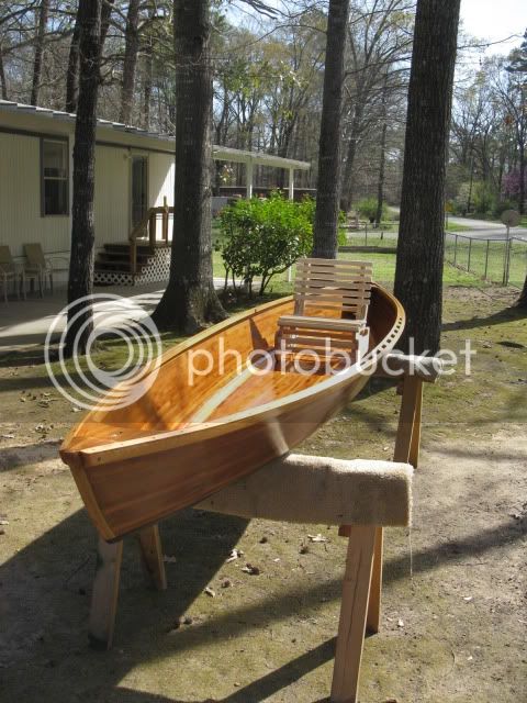

This is a disclaimer; The seat pictured is owned by swampwood. It was only used by me to enhance the apearance of my boat. :wink: :) I had the boat weighed today on the boat weighing scales and certified by the official weighmaster :wink: Keith Felders at 45lbs. I wanted a lighter boat but didn't expect that much reduction. I am very pleased. :D Thanks again to swampwood and keith and seedtick.

That first picture really shows the furniture quality of this boat. May I suggest a glass top and put it in front of your sofa? :p
The other two pictures show it being held up with a clamp. Seedtick and friend Kieth have a set of fingers they use for that , you may have been able to borrow? :lol: :lol:
Richard
