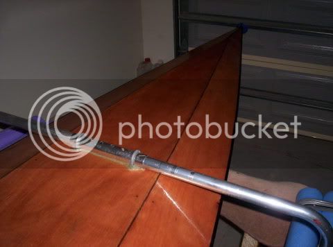

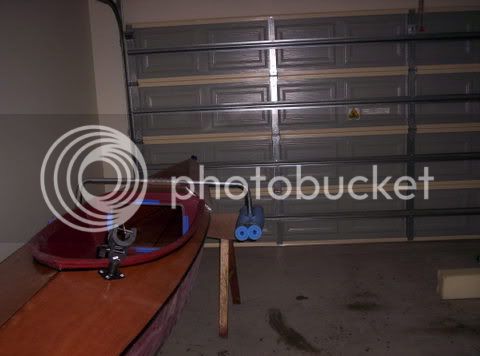

Anyhow got to thinking it would be nice to be able to stand up and stretch, and/or fish standing up when I felt like a change of body position. So I put my thinking head on and came up with this. It's by no means a final draught, and if it doesn't pan out then I'll have four little holes to fill in, where the Ubolts are.
The whole thing cost less than $10 'cos it's made from various bits of Treasure I had lying around. You know the stuff that might come in handy one day. Pool noodles cost $4 for three, unfortunately three different and decidedly crappy colours. Aluminium bits are from a Walking frame I found in a second hand shop for $8! Couldn't leave it in the shop it must have been really worth $50 second hand. It had been a fully height adjustable frame. The aluminium is very thin walled but I spose has to be strong on account of yer do get some really heavy folks resting on them.
It's all deployable while sitting in the boat and "unployable" (that's one of my words) also whilst sitting in the boat.
Only thing that could rust are the springs that hold the brass buttons out. Am sure I can find replacements for them... or make some.
The best part of it is the weight, or lack thereof. The whole thing comes in at 650g. Thats 1.43lbs!
If it doesn't work I've wasted a coupla hours. I think it will and will let you know the outcome.
Overally width is 48" and the whole thing is fully-take-apartable. The centre tube is sitting on a bed of silastic.

LMAO Jack, well I painted and put pointy ends on them now, so at least if I end up wet I'll be doing so with a bit of style :) On reading Joey's
gadgets, gizmos, time and labor saving devices. This might've been better posted there.
John, that does qualify as a great gadget. I'm thinking it's the best of both worlds-- a nice, narrow hull for speed and a wide platform when you get to the fishing hole. I give it 5 stars!
PS: Like the new words, too---------"unployable" and "fully-take-apartable". You do have a way with the words. :wink: :)

Hmm, doesn't having it bolted down create stress on that one part of the wood? I think that's why the pacific islanders lashed everything, so that the whole unit could bend and sway as needed while remaining strong.
john the pom
Jul 30, 2007
345
Queensland
Hey guys, thanks for the interest. Have considered a third tube, but as a skinny little bugger at 145lbs I shouldn't need it. If I do then I'll stick one on. Would only consider using this in the flattest of water and not whilst doing aerobics. I reckon anything other than cautious casting and fishing could possibly rip the back deck open, though it's very well re-inforced underneath, and is "Floating" on a bed of silastic which will allow some movement. I have already stood up in the Laker without this gizmo, granted in very shallow water and not for long. It can be done but wouldn't advise it. All I'm looking for is an aid to occasional use to help me stand without falling over. Then again I could now add a coupla sails hmmm... It weighs next to nothing and breaks down small enough to hide. If I thought any great strain was being put on the deck I'd scrap it. Its as much an experiment in cheapskatedness as anything. On the other hand if I found particularly useful I would consider really beefing up the area and prettying it up a bit.
John, you could maybe attach stiff rubber bumpers to the cross tube right over the gunnels and that would take some of the strain off of the center attachment point.
