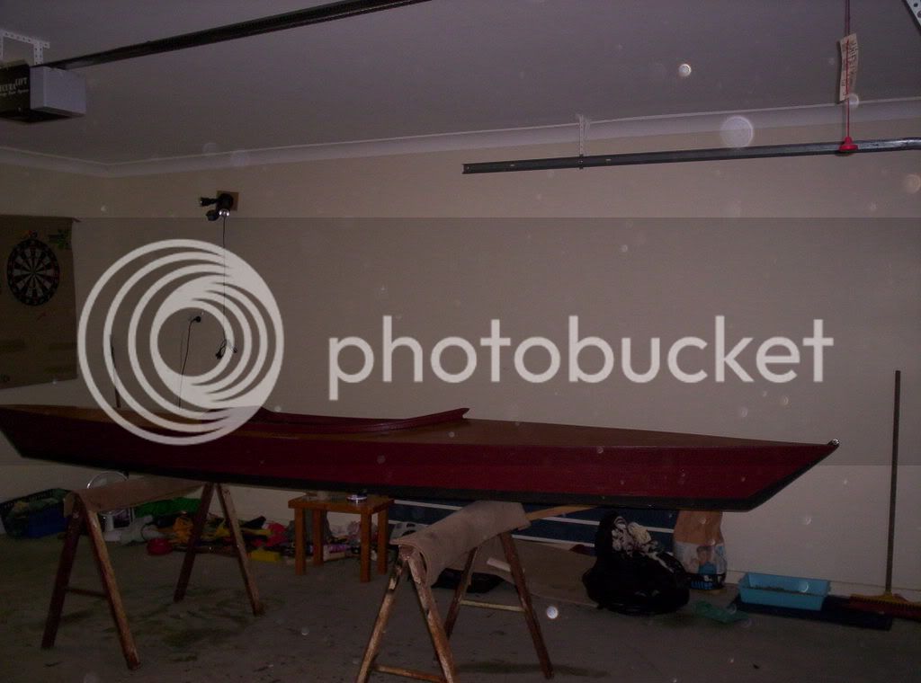

I've been away for a while, but I'm back. Ok almost finished now and have to say that it wasn't until the final coat of epoxy on the deck that I actually "got it". I'd been trying to use brushes, cos that's what I thought was used. I tried the squeegee thing but it didn't work for me. I ended up using a firm sponge, the cheap and nasty kind, not on a roller though they were actually from a roller. I found I could move and manipulate the epoxy to where I wanted it to be, and get it as a nice thin coat. I have used way too much epoxy on this kayak, way more than I could have got away with. The finish isn't as I'd like it but it is way adequate for a first build. Importantly I "got it" for any future builds!
I have temporarily installed the bulkheads with silastic, which will easily come out with a sharp knife. Am pretty sure I'll replace the rear bulkhead and make a cover/hatch that will double as a backrest and move the front bulkhead back, unless that space proves useful as space in its own right. Haven't installed any permanent seat, I'll play with seat location on the water and use cushions or something till I decide where and what I need. For the same reason I haven't installed any hatches, though I'm sure they will be in the bulkheads... Ok that might change, I don't know yet.
I need three or so coats of varnish on the deck and am installing braces next few days hopefully Easter weekend should see a launch.
I initially installed a coaming as per plans but removed it on account of I could. Not saying the one I ended up with is better but I wanted to do it this way.
The boat should be considerably lower than Mick/Robin's because I took a bit off the sides (bout 3/4") because I wasn't happy with the bond at that place. Then I lowered the foredeck deliberately, again no problem with the plans, just my preference.
My thoughts overall on the build: I made things hard for myself by not looking for the correct way to apply epoxy to the outside of the kayak, and didn't pay attention enough to the process required. I have to admit I got to the stage where I lost faith/interest for a while. That coupled with a quite extreme physical reaction to the epoxy. Mebbe 'cos I used cheap stuff I dunno, perhaps I'm just more sensitive than most.
The outcome: I'm stoked with myself for sticking with a project and learning something new. I now own a kayak that cost a fraction of what the equivalent bought one would have cost. I'm sure if this thing is half as good as Mick claims I'll be thrilled to bits with it. :)

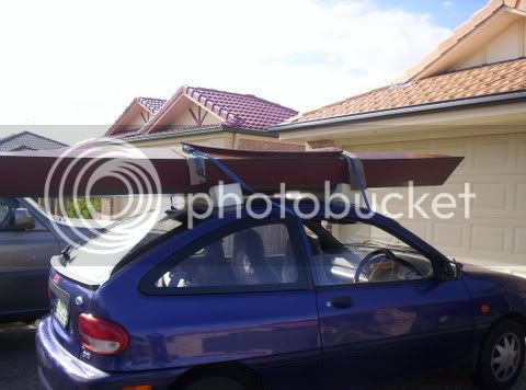

Jus spent two hours uploading six pics to photobucket and only two of them arrived there. This first one looks like a really scarey way to load a kayak on top of a very small car but I can assure you it was as solid as a rock and I won't hesitate to take it on the highway @ 100kph, that's 60mph. all the tension comes from the foam. The foam will not slide, too much friction going on there. The boat can't move backward or forward for the coaming.

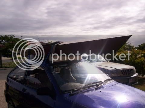

Finally
And a bit more detail on the tie down (bet some of you guys are having a fit looking at this tie down set up :D
