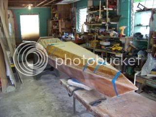

Lousy weather does only one thing for me. LETS ME WORK ON MY BOAT so I did get some done this week.
[/img]
This the inside of the bow section. This will be covered with a deck
[/img]

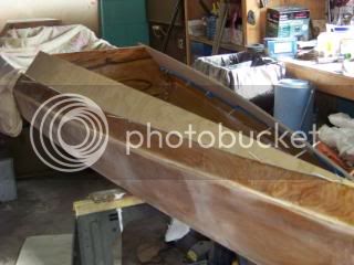

The rear deck is on and I did get it welded in place. Had some diffeculty getting the sides to align correctly so I had to improvise with my knifes to hold them in place.

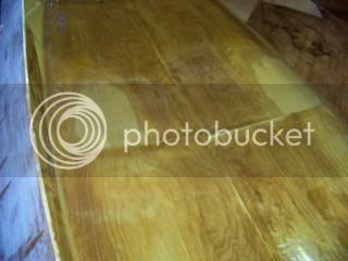

This would be the inside of the cockpit area. It still needs another coat of epoxy.

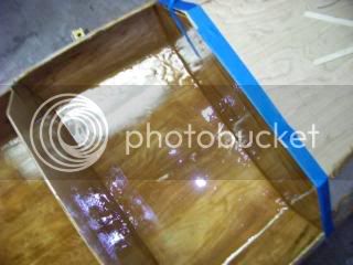

This is the indide of the cooler area, I think it is finished I just have to put the boarder around the outside and the bulkheads.

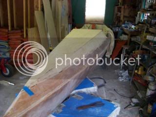

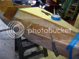

Well still have bad weather so I am still getting time to work on the boat. Here is some of the last day or so.
Starting to put the front deck on .Here is the bow end .

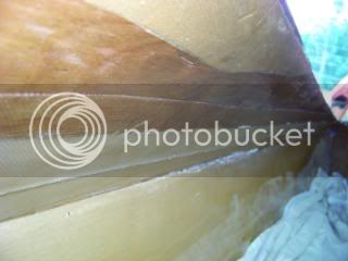

I did put 1 layer of 6 oz. glass on the inside seam. Just for strength.

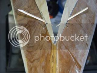

This I did before setting the top deck I asked Val if she would do it from the inside with a flashlight I thought she was gonna fall for it till she asked. How am I gonna get back out.
I told her I plan on cuttin hatches in the deck. It will only be a couple days.
No dice!!!!

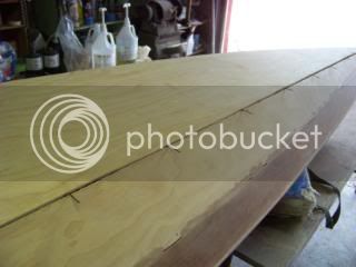

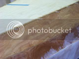

The top deck is on I used finish nails in the side of the wood to support it till the fillet cures.

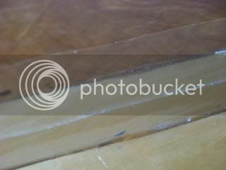

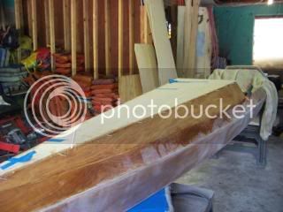

So here is a pic of the total boat so far

I know you know what you are doing but I just can't get use to that high of a deck on a boat. If you pack it at it's max when paddling and camping you will have everything in there including your truck. "O"oop's one thing missing .... VAL but she was smart enough not to crawl up in there to help you. If she would of , I would not want to be in Florida or any state surrounding it when she got out and I think New Jersey might of been to close for you to hide in. :wink:
I have to ask this ... When your ice chest is in the boat is the top of it at the same height as the decking ????? If it is then I am following your thought , after remembering the picture of Ron in his TV.

PS. If the nails get stuck in the epoxy put a soldering iron to the end of them for a sec or two and then when warm pull them out , use pliers when doing that. :roll:

Ron The rear hatch will be 21 inches and the front will about 35. I planned on taken the hatch down over the tumble home addition the I have on it about 2.5 inches. this will give me plenty of open area to put my larger gear in. And it will also the front one any way Will be large enough my grandaughter will be able to sit in the hatch hole. I plan on reenforcing around the hole for the seal so I figure she can ride in it without the lid on. I am building her her own seat like the one chuck designed. I will just be making it small enough for her.
The deck hieght is about 1.5 inches lower the the top of my cooler. I figure if nothin else if my legs need a strech I can sit on the cooler and paddle fer awhile. I am also creating a lid for that area so I can use it for a live well if I ain't got my cooler in the hole.
