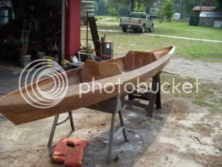

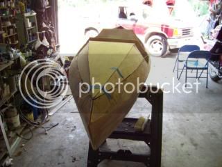

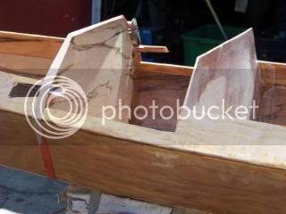

I had some more time to work on the Piroque. Here are some of the pics.

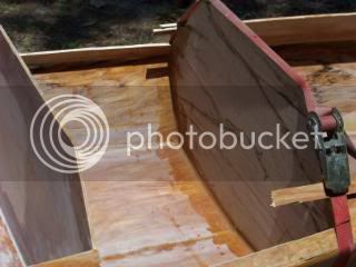

After This pic I had to start the cutting of the sides. It took a little time to figure just how big to cut the sides but I did get it to fit.
The added bulk head is going to add stability to the v bottom. ( I Hope) I found that the slight V when the boat was setting on the saw horses seemed to bow up.
But I dont ,think it will be a problem once I glass the outside.
As ya can see I am new at this boat buildin thing but It is comin along Ok.
I think it will be just the right boat fer me.
I did move the bulkheads alittle to give me leg room from the measurments I got for you Ron. I ended up with 47.5 inches between them.

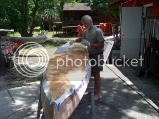

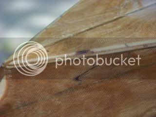

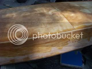

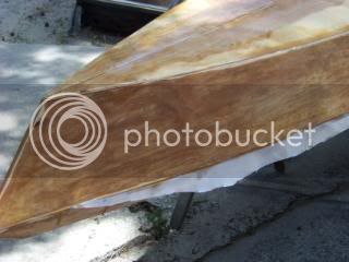

Well it took longer than I figured to get back on the TV. But here are so pics of my progress.
Here I put the mat on the main bottom. I have over laped it to give more protection to the areas that I know I will be banging against things.
I used plastic trowles to lay out the epoxy. It seemed to work good fer me.
[/img]
Atfer putting the epoxy I had glass down over the edge about 2 inches
[/img]

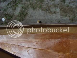

Waited for the epoxy to cure just past being sticky then comes the side panels
[/img]
Once again I overlapped the panels of glass to give me the extra thickness I wanted.
[/img]
[/img]
This gives me 2 thicknesses of glass on all edges that I will ( as Chuck has seen) be bashing into things in the river.
The bow and the rear end have 3 layers just in case

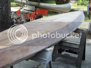

[/img]
[/img]
Then I got to sand it so as to make smooth. I feel like the kid in the karate kid films. EPOXY ON EPOXY OFF
But it is a soothing way to get frustrations out. I will be busy again for a while but will if the rain lets up be back at it soon.

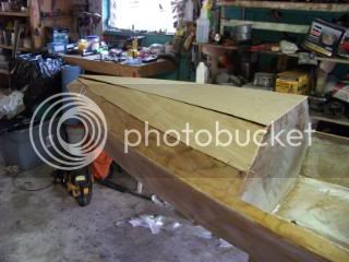

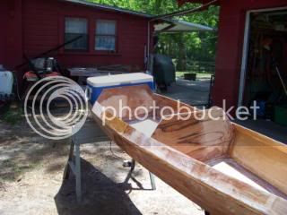

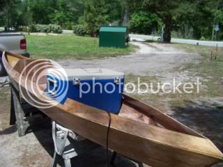

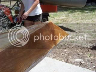

Well I got some time to work on the boat this week end. I have the back deck cut and in place. I will be weldin it on today so it is dry in the morning.
Here is a couple pics.
This before I trimmed the top deck. Next is after trimmin.

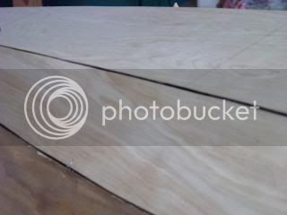

Need to get the seam a little cleaner then do the welds. I ended up beveling the top deck to fit in closer.
I used my sander to get the edge beveled.
Looks nasty up close but it will fit tighter and the fillet will clean the look.

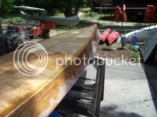

On the lighter side , have you increased the height of the decking ? It sure looks high or is it just the picture.?
Going to put hatches in it for some dry storage ?
