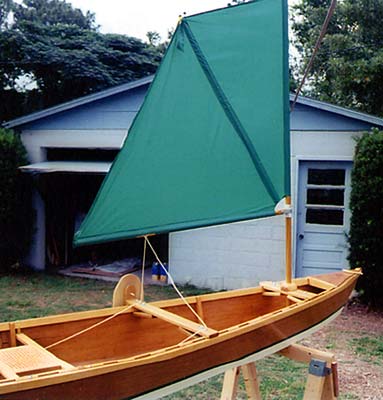

This is likely a dumb question, but, does anyone ever put a sail on a pirogue? You cover a fair amount of open water on Lake Verrett (sp?), and it could be handy.
About 12 years ago I made one ( pirogue ) rigged for sailing along with a canoe.
Jack before you ask , here is how I made everything for sailing. ( pdf file ) http://www.unclejohns.com/boat/sail/sail.pdf
For the article and all the pictures.... http://www.unclejohns.com/boat/littleton/Default.htm
Plus if you go to this http://www.unclejohns.com/boat/photos.htm and scroll threw the pages you will see all sorts of sails on different pirogues.

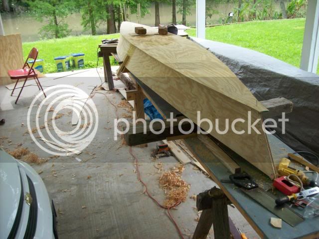

Beekeeper asked me for an estimated weight on the pirogue. Not much there yet but I have a "sort of" weight for the boat.
The two sides with : 1x12 heavy pine center form with a 2x4x12" piece of wet press. treat. yellow pine on each side, two hulking 4" C clamps to hold the form, six 1" spring clamps and 20 ft of 1/4" rope to wrap the ends......35 lbs. Lose all the extra stuff and add back on : bottom, about 10-20 lbs of chines, gunnels and breast hooks, glue, nails and paint....... I gotta figure right about 50 lbs. I would be overjoyed with that weight.
Not too much progress, Jack. Cut, sanded and attached the chine and stems onto one side. The other chine should go on tomorrow and maybe put it back on the form and start fitting the bottom Sunday or Monday.
One more spec. The stems were cut to 42 degrees.... a little sharper angle than keith and seedtics pirogues, but quite a bit bigger angle than the 30 degree stem angle of the fir marine plywood pirogue I made a few years back. This is going to be a fishing boat and I wanted a little fuller bottom shape.
Chines are done and the pirogue is back on the form looking like a boat. I flattened and leveled the chines and fitted the bottom. I'll use one splice a foot behind the paddler.
The rocker is more than I expected ( almost 2" -- front and back) . The side panels didn't bend the same way with the chines as without. No problem. It should perform well enough for short fishing trips.
Did the beam width of the sides also change? What is it now?
Mike, I ended up cutting some off of the bow height which shortened the sides by about an inch. I figured bending the sides to shape shortened the boat about 6". But, this boat only has a 22" bottom. Wider bottoms will shorten the final length even more.
JD, the beam width is 31 and 3/4". I can't say anything changed because the center form held everything true. I just think the added stiffness of the chines changed the way the sides bent.
The sideview shape of the bottom did not come out as expected. Just a bit more rocker than I wanted and the bottom doesn't have a smooth arc out towards the stems. I tried to correct it before the bottom went on by pulling the sides in and out but no luck.
I tried to go more towards the heavily flaired marsh pirogue style and there is a bit more of a learning curve to that design. No problem. She'll do fine for short fishing trips and pond hopping. I have less than 60 bucks in her and all I need is a few trim pieces and paint. A lot of bang for the buck.

Beam width sounds about right, and I doubt if you will be disapointed with 2" of rocker. What angle did you cut the chine logs?
I also had issues with getting the dimensons I wanted. If you have plans or a pattern attaching the chine logs to the sides first works fine. I find attaching them to the floor first, after setting it to the rocker and shape I want works best, when not using plans. When you build the next one you can use this one as a pattern and tweek it to what you want.
Don't worry about overlooking details because you were building too fast. I build realy slow and still over look things. :roll: Just keep reminding yourself, "What is time to a boat?" :lol:
Bee, I attached the chines to the sides before assembly. Needed 6 hands for that job. :roll: I cut the tops of the chines at 30 degrees to keep water from collecting there. The bottoms I just extended down past the sides by a quarter inch and I planed everything flat and level after assembly.
Too late for this build, but for your next one, draw the arc of the bottom of the side on a 2 X 12. Attach the chine to the 2 X12 with small finishing nails, following the arc that you drew. Glue and nail the side to the chine. When the glue sets up, carefully pry the side and chine away from the 2 X 12. Pull thru the finishing nails.

Tic, I had seen a reference to that tip in one of y'all builds. I managed with a few clamps and a brad nailer :shock: as I went along. Shot it with the brad nailer and came right back with proper fasteners. The cedar bent fairly easily. Worked a treat---- as Mic would say.
Seedtick, I did like y'all do and cut the chines with a falling angle on top so water won't build up on them. Slick......and looks elegant too.
