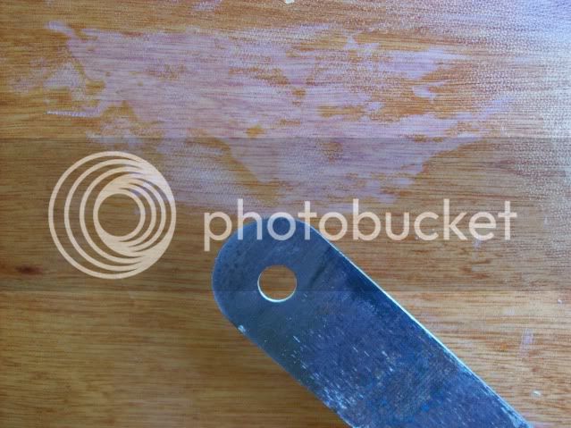

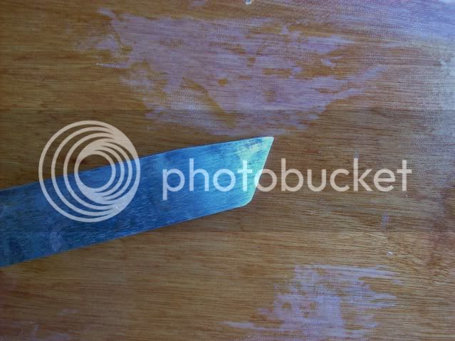

The drips are not quite hard enough to sand so I broke out my trusty bow scraper. It's a industrial hacksaw blade with the edges ground to a perfect 90 degree angle and a small burr burnished into them. I've made a bunch of bows with it and it does a lot of things better and faster than sandpaper.
The angled end is good for truing up larger areas. The rounded end is for more focused scraping. With the rounded end, I can scrape one wayward brush hair without touching the surrounding surface. Try that with sandpaper. It might sound crazy, but for finish epoxy work, I would rather do without a random orbit sander than do without my scraper.

I "snuck" into the shop again to do a bit more scraping. I had a couple of places where I applied the epoxy as it was just starting to get tacky and had a few big sags. Sanding was slow and tedious and not going anywhere. The scraper took care of it in about a minute--dead smooth with almost no shiny spots showing.
