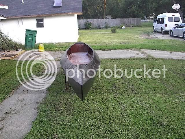

Well the boat is a little different and Mick yea the sides are bull stout
(was in steel business to long) can't have no flimsy boat

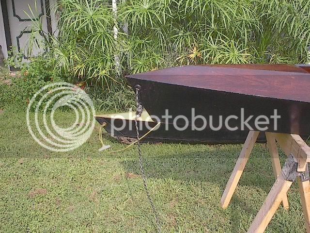

Cubby holes should be good for rods arrows and a bow and when put in bulkheads with hatches there will be a little more storage still need to do that. then my door knob rope holes and then down to putting on finish.

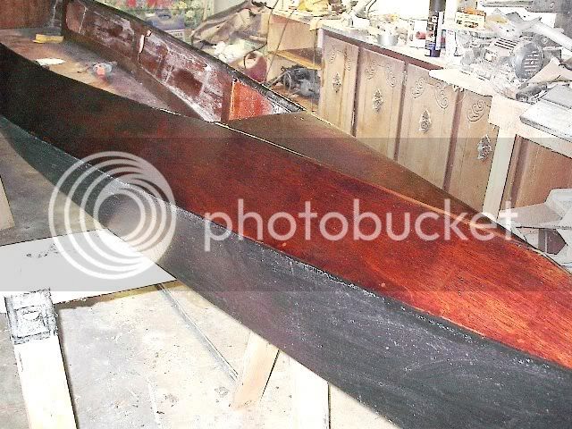

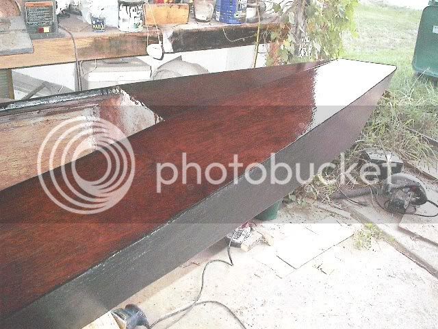

was putting glass on tumblehomes and could not get the white spots out of the finish
I finally threw up my hands grabbed the sander took it down to bare wood tonight got my first coat back on it over glass now it looks right
Oh well sometime s@@@ happens.

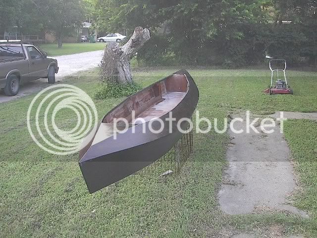

I am getting closer couple more coats of glass on top and then start paddling.
The boat is going to be pretty light.
I will weigh it when get the last coats on
Finally got the look I wanted on the tumble homes

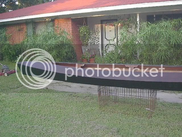

Ron, I love the way she came out. You do great work. How about some demensions on her? The sidewalls look a bit shallow but with the tumblehome that should work good. I am waiting patiently for your first wetting. What kind of seat are you planning on using? The wood is real nice is it mahogany?

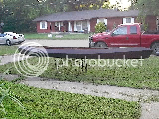

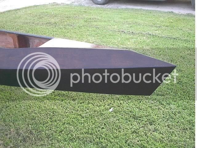

The wood is just cheap laun
at widest point on bottom
28.5
Widest at tumble home is 34
15ft 7 inches long and the sides are 11 inches high in center
bottom side pieces are 6 1/2 inches high
1 inch of rocker on the front 2 on the back
the seats will be the one I built for the freedom that unfold and use as a lawn chair need to build a couple more.
On the dark wood I will try to get some good pics and you are going to laugh at how I got that finish I used ritz die like you die clothes with to stain it black then wiped it down with water and a rag.

I am finaly getting the look I wanted on the tumble homes
A little sanding and clean up and one more coat on tumble homes and one more on bottom carry handles should be ready to hit the water

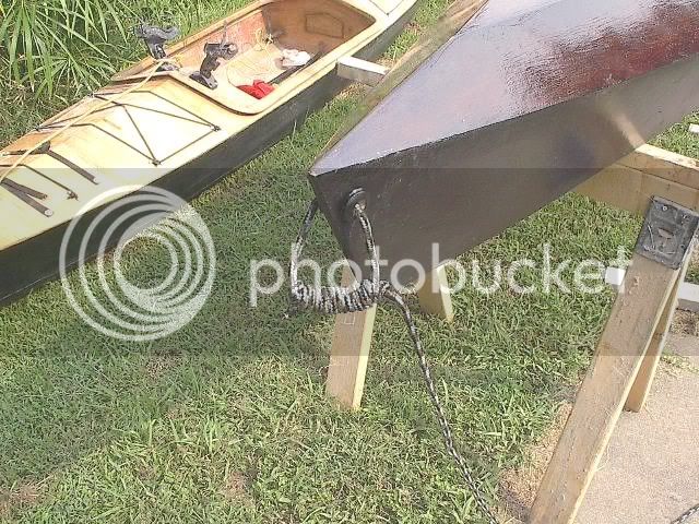

Oh I have new little trick on carrying handles think y'all will like.
Carrying handle
I saw something similar on some wooden boxes decided to try it.
Works really well quite light and very comfortable on the hands
I made this one a little wide but all I have to do is retie it.
