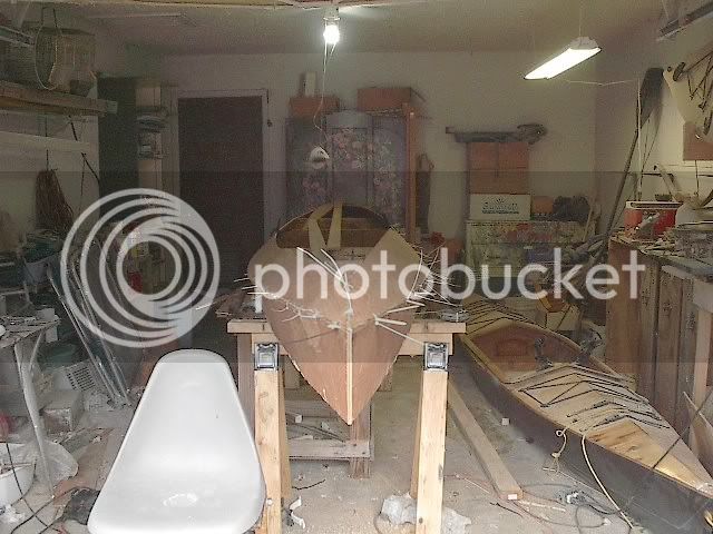

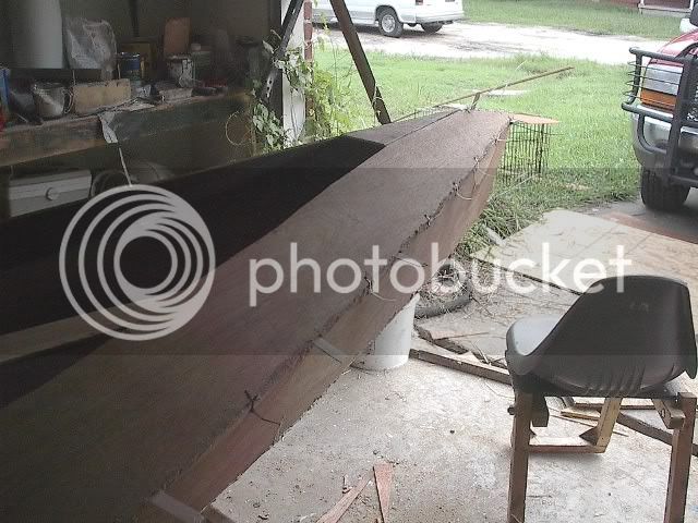

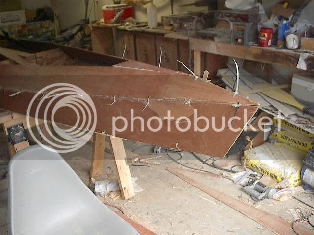

Well a little more done on the perow
Tumblehomes are on
stiched and glued

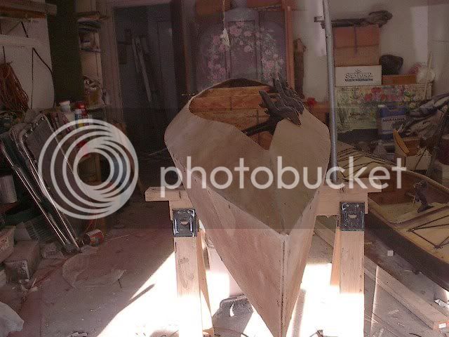

I started fitting front deck
a couple more views
another
I like the way it is turning out so far

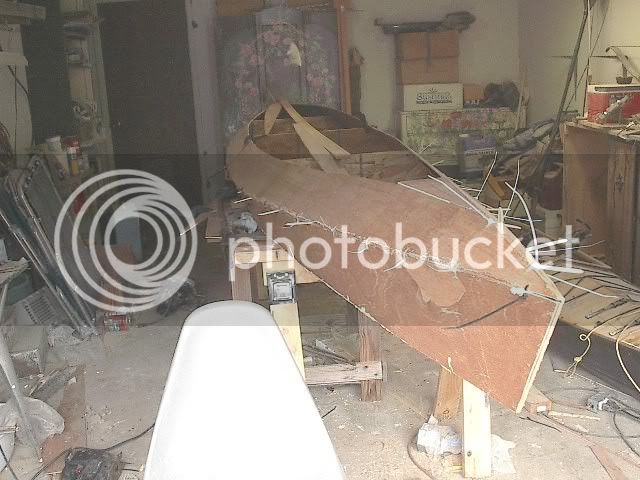

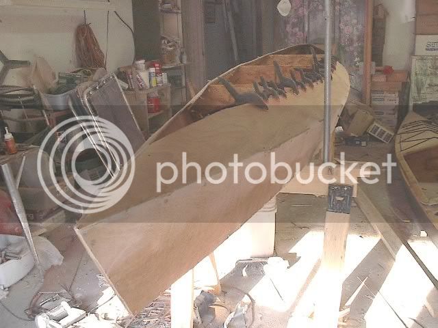

Little more done
Have the filet's run on the rest of the tumble homes dang I had rather be sanding than doing the outside hull
Started running the combing
a look from another angle
dats all folks
for today anyway
Jack the pic is realy sort of misleading
The sides are 11 inches including the tumble homes thats at center line
but it should help in the wind.

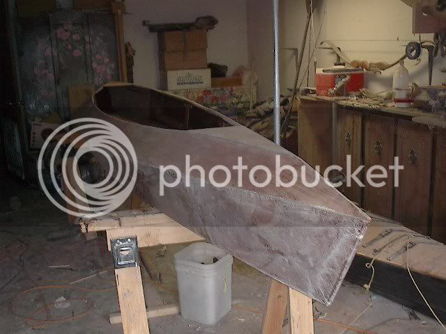

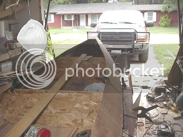

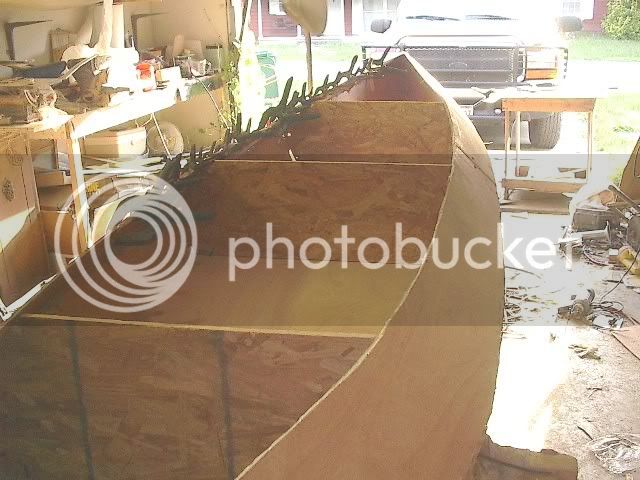

perow is coming along
outsides glassed , glassing inside now with just tape on seams and saturating floor and sides , decks are on , waiting on hatch covers for front and back closed in areas
Later

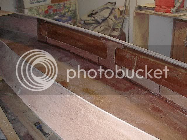

I had to take a few days off but am back working on the hot air perow

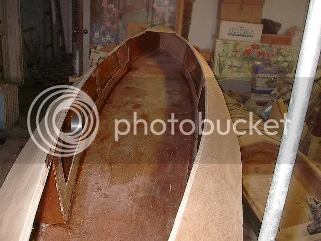

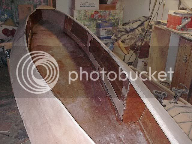

finished the combing
i got to thinking about carrying rods and other play pretties so I decided to build some cubby holes on each side
they
also brace the sides and should keep me centered if I am standing. Got on both decks everything sanded out
all holes filled and sanded There is going to be a lot of room in this boat
start glassing the top tomorrow I hope its ready for the water this weekend
Rat, I like the looks of that. Thoughts here.
Cubby holes will need drains on case water gets splashed in there.
You can make a nice map compartment by first running two pieces of thin plywood vertically down from your gunnels. These could be about 1"-2" wide, about 18"-24" apart, glued top & bottom, and drilled every 3" or so. Then you string light weight bungee (or nylon cord) from one to the other. Slip in maps etc. in behind them. This should be within easy reach of your seat.
You can hang rods or paddles from the areas there if you have several strips of hook & loop tape (velcro) screwed into the gunnel, and hanging down. Lengths from, say 6" to 12", according to what yu plan to store there. Lay a rod or paddle in one, fasten the strip up to the mating surface. Fasten other straps up to fully support the rod or paddle.
Heya Ron,
Some real good ideas here mate. I like your storage compartments each side. I reckon hey will strengthen the heck out of your boat too.
That real strong tumblehome panel looks the goods to me too.
