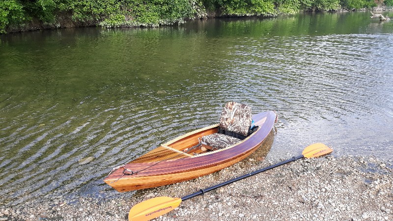

I have been fighting this picture off and on all day, here it is.Dont know where I was going wrong, but I lost all the fancy words I had typed. The short fat wuhan pirogue is slimed. if two small bream count. Handled about as expected, the long kayak padde stayed on the gravel bar, Make no mistake it is a small boat. I usually carry two poles ice chest and small tackle box. You'll notice the ice chest stayed home it will fit fine, just didn't want to croowd it up first trip. I used my 6"seat, it was ok but probably will fish with just the seat no platform. The biggest gain was loading and unlooading, it's handy enough to carry if needed. I think the Inverted V bottom is more stable,but didn't coast real well. Tracked ok. The river was too clean to eave a scum line, but feeling over the side, I'd guess the draft is about 4 inches. Next one will be 1.5 feet longer with less deck. This idea was a good compromise for a 77 year old geezer. I'll definitely do another one.
Good Fish'n,
Andy
Andy, decreasing your load is a good idea. Simpler is easier. And on the next boat, using less wood for decking and adding it for length is a good idea. A semi decked, solo canoe is an all around set of least-worst compromises all combined into one package.
Boats always look even better on the water.
Every boat is a compromise. Making those compromises fit your goals/criteria is the fun part of designing and building it your way. Sometimes we have to compromise our usage (leaving the ice chest) because of those changes. The more we require from a design the harder it is to be successful. Hence the next build.
Seems the farther from "normal" I drift the more I see why "normal/usually" is the way it is.
For Jack a solo canoe is a good/normal choice/compromise. In Louisiana a 12' pirogue for one person or a 14' one for two people is pretty much standard. Changes can be made to improve these boats to fit certain criteria better but some other feature/function will be compromised.
I think the boat is great. The light weight and short length will make it a great fishing boat.

Thanks to all who helped keep me on track during this build. We made it back "home" to Kansas. I'm guessing I'll try again asimilar boat a little longer and less deck,
after we get my better half squared away with medical stuff.
Good fish'n
Andy
"...a similar boat a little longer and less deck, ...." So, basically, you're heading in the direction of a + or - 12 foot pirogue/canoe type of boat. That's a good, solid, proven style of boat............for a good reason.........it does a lot of things really well.
