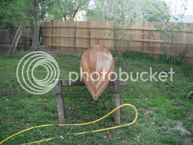

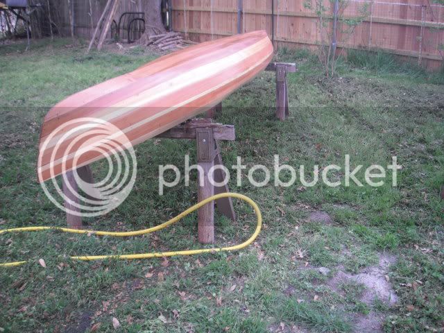

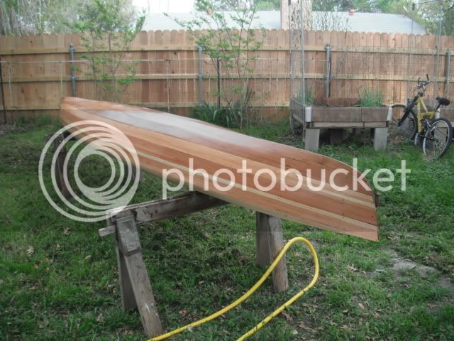

I got to wet the whole hull down today and I sure like her looks and lines.
Like Darrel says wetting her down all the way gives you and i deal of how she will look.
Be a few days before I can get back on her.

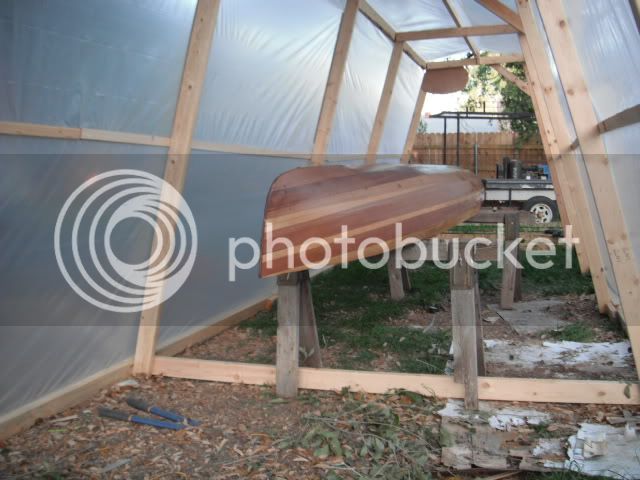

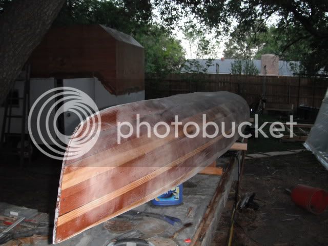

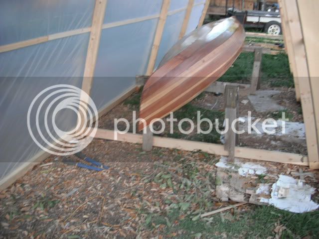

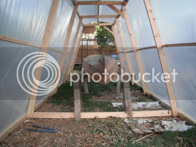

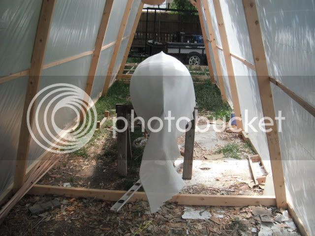

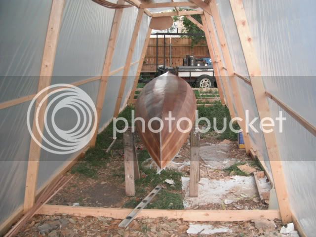

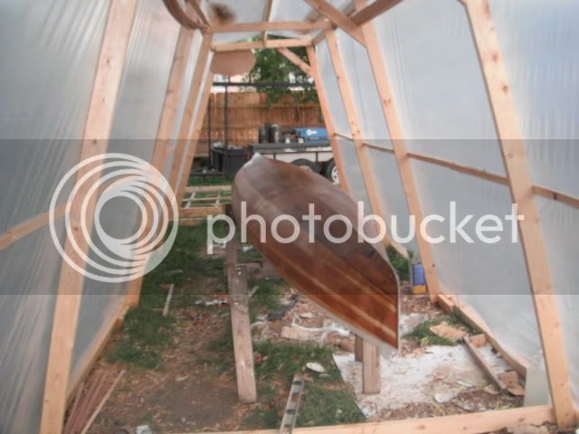

Well I have been stomping cussing and throwing a fit because its been to cold for the epoxy to set right and so much pollen in the air that if you had wet epoxy outside it would look like a green wooly worm in about 15 min.
Got off my backside and built a boat tunnel untill I can get my shop built. the plastic catches more heat so the epoxy worked really well today.
I put the Northwind in the tunnel and gave her a coat of epoxy to seal everything and have the color so I can start matching and filling the holes for the stitches.
Epoxy sure brings out the colors.
Nice idea, Ronnie; good thinking. Looks like a raised garden - growing a boat in a greenhouse.
With the ends open condensation shouldn't be a problem. If you close off the ends to build heat, dripping moisture may spot up new epoxy?
That has crossed my mind :lol: :lol:
Jack if you go back and look at the pic everything slopes , so even if I do seal it the moisture will run down the outside walls.
tx river rat said:
<SNIP> Jack if you go back and look at the pic everything slopes , so even if I do seal it the moisture will run down the outside walls.
Moisture has a way of finding a drip point, usually above the most dangerous point, and then dripping right there. It may be from where the plastic abuts the wooden framework.
Yep I have, in my steel fab shop we sometime had jobs that included the paint ,but they were small enough jobs they werent worth setting dipping vats up are were to big to dip so we threw up temp paint booths
Jack
I am sorry if I pulled your chain by disagreeing with you , I assure you it is nothing personal
Look at the pic and I will explain to you why it does what I said it will do, center board makes a v and plastic doesnt touch anything before it hits the sides, condensation forms on plastic most of the time and it is a clear shot to the outside. If you notice the top board on the side wall isnt put on the top it is nailed on the side, so there is no platform for condensation to form on now when you set it up you build in a slope to one end, that way if you do get any moisture on the wood it runs down until it hits the next upright and then runs down just like a tepee. It is a pretty simple gismo but more thought went into them than you think.
Just for the record I probably have constructed 25 of these in the 43 years I ran my steel fab shop
Well I cant take credit for this design, in the 70s on a job I was doing for the VA an old Italian gentleman showed me these structures and how to build them.
