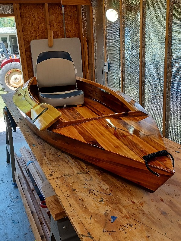

I wrote this post about two weeks ago, but somehow didn't get it past draft. This should be all you hear about this build until it goes fishing in Texas in December.
I’m calling this one done. Still needs bow and stern handles. I’ll have to take care of handles and putting it in the water on our next trip to Texas, ran out of time on this visit. Here are the specs:
Llength 9’ 10’’
Beam 35.5 inches
Cockpit 5’10”
Flare 26 degrees
Rocker bow 1”
Rocker stern 1”
weight 23.4#
The rocker and flare changed as I built, both got smaller in small increments. I need to study that some more.The tumble homes and rails (in whales) are stouter than any boat I’ve built. No support required. One other note, the cedar strips that don't follow the lines of the boat just don’t look as good as those boats that do… If I named boats, this one would be “ugly duckling” :).
I’ll finish this post with handling qualities and pictures of it on the water in December.

Final chapter for this build. It's been a while since I called this build finished,hopefully last post for this boat. Evangel Christian Academy in Shreveport, Junior Class is having a fund raiser, so when the raffle is complete she willl have a new home! Here she is dressed up for the trip, ready for the action next week!
1634
It looks very nice and should generate lots of attention.
Do you have any information about the raffle? I don't need another boat, but if somebody over Minden way would win it I might bet to see it on the water.
