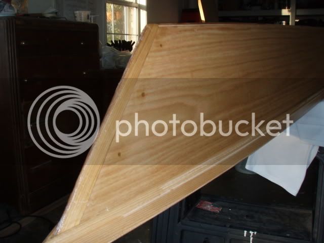

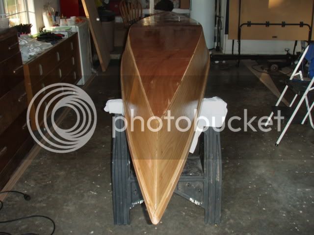

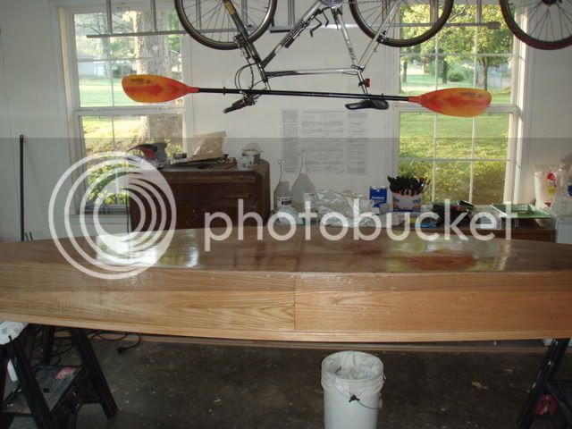

Well guys I have moved forward and missed some good photo opportunities because my wife had the camera with her on a trip to Louisville this weekend. I have saturated the inside, sanded and sanded some more the outside, saturated it as well, sanded again, cut and fit glass for the bottom. glassed the bottom and trimed the excess and here are the results.
I used a 9" foam roller cut in half for most of the work and a spreader for some small stuff and the edge were the glass met the rub rail. You might think I'm a little strange but after reading a lot of posts on this subject and learning from others, I found it to be no real trouble at all and dare I say almost enjoyable to do! I had a little trouble getting my overlap right on the stem and stern but added another piece last night to each during the second coat. I think it will need at least one more coat and then I can start the inside wich is I'm sure not as enjoyable.
I measured the glass left for the inside and I am going to be short so I'll need to order more from Larry. He sent me 8 yards I believe but I think 12 is what I needed. I will order some varnish while I'm at it.
Thanks for watching over my shoulder Guys!! :wink:
Chad
I hate to tell you this but I think all of us made a mistake in telling you about the process of building a boat..... In fact I know we made a mistake ... Yours is looking good like a pirogue should. We sure goofed up somewhere along the line , or you didn't listen to us. :lol: :lol: :lol:
Now the fun starts , the inside , but if you take your time it will come together. Yep it does take a little longer to do the inside since you are working against gravity and not with it.
I like to use the rollers on the flat areas and into the angles as far as I can ... then a (throw away) bristle brush to finish the joints , bow and stern.

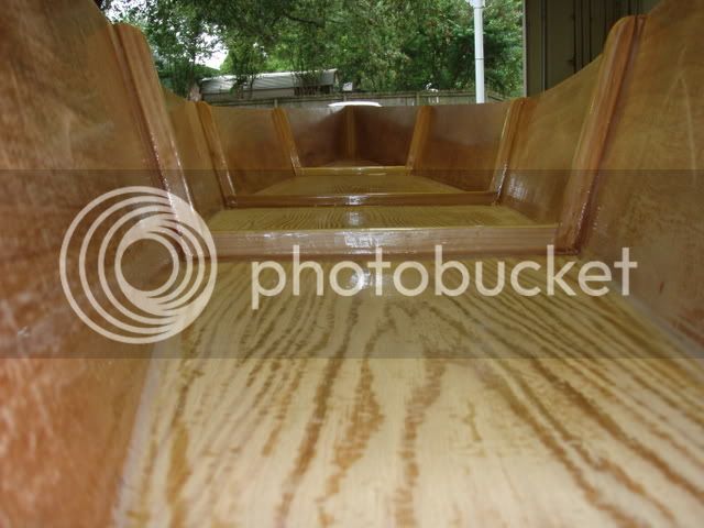

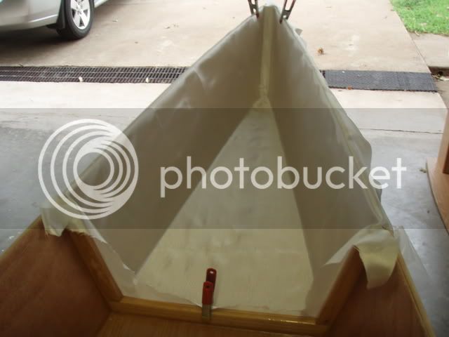

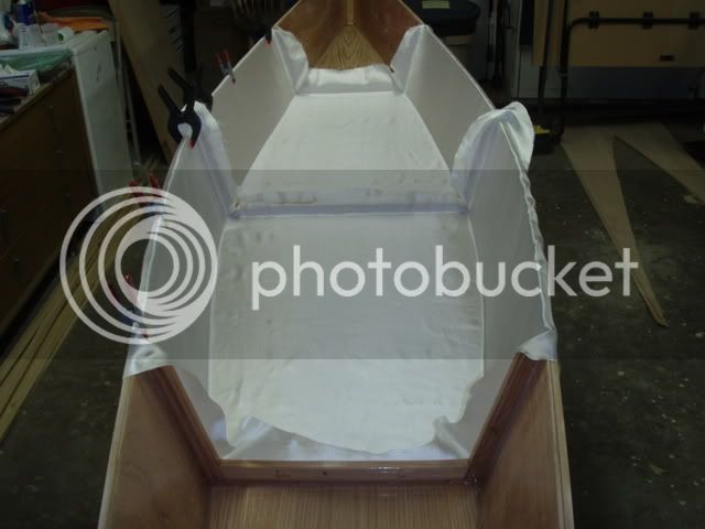

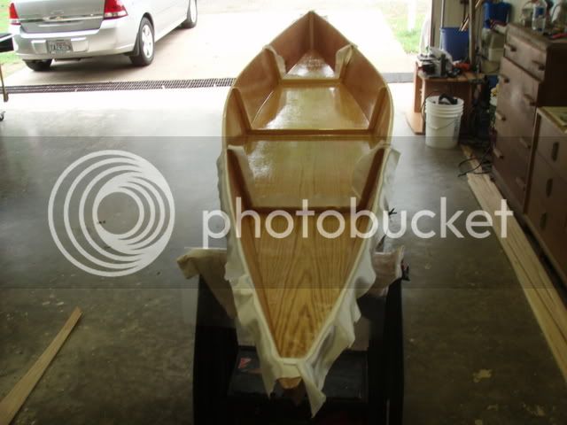

Here are the results of glassing the inside. I did it in two steps the two middle sections first yesterday before work and the bow and stern sections today. I'm starting to worry what I'll do when I'm done! Just kidding :lol: I'm sure I'll try to spend plenty of time out in her fishing and enjoying the water. Can't wait!
saturated and sanded
center, bow and stern sections waiting for epoxy
all glassed and waiting to trim excess on the bow and stern
Chad
You Sly Fox ... You banmbusled us into thinking you have never made a wood boat in the past ..... Yep sucked us in like the morning milk.... No one does work like that on the 1st try. Heck a lot of us (myself included ) does not do that good of a job after several wood boats , take Jack for example .... NO BAD IDEA , forget I said that he is still having problems with his cat getting epoxied to his boats. Actually I don't think he has a cat and it is just the gray hair from his beard. :lol:
Ya do good on building wood boats , a natural talent for it. :D Actually looking at your shop (working area ) I would say you are a perfectionist and as a Chief that is to be expected. My Hat is off to you.

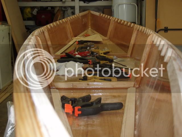

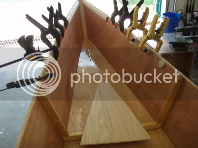

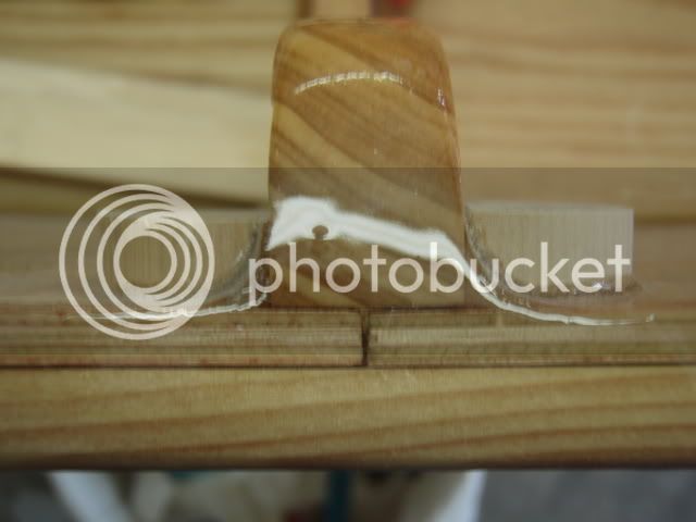

I got some quality time in on the pirogue this past week. I might have created a bit more work for myself with my idea to use a wooden dowel cut into small spacers instead of square stock but I like how it's coming out so far. Although it was a lot of sanding and fitting the different angles it will hopefully be woth it. I have also cut and dry fit the decks and all the
inwales as well as saturated them. It's getting closer all the time :D
lots of wooden coins (66 to be exact)
a detail shot

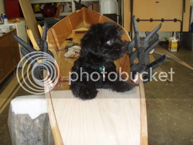

my first rider! This is Romeo my son and his girlfiends new pup. He is a Maltepoo and loves to play with my schnauzer. I was baby sitting.
