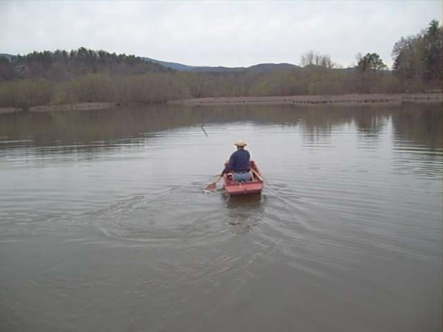

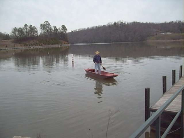

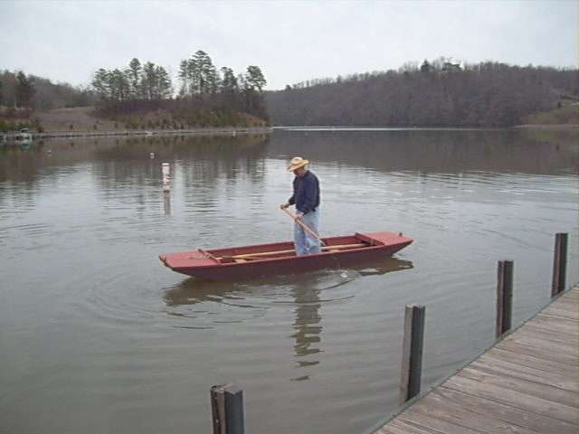

More pics...
I figured how to pick still images from the videos of the first trials.
As before, it feels pretty stable when standing after you find your balance.
She moves along fairly easily and responds to the paddle strokes. I didn't have a decent paddle for doing a J-stroke and had to keep switching sides to keep on track. I was fully expecting the boat to be slow turning due to the full keel strip, but not so.
The first impressions were good and overall I am happy with the results.
The real test is a proper day on the water........
