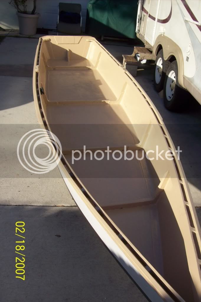

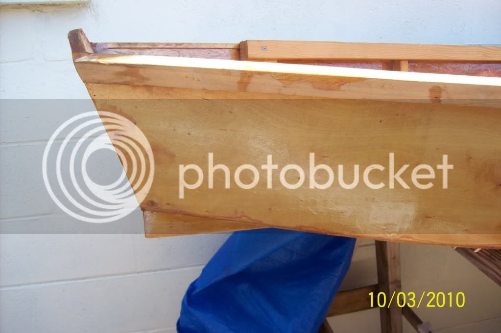

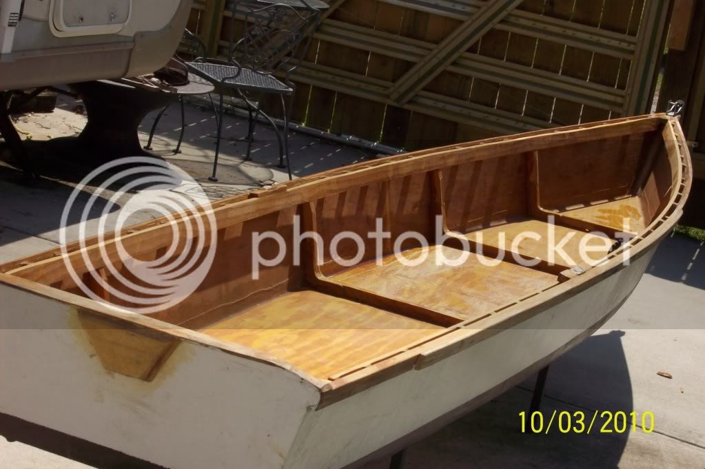

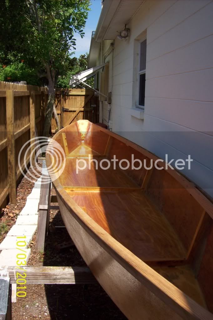

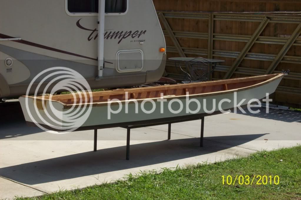

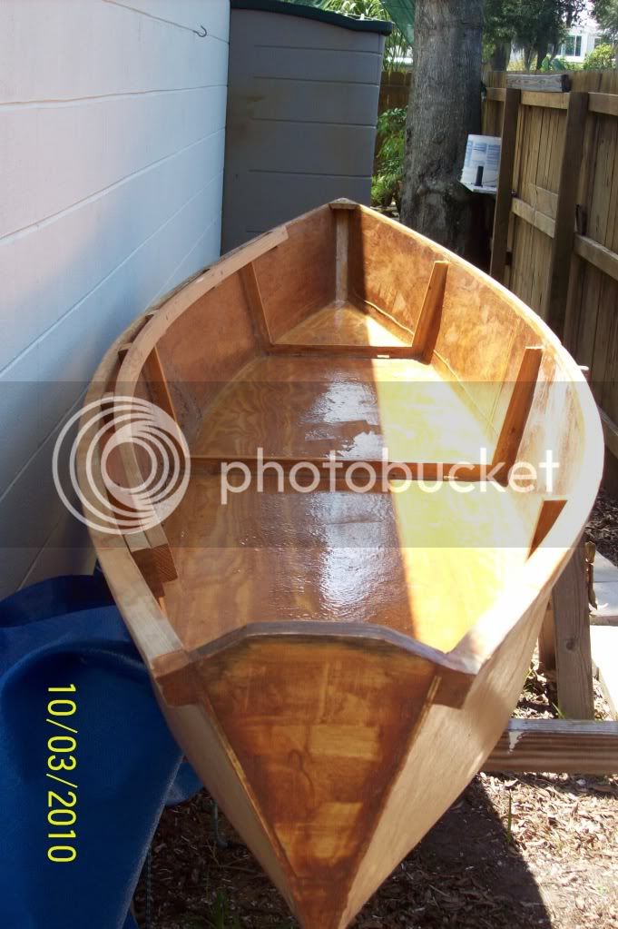

Did some re-modifications on the boy's pirogue. Cut the stern off and put in a small transom. I made it right at thirteen degrees, so we can put a electric trolling motor on it if we decide to go that way. An added plus is it nests real nice in my Bayou "lite" skiff. We are getting them ready for paint. We had to let the fresh cut cypress rub rails dry out before sealing them with paint or varnish.
will post pix soon

getting ready for paint

13 Degrees?
captaindoug said:
OLD Sparkey, Kayak Jack, Beekeeper....? No comments? Am I out of the loop? Come on guys, at least tell me you DON ' T like it. or not. Haven't been here for awhile, hope everyone is well. Regards to all, captaindoug
Your transom should work fine for a trolling motor and not create much turbulence when paddling. The bottom is still pointed. I like the trolling motor mounted on the front (pulling a chain) for better boat control while fishing. Not a problem for the pirogue. It works either direction. Just asking; Why 13 degrees?
The Standard Angle or Degree for the transom of a boat is 12 or 13 degrees.
Chuck.......
I didn't know about a standard. The two sets of planes I have call for 5 and 10 degrees. They are rated for out boards. It may be different for trolling motors. I am not saying 12 or 13 is wrong, just different from what I was familiar with.
"O" Well , the standard according to Mercury Outboards for there motors is the 12 or 13 degree. All of the boat builders around here , the same. Must be different in different necks of the woods around this country.
When I worked at Orlando Clipper ( back in the dark ages ) all the boats from the 12 to the 21 was set on the transoms from 12 to 13 degrees. Might of been since we used Mercury outboards for the motors and the inboard /outboard for the 21's.
My guess is that since it is the standard down here that is why he did the 13 degrees.
Remember ... The bracket that the motor sits on is thinner at the top then the bottom so when it is on the transom of the boat there is a wider part which is lower holding the motor in place and for it to push against.
Without that angle on the transom then the motor would be on an angle and not a 90 degree with the water.
Every OB motor I've ever seen is adjustable for angle of attack. But, having a "standard" angle to start with makes sense. Thanks.
Yep.. There is a little pin between the brackets that allows for adjustment , normally with it out one forward of the 90 degree angle with the foot of the motor and then back to normal with the pin in place and several more back. A good motor will even have a trolling adjustment and naturally a lock on the upper part to have the foot all the way out of the water.
Everything is according to the proper angle of the transom.

Hello fellas, thanks for the replies. The transom angle came about after an internet search. I can't remember exactly where, but as Chuck said, 12 to 13 degrees was quoted as the standard for outboard transoms.

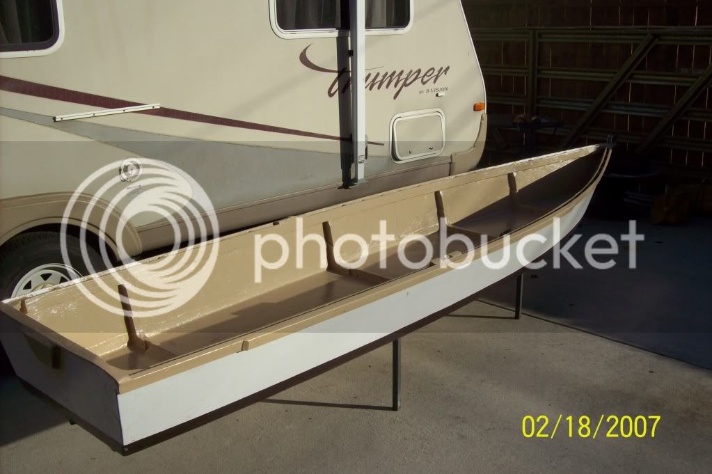

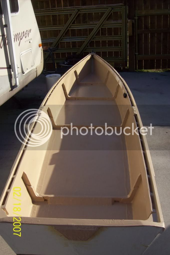

I guess I'm done with the Bayou Skiff "Lite". Painted the interior with some epoxy paint, Sandstone color, (light tan). seemed to cover well with one coat and it hid a lot of my construction "Holidays". The son and I had a grand plan this morning to go fishing with a local Kayak club in upper Tampa Bay, got up early to get there by 0600, went out to drizzle and increasing winds, went back in, checked the "puter" for latest weather, cold front arriving sooner than forecast.... The boy is not very experienced yet, so decided discretion was better than valor, and postponed.
