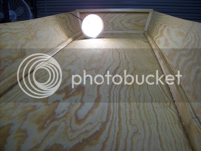

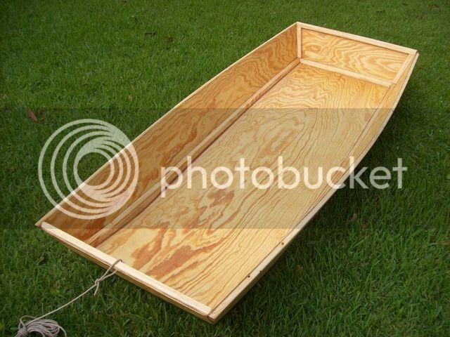

Check out this for convenience. I put on another coat on the outside, waited 10 minutes and wiped off any excess. I grabbed the just-finished sides and turned the boat right side up. I sanded the inside a bit more and then blew out the debris with air. I mixed 12 oz. of the finish and spent 15 minutes flooding the whole 12 oz. over the inside. Their were tiny bits of wood and dust that appeared from the cracks...........disaster for a varnish job. No problem with this method. The finish sunk in and left the wood bits loose on the surface.
This is 12 oz. of the "brew" soaked into the inside. No sheen yet, but you can tell it filled some of the grain. Probably another couple of coats and let her dry for a few days.

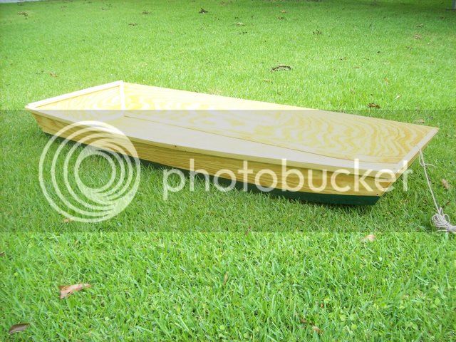

She's done. Just waiting for the finish to cure.
Specs: length - 8 ft. ....... max bottom width - 27 1/2" .......... max. beam - 36 1/2" front rake - 3 1/2" ......... rear rocker - 1" ............ weight - 39 lbs.

Not much more than a box with a little rake in the front. It might be just the ticket for the fishing I have planned.

Thanks, Bob. Well, I couldn't wait the extra day! I just put in the bayou behind the house for a quick trip. It floats nice and high. Pretty stable to stand up and move around in. I tried paddling with the bow up a bit.........not good. It weaved from side to side............slowly. I shifted my seat forward so the bow stem just cleared the water and the stern was just barely in the water. That was much better. It definitely will not be a 1 mile tripper, but should work fine for what I want it for.
I went back out for 20 minutes and experimented with seat height. Sitting on a kitty litter bucket, I was quite comfortable with a 12" seat height. MUCH better fishing position than in the kayak or pirogue. My initial impression is that I probably could have made the front rocker/rake a couple of inches larger and the rear rocker 1 " more. She'll do an easy walking speed, but hits a wall if you try to push any faster. She'll swap ends with one long sweep of the double paddle. Paddling forward, the bow bobs back and forth a few degrees............entirely manageable.
I brought it down to the water, boat in one hand and paddle and seat in the other. Can't get much better than that.
