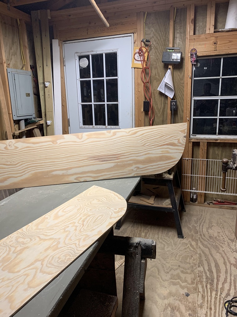

When I said " rounded stems" that's what I meant. I want the boat to have that old dugout pirogue feel. Never mind the man in the window. He's harmless.
That's why I'm doing the hybrid build. I guess it could be done, but a traditional type stem with that much curve sweeping into the bottom line might be a bit touchy. I'll pull the stems together with wire and epoxy and glass them in. The chines will take off from there. The chines allow me to forego a total glass job while still giving me strength. As I'm looking at the picture, I'm quite sure the bow height is going to be trimmed back a bit.

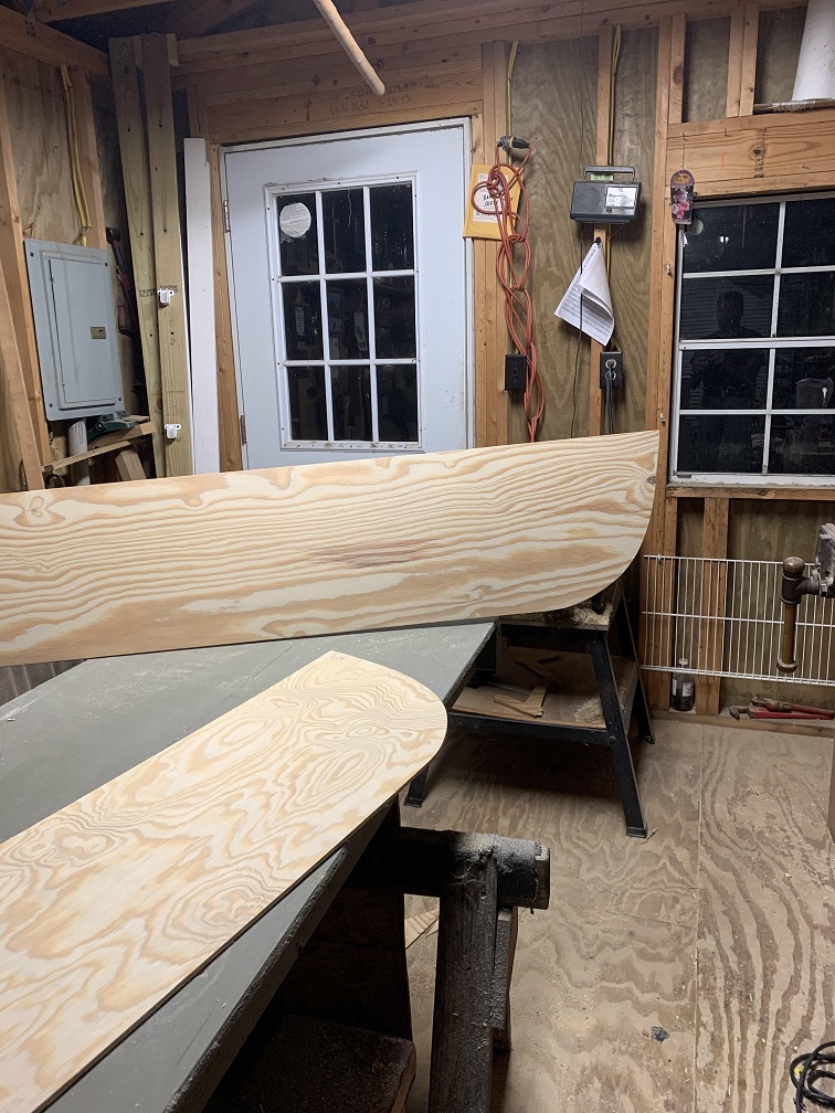

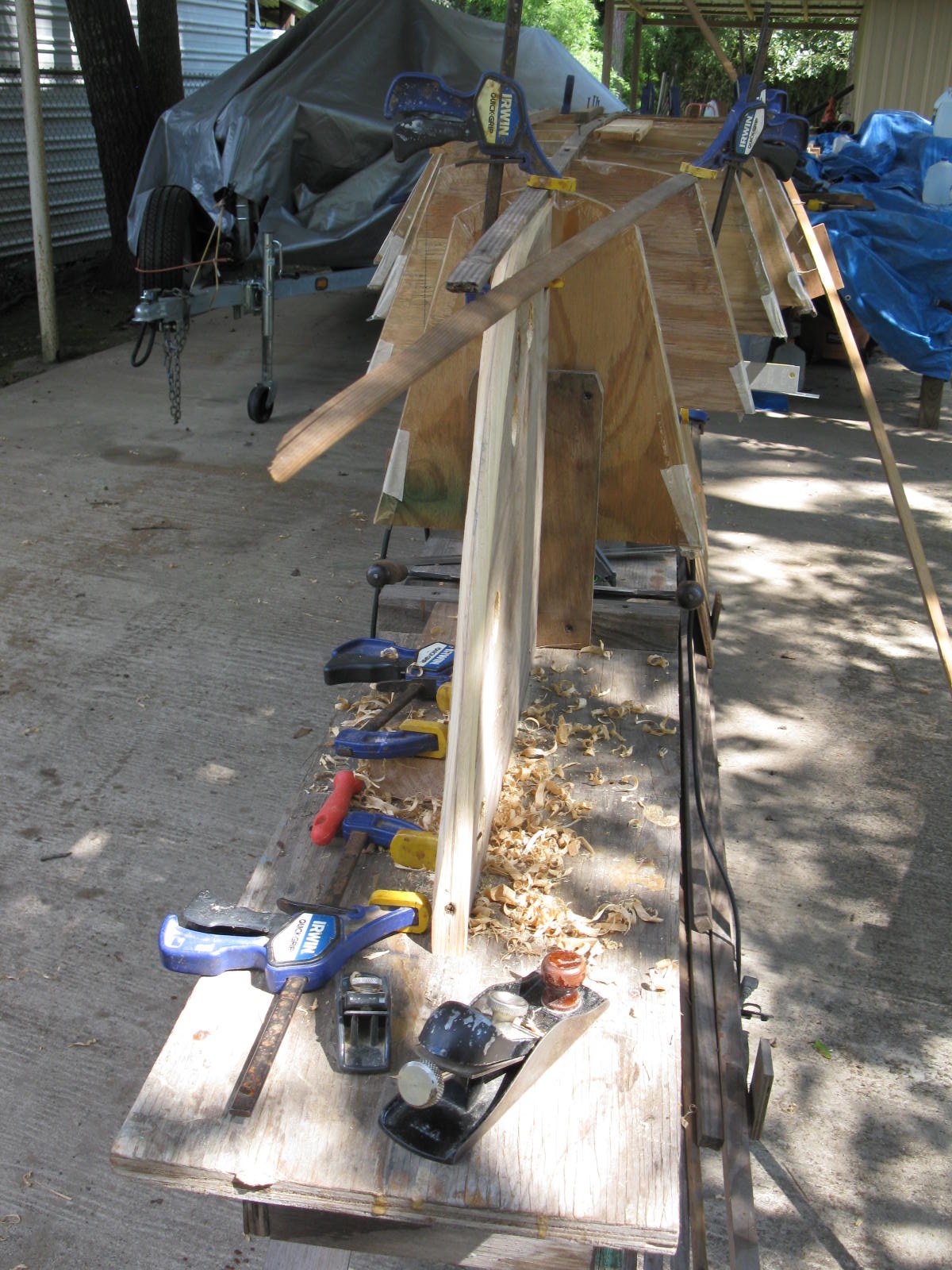

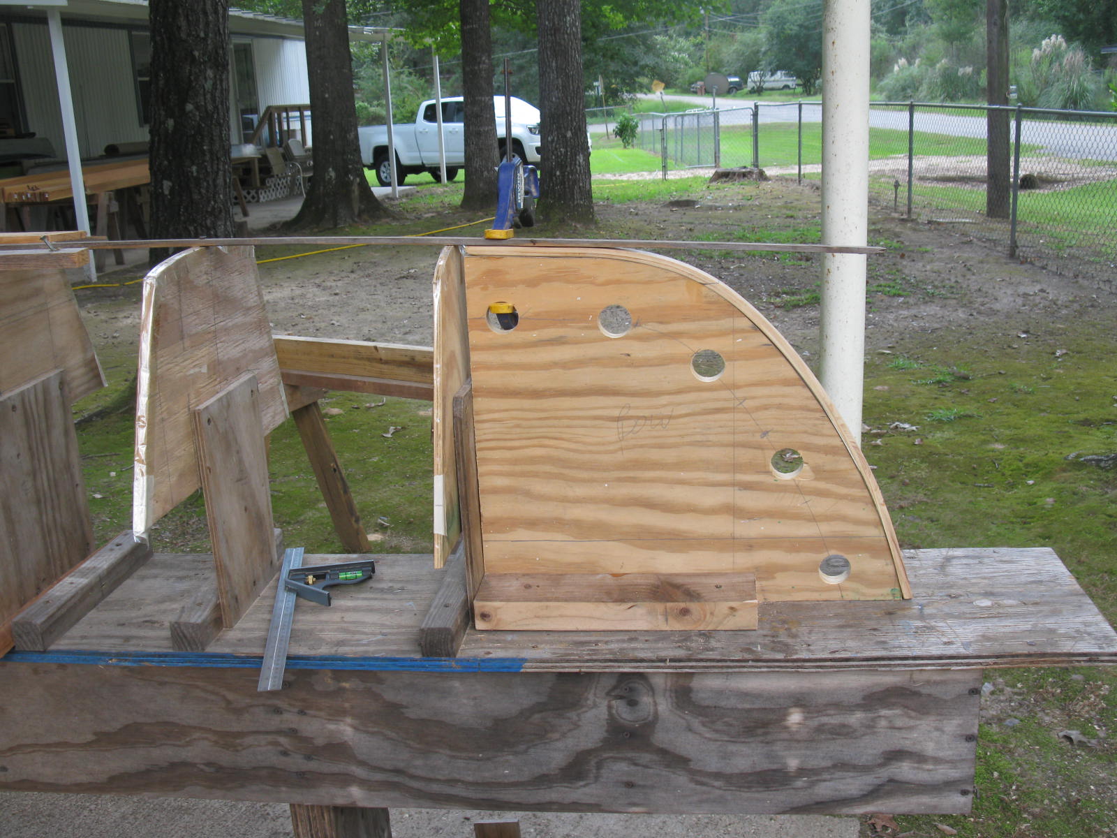

I like the shape. Your idea of stitching the ends and pouring epoxy in the stems will probably work better than making wooden stem pieces.
I did these for a strip build that had ends shaped similar to yours.
Make a plywood form and laminate strips around it.
Plane the stem angles to mach the sides.

I agree. Your idea seems easier. Not sure how the chine logs will meet.
It might be interesting to place the cardboard template onto a 2"X4" and see if a stem could be made. Even if it takes a wider board the waste wood could be cut away. Might be easier than you think.
Bee, there is really no need for a stem piece. The Swamper was built stitch and glue with a very similar approach at the junction of the bow and bottom. The bow will get pulled together with epoxy and cloth. From there on back, the chines will take over the side/bottom joint. I could probably get away with ending the chines 3"-6" away from the bow joint. The cloth will overlap that joint somewhat and will actually be stronger than either the chine or the stitch and glue construction.
I've never seen this done, that's why I call it a hybrid build.

In your picture of the side panel and the cardboard template, how tall/wide is the plywood and how much is the cut back at the chine/bottom?
Initially, from the center to the ends of the full length plywood sheet, it was 3.5". The height at the bow is approx 12.5". With all the straightening I had to do, all that changed some fraction of an inch. By the time I fair out the chine curve, it will have about a 3.25" reverse curve. The sides should come out a bit better than 9" high.......plenty enough for me. All those little changes don't bother me one hoot. It WILL come out to be a nicely curved, good handling, good paddling boat.
Think about this. Only traditional wooden boats that use glue and fasteners have stems. Stitch and glue wood boats, fiberglass boats and welded metal boats don't use stems because the sides can be glued/welded to each other. I could definitely do it, but I don't see any need or advantage.
