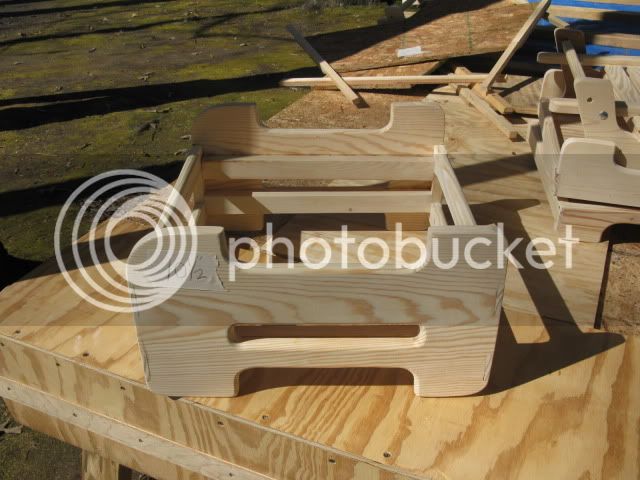

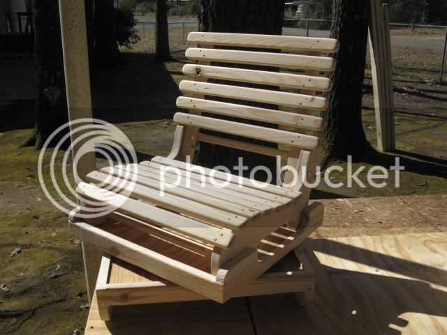

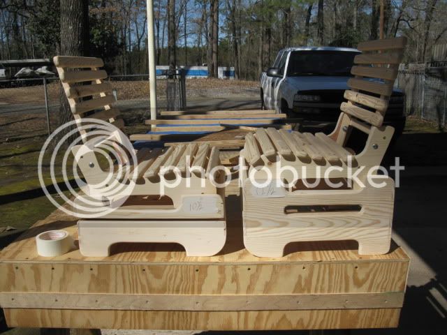

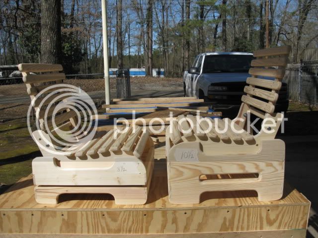

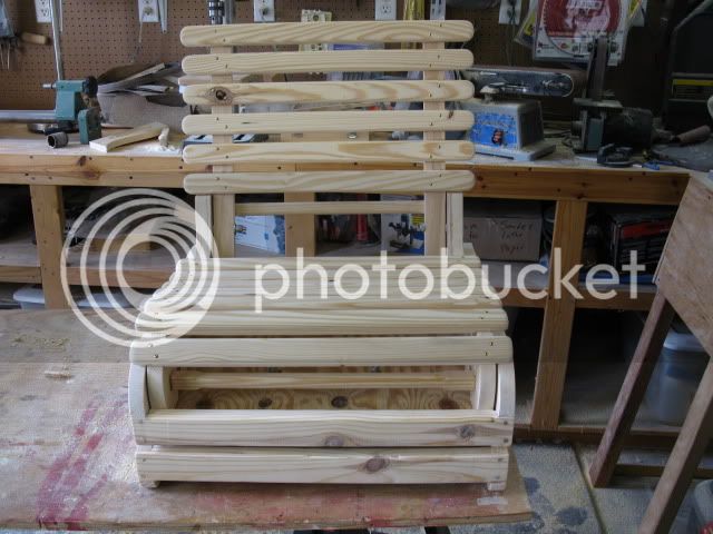

.......Have the one , all I need to do is like beekeeper did and make a base to set it in to raise it to the 8 inches that is recommended for the seat height.
IF.... It is needed since the Skiff and the Pirogue both have 12 inch side boards , the skiff is only wider. Have to get it complemented to find out.
Then make another in case someone goes with me. :D

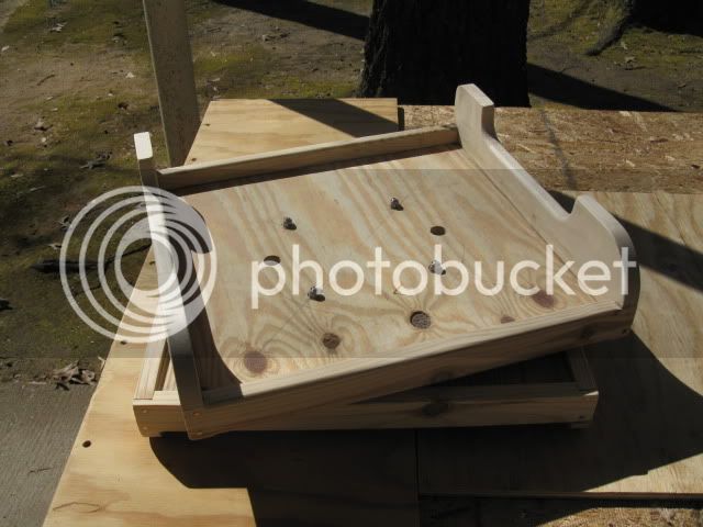

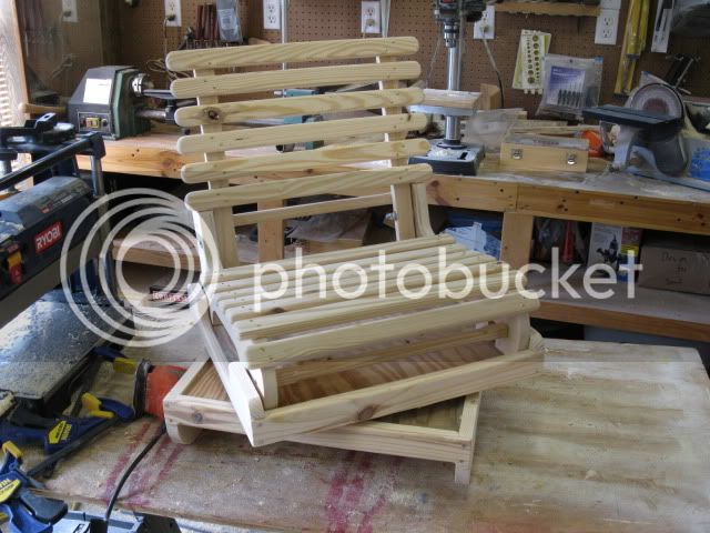

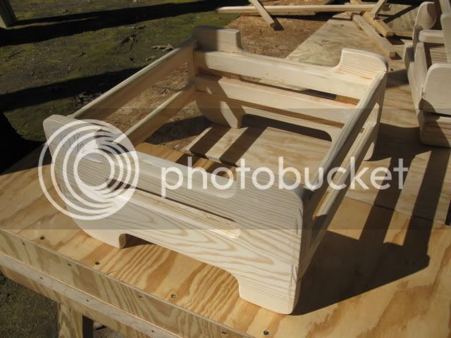

If you have not decided on how to do the seats here are a couple more ideas:
A swivel base to place your pirogue seat:
The swivel base will raise the seat 8.5" or 10.5".
This base will raise the seat 10.5" or 12.5". It could be made to swivel as well:
I have not had a chance to try either, but it could be a starting point for you.

The seats are beekeepers handicraft and I do like the idea of the swivel base , would drill a drain hole in the flat part in case of rain. This way the water would not back up and get into the bearings in the swivel portion.
