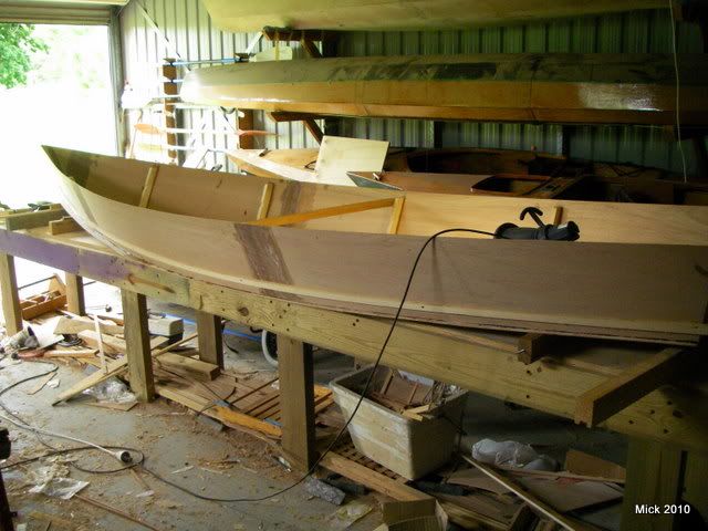

Been drooling over Chuck's skiff build for far too long. Time to make my own!
Mine will be a lil different to Chucks and probably not as pretty.

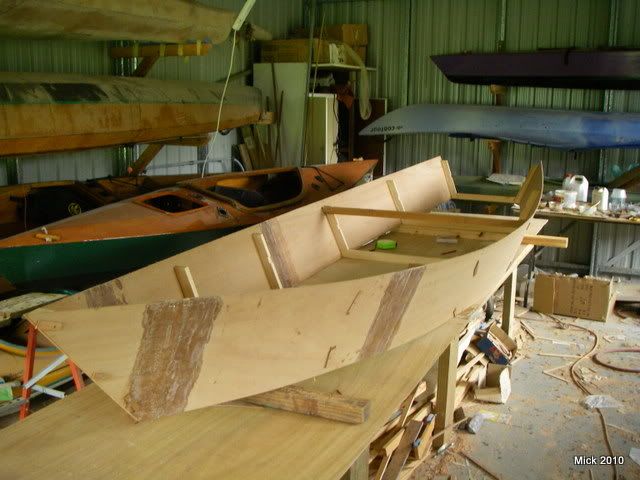

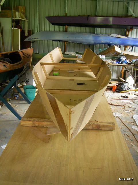

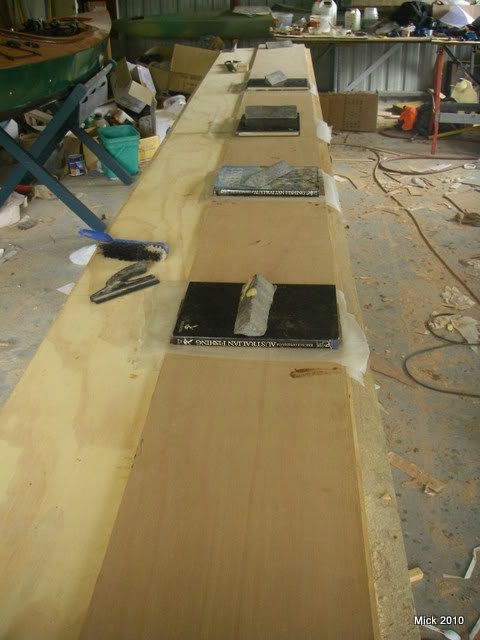

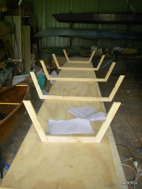

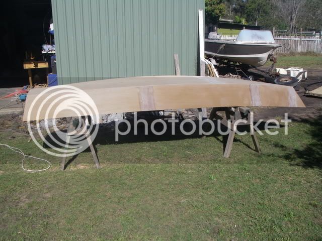

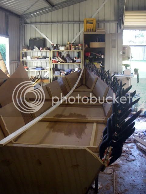

Got the ribs made.

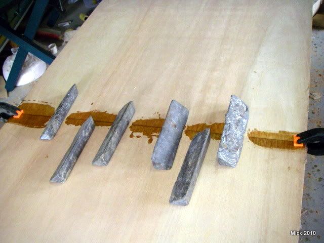

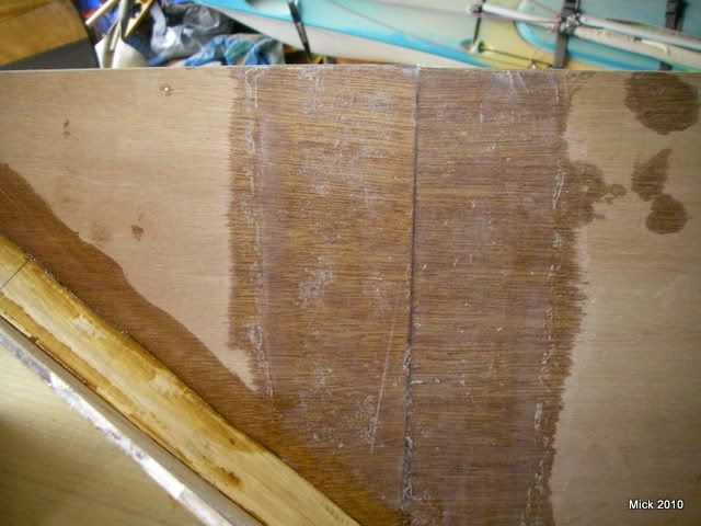

All the panels are rough cut and side panel splices are started. I had a broken sheet of BS1088 that I was wonering what to do with. With the straight sides on this boat I was able to use up most of it and an offcut of Okoume was enough for the sides. there are just a few more panel splices. Am using a cheaper ply for the bottom. It is the packing sheets that my BS1088 came in and is surprisingly good looking stuff.
My ply for this one is 4mm thick and am aiming for a boat that I can load onto the roof of my car on my own.
