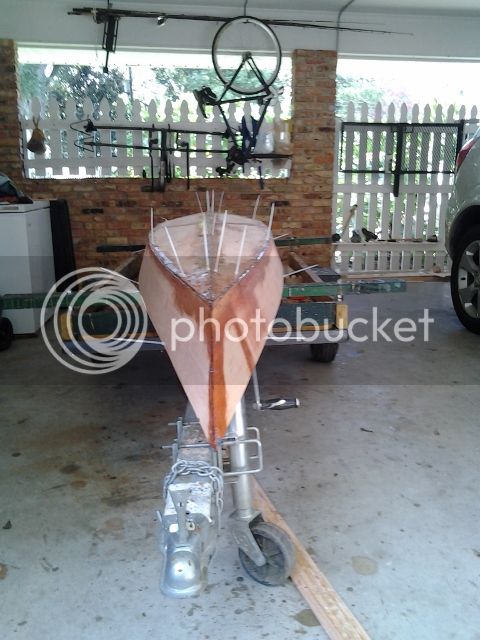

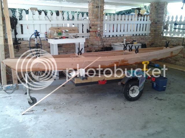

It will be some time before the tumblehomes go through the planer and are ready to install. The hull was true and the lines straight, so I put the epoxy to it. 1 coat of epoxy on the seams, let it harden, and then epoxy/wood flour out of the ketchup squeeze bottle. 2 3 ounce batches of the fillet. The hull is now 6 ounces heavier.

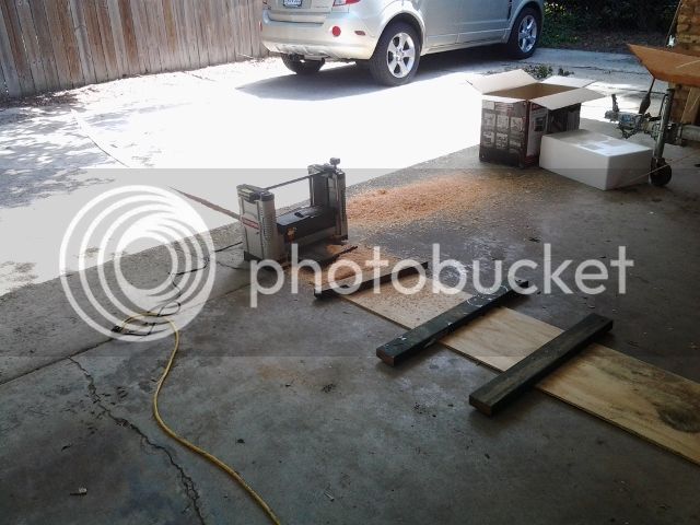

I picked up the planer from Sears this morning and began to play. When I was brave enough, I started working the 2 tumblehome panels.
This thing is great. 30 min. later, another big pile of sawdust, and the panels were uniform at .210". A little final layout and they slipped onto the boat.
Thanks guys, this has been a great thread for me. You have taken me through cutting strips, gluing strips, and finishing strips for small boat building. All has been successful and the final product will be a beautiful boat.

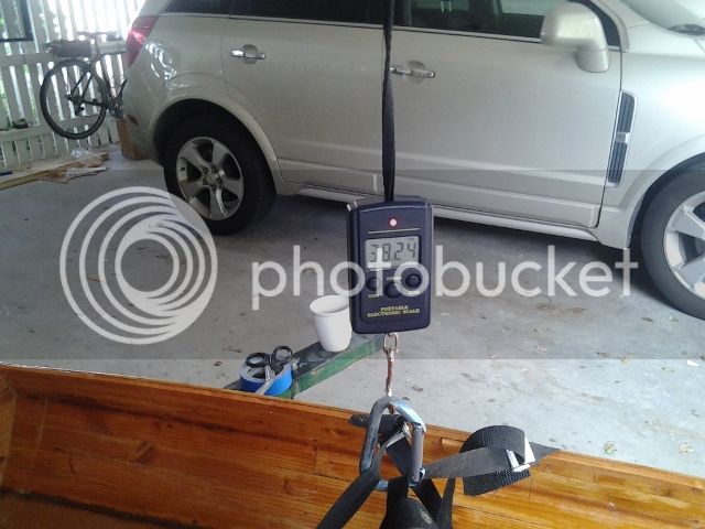

Hey Guys, another question. This boat came in at 38 lbs. with 6 oz. glass inside and out, about 1.8 gallons of epoxy/resin, and (after planeing) strips at .21". I was planning (hoping) for low 30's. Where will the best weight savings be? 4 oz. glass will only save 2.5 lbs.. I don't think any of the epoxy on the boat is wasted. How thin can I plane the strips and still build a solid hull?
Thanks
Dan
Thinner wood makes a lighter boat.
My 1st Pirogue was at 50 pounds with 1/4 inch wood , I figured it could be lighter so I went with 1/8th inch wood on the 2nd one and the pirogue was 32 pounds ( the seat weighed 2 pounds ) , both boats were 15 1/2 feet.
The 14 canoe ( Sasquatch from Jem Watercraft ) weighs 30 pounds and that is with a 2 pound canoe seat. It was made with 1/8th inch wood and the canoe is glass encapsulated.
The 17 1/2 foot kayak ( Pygmy Coho ) came out at 40 pounds and again is with 1/8th inch wood.
I epoxy saturated the wood and glassed it on both sides of each boat. The epoxy saturation helps to strengthen the wood along with the glass later on. You can't use them as battering rams but they are really stronger then you would expect for such thin wood. One canoe ( A Selway-Fisher Peterborough ) took a beating on some rapids and I was sure it had had it but it was not damaged and continued down the Buffalo River. Later on when checking it there were nothing more then some scratches on the bottom of it.
