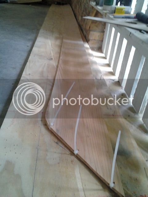

The side panel are complete. I tried the scraper, sharpened the scraper, dulled the scraper. Tried a heat gun with the scraper. All gave some success, but not moving fast enough for me. I got out my belt sander and 60 grit belts and went to work. 2 hours later, both sides of each panel are clean level wood. I will finish the tumblehomes the same way for this boat, but there was a whole lot of sweat and elbow grease invested in getting these panels clean. I think the next boat will come after I find me a 10" thickness planer.

I can't tell by the pictures, but were you able to bend the 1.5" strips to follow the curve of the panel or did you build a panel and then cut the curve? The wood looks pretty. Are going to paint or natural finish?

That is a sharp looking tool Beekeeper. I will get me one of those. On the top side of each of the panels, after 24 hours, the glue was hard as a rock, but on the bottom, next to the plastic when I flipped them over, it was still gooey. I am not sure what triggers this stuff to harden, but it wasn't getting it next to the plastic. So I dealt with different problems at different times.
The wood strips are 1 1/2" and were easily bent to match the top contour of the panel. This was a deflection of 1 3/4".from center line to end 7'. The tumblehome bend will be a deflection of 6 1/4" in the same distance. I played with 1 1/4' strips for this bend and it looks like this will be a firm bend but will work.

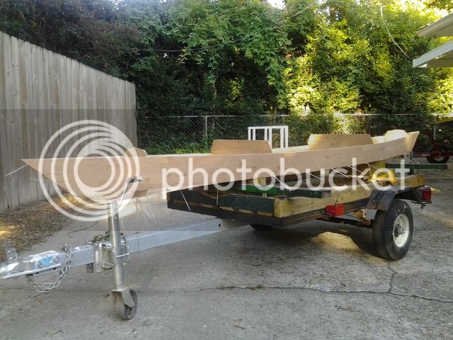

Everything seems to be fitting together real well. Would you guys fit the tumblehome at this stage or wait till the bottom is finished first. I can't decide if the tumblehome is part of the hull or the top.
Install the tublehome now.
