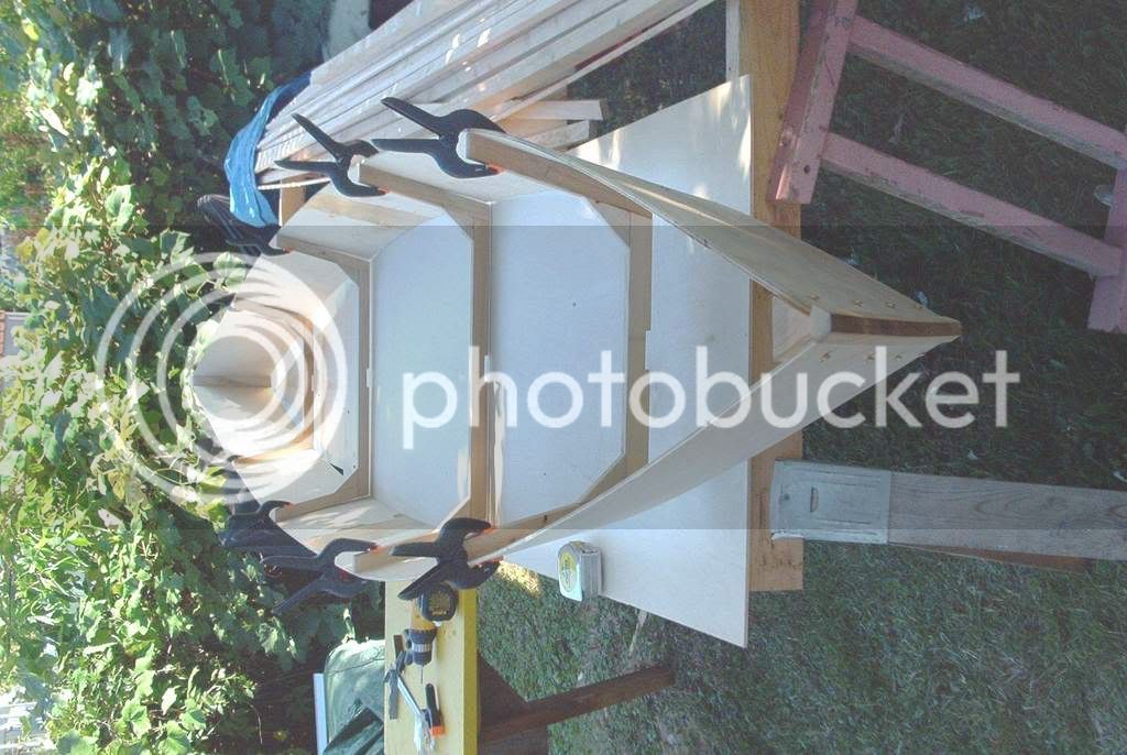

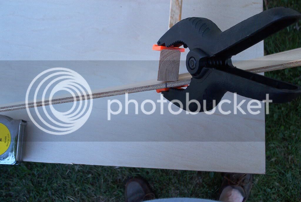

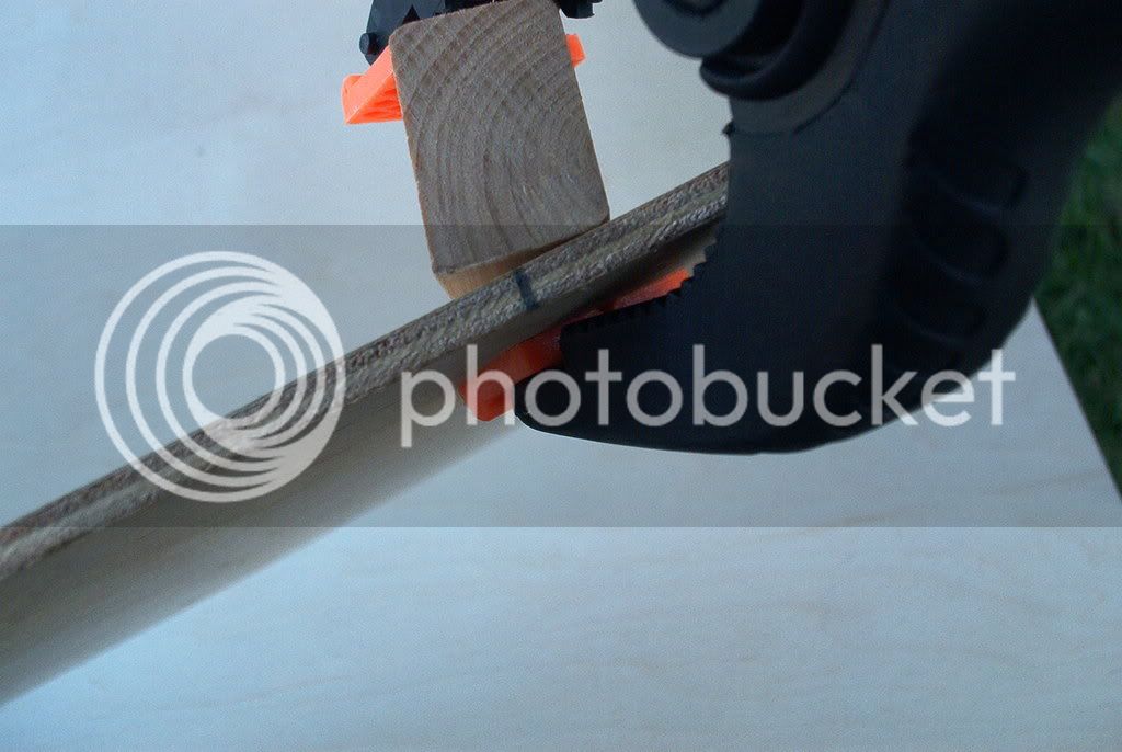

Hello Everyone:
I got back from Atlanta yesterday and decided to spend the day(Sunday) wo*king on my piro. But, I have a small problem with the end ribs matching the curve of the sides. See photos. The angle of the rib doesn't match the sides curve. This angle is machined in by UJ and I assume since I cut a bit of the length, that is the reason it doesn't match. I assume I can just fill in the gap with some wood flour and resin mix and then clamp everything until the resin sets. And of course, everyone knows what happens when you assume!
So, is the flour and resin the right way to go?

get your little block plane out and knock off the edge of the rib that's touching the side until the rib is flat.

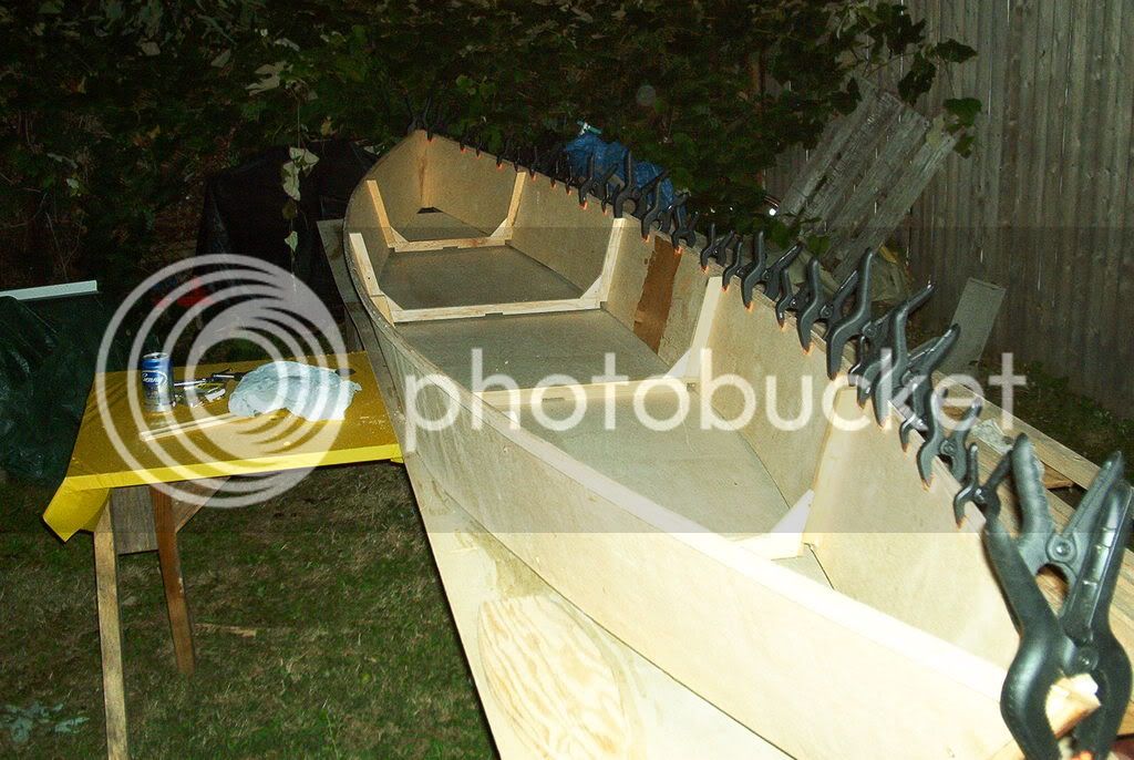

Thanks Keith & Seedtick for your suggestion on the block plane, but I ended up cutting the new angle on the table saw. I can operate that better than a plane. I inherited a whole storage shed full of woodworking tools and included in that was two table saws, a band saw, router and table, 2 table mounted jigsaws, bench sander plus a whole bunch of power hand tools. There is a wood lathe still in pieces that I will put together over the winter. Shoot, there are some attachments that I don't even know what they are for!
Anyway, the table saw worked great and I glued the ribs in along with the gunwales. See photo. Tomorrow, I am going to put the inside chines in and put the bottom on. That will be all I will have time for this week because on Wednesday, I am going to Birmingham AL and will not be back until Sat morning.
The good news is it's beginning to look like a piro and I am getting anxious to finish it and get it in the water. I wonder if I am catching this boat building disease!?
OK, now for a question, I thought about putting the bottom on in two pieces, instead of butt splicing on a workbench, why not butt splice right on the frame of the piro? I have an inside chine to help support the plywood and I was planning on tacking along both sides and then glassing the butt joint when it is in place on the bottom. I thought I saw somewhere in one of these threads where someone did it this way or at least, discussed it, but I can't find it. Any pitfalls to this idea? Pros or cons, anyone?
