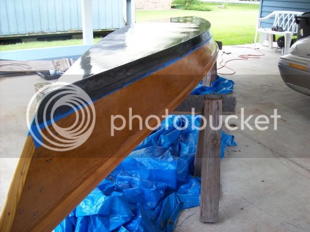

Just put on the first epoxy/graphite coat. I got good coverage- very little wood showing through. One more coat tommorow. What's a good rule of thumb to remove the masking tape( I'm using the slow hardener)? Any idea how long it has to cure before I can put it in the water?
I remove mine after the last application starts to set up , about 45 minutes to an hour. It appears to me that as you do more applications of it , those tend to soften up the previous ones so pulling the tape is not a problem....
NOW... I do not get a lot on the tape when doing it. When everything is done let the boat rest for about a week , it will take up to 30 days for the mix to compleatley cure but after a week it can be paddled.

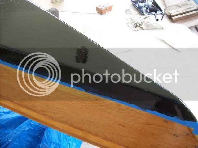

Put the final graphite coat on this morning. It slicked up the bottom pretty well.
Going back out to check for runs.
