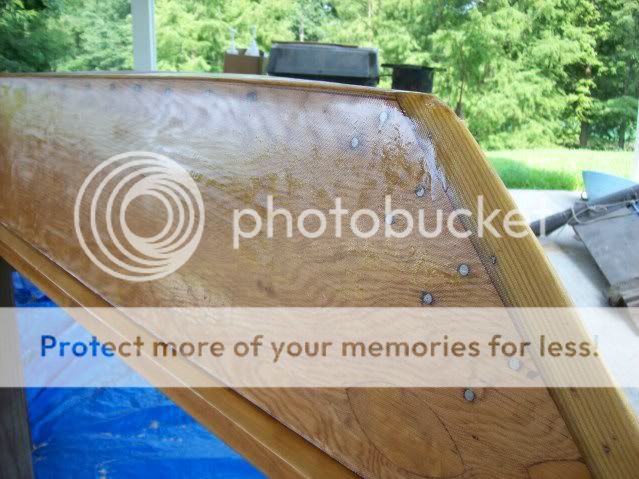

Having done this only once I tried to do what I *think* you're talking about. I tried to do the bottom with one piece with excess past the gunwales. I have rub rails which pushed the fabric off the sides to about 1.5" to 2" from the rub rails. I was able to get it much closer to the bottom of the rub rails cutting it more to size.
This is how I was originally going to do it.
It was cut closer that the picture shows. After seeing how it pulled away I stopped, got my scissors and cut it to right beneath the rub rail.

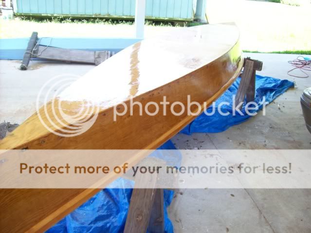

Not near as bad as I thought. It took one hour and twenty minutes. Just got finished trimming the cloth and touching up the gunwales. I figure one fill coat and then a couple of graphite/epoxy coats. It's a kick watching that glass disappear when you spread that epoxy over it. 8)
A couple of pics.
I trust you ran a little epoxy along the cut line at the sides and rail.
Just for safety's sake to stop any water from getting into the cut .... Ya know like a Band aid on a cut finger. :D
I like the nail heads showing they make a person think it was made the old fashion way , adds some character to it.

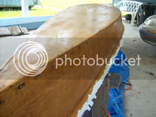

Applied filler coat this morning. It filled in about 95% of the weave. You can really see all the little flaws with that glossy surface. The only problems I had was the tiny little raised areas where the cloth was creased. Not really enough to bother with. Next comes the graphite.
So far so good, Chuck. No hazy areas so far. I probably sanded away half of the top veneer on the ply to get down to clean wood. In a couple of bad spots, I had to go down into the second layer of veneer. Had a couple of run-ins with some cypress knees and painted over the sore spots. I had to get down past that. That's why I'm thinking about painting a name or picture on that side - to hide the bad spots. We'll see.
