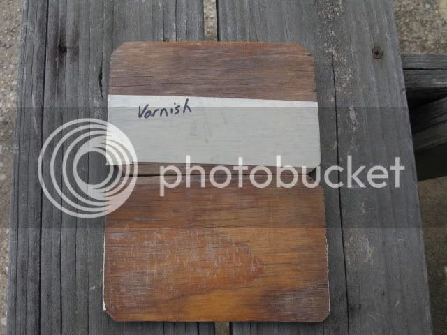

I hung the pieces on string outside for 2yrs. My observations now are:
1. Varnish only looks the worse. Weather checked and may be mildewed under the finish.

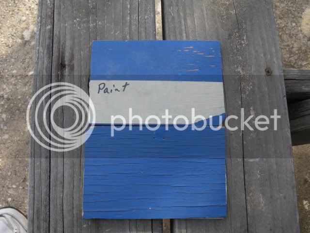

2. Paint only is peeling and would need redoing.

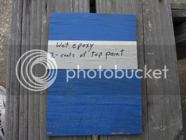

3. Wet epoxy with top coat of paint has less peeling but some checking.

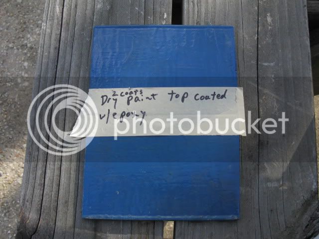

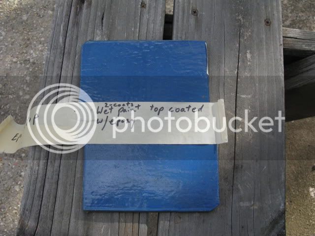

4. Wet paint or dry paint with epoxy top coat looks good.
These pieces did have another top coat of varnish for U.V. protection

Are any of these practical or worthwhile? Maybe. Epoxy and varnish over paint held up better than just paint with top coat of varnish, or pieces with just varnish. They seemed to stop the checking(pine BC plywood). They were also smoother. The paint over wet epoxy showed the scratches the least.
One point is clear to me. Wet epoxy and latex paint will bond together better than paint over dried epoxy.

Wet paint and wet epoxy will mix, and may offer a better finish than paint over dry epoxy, varnish only, or just paint.

Scratches in paint over wet epoxy did not show as much as in other combinations. I think because it was not as shiny. It weather checked more than epoxy over paint.
