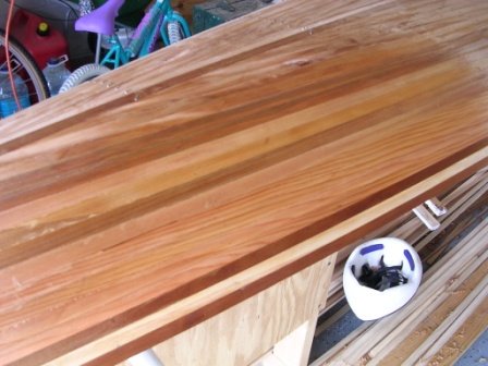

Here's a couple more pics of a cypress deck
Sorry for the glare but you get the idea of what it looks like. Islandpiper over in Ponchatoula may know what the lumber mill there has available. Don't know where in Texas youcan find it. But you are correct, you don't want the reclaimed material that has nail holes. Also avoid the newer growth (growback) cypress as it doesn't have the insect and water resistant properties of the old stuff. Old growth cypress will have 30 or more growth rings per inch
