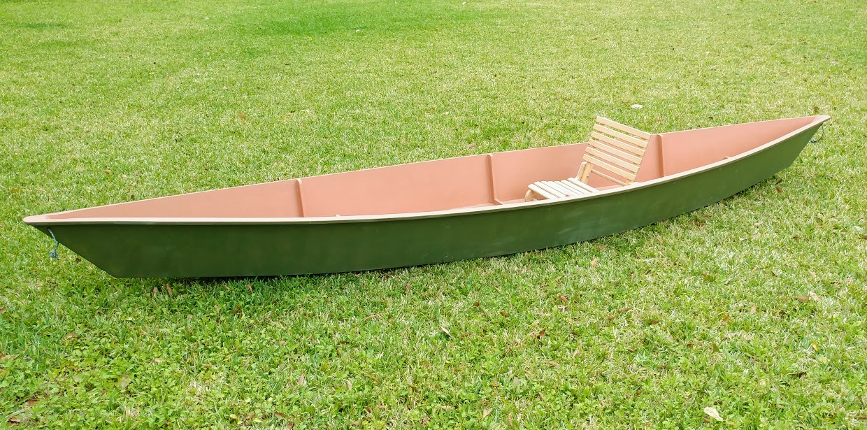

One more picture with the seat in...
1559
I plan to get her wet Monday. The paint should be good and hard by then and the weather forecast is good.
